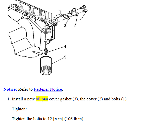

Correction on the torque spec: It's 106 inch pounds.
New gasket design is all metal, like a crush washer.
If you have an oil cooler, get the one with 2 circles. If you have the blockoff plate, get the one with the big oval
RTV is neither required nor desired for this. Just ensure that the mating surfaces are flat and smooth. You can take a fresh razor blade and gently scrape away any residue to prep the surfaces. I don't like to use a whizzy wheel on anything that's a machined fit as it can change clearances just enough that the thing doesn't seal up right. If you really are having trouble cleaning it, some sand paper adhered to glass will give a good surface to lap it on. Don't go any higher than 300 grit - you want a bit of surface roughness.

Thanks for the torque spec update, Chris!
I had been reading 80 in-lbs when I originally changed mine --> I suppose this was the original torque spec for the o ring style gasket and not the new crush style?
Not sure. This one's right out of the service manual and what I used for mine. No leaks and I have the metal gasket
