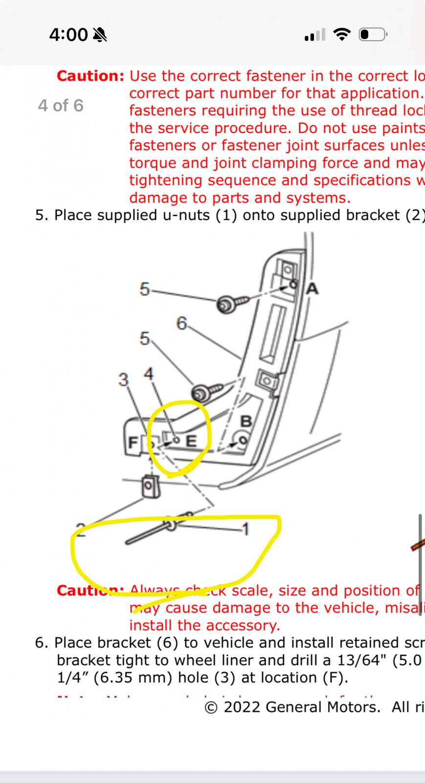

The rear oem splash guards for my 2024 Yukon come with a rivet (wtf?) for each one and, from what I’m reading, it goes through the fabric wheel well liner. What purpose does this serve given that there are screws already?
Anyone install these and not use the rivet? What a pain… lol.
See pic attached with rivet and insert location circled in yellow.

B-train
Sep 12, 2022
2,711
4,920
I'd probably just go with a friction push pin. That way you can remove easier down the road if needed. Or put in a small stainless screw and nut

Yeah exactly… just seems odd… a rivet? Lol

A rivet wouldn't use a very big hole you should be able to use a screw instead.

Yeah, just wondering why a rivet is even part of GMC’s instructions? Just to make it more likely you’ll use the dealer for install? lol

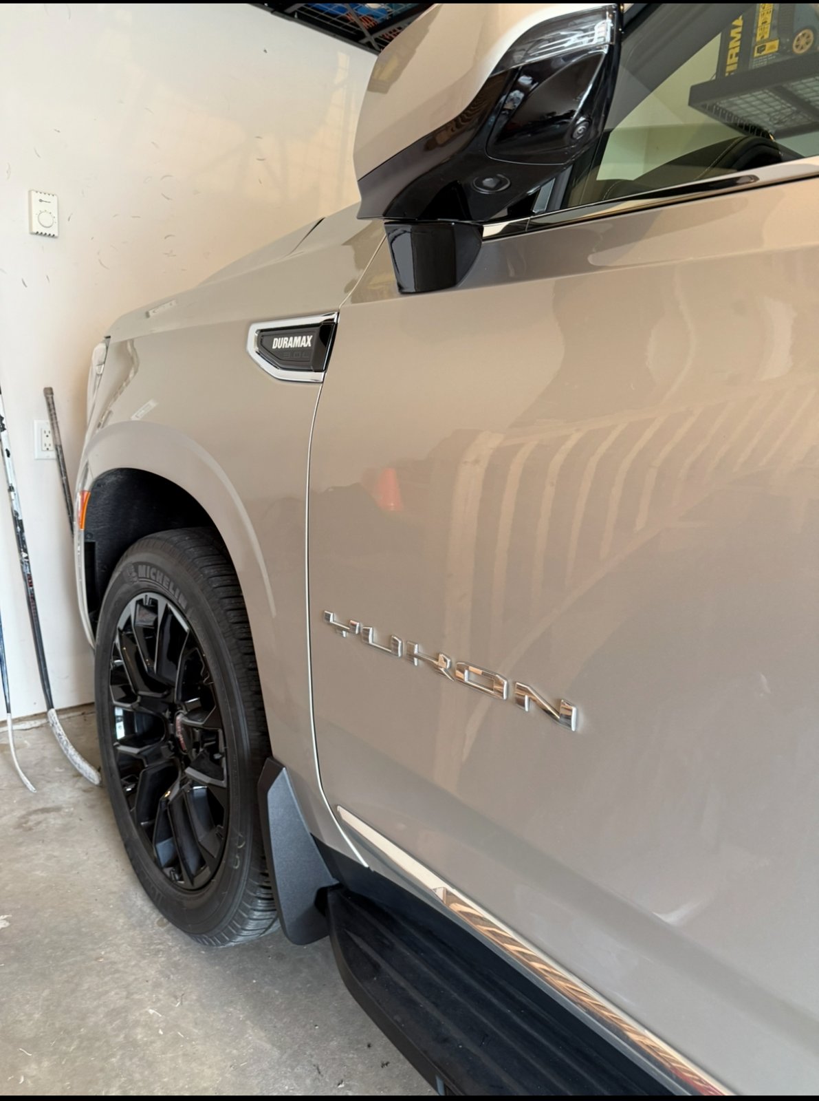

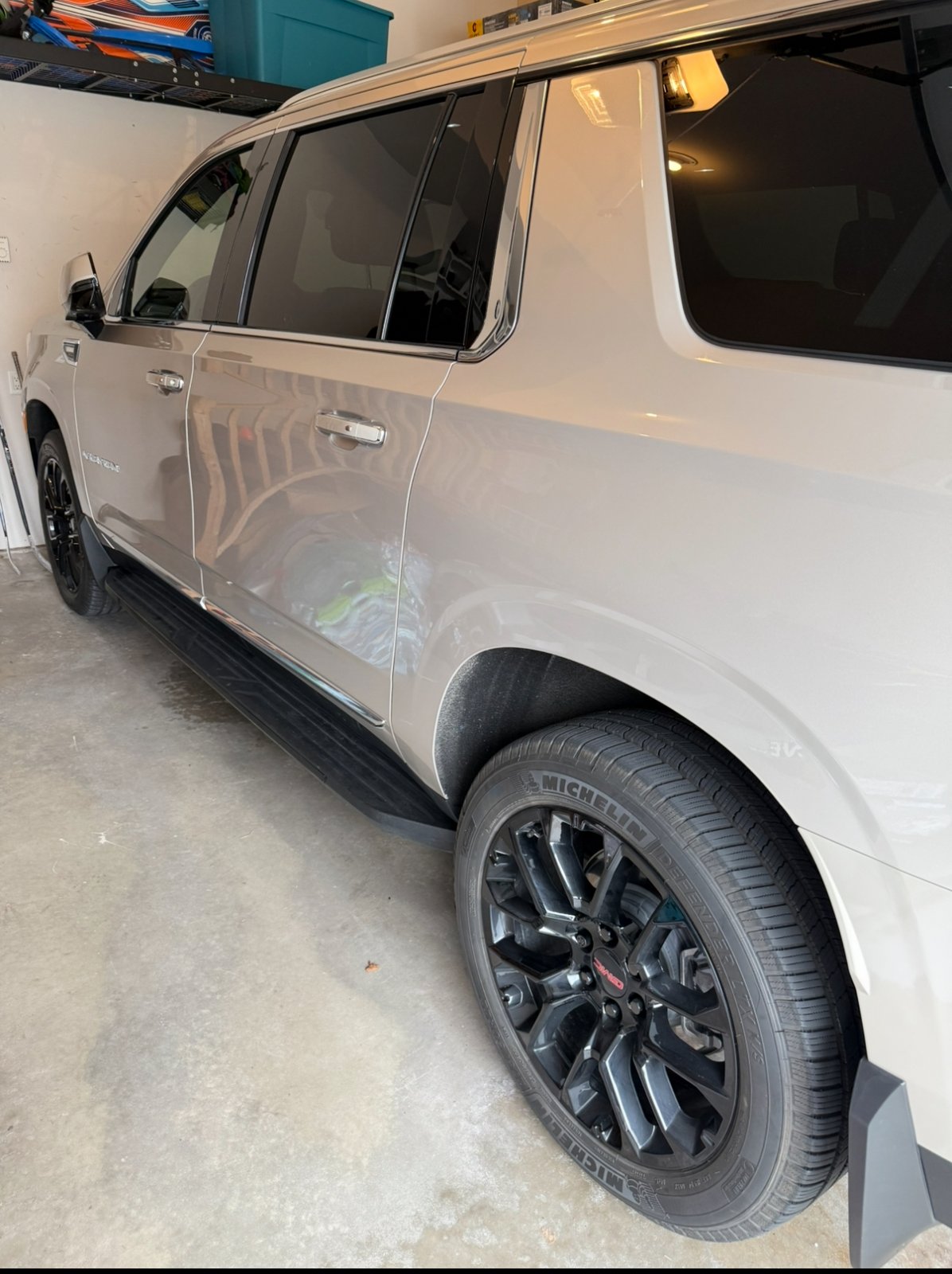

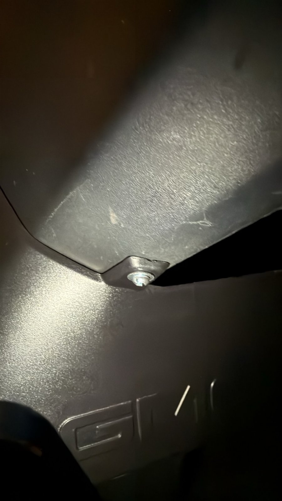

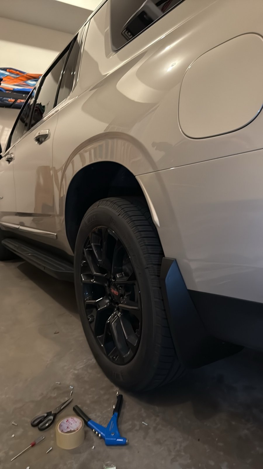

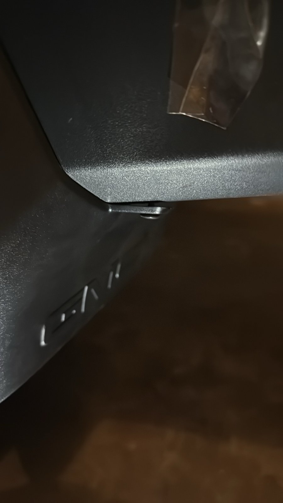

Well started it late tonight. Installing the rear guards is a complete pain in the a$$ with the tires on. Instead of a rivet thru the wheel well liner, I just used an 8mm screw with washers on bother sides and a nut on the end.
I also had to do the same for the lower fascia screw as the 13/64” pre-drill hole is too big and doesn’t leave enough meat for the supplied screw to catch. I’ll dab a little black rustoleum on the screw to blend it in a bit better.

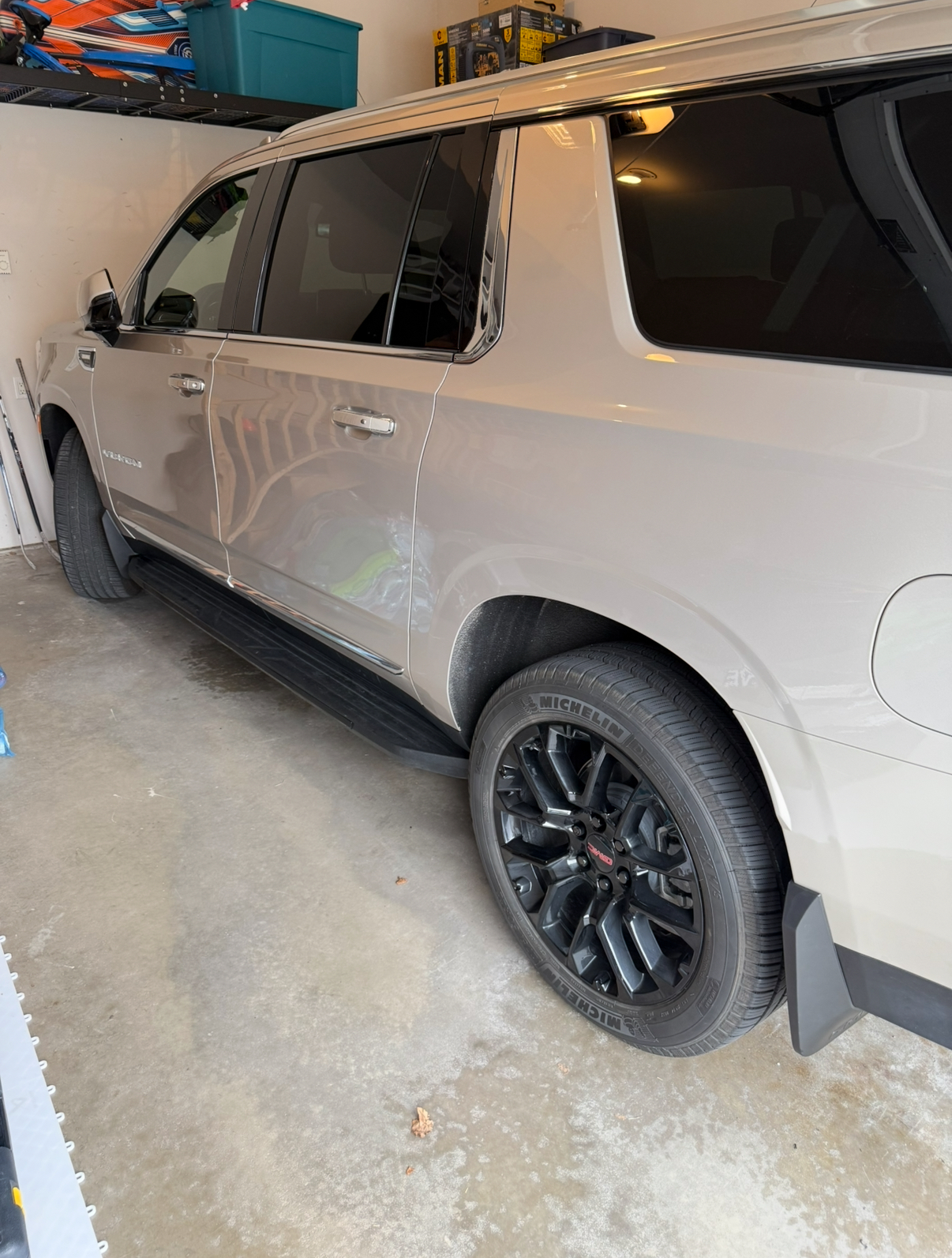

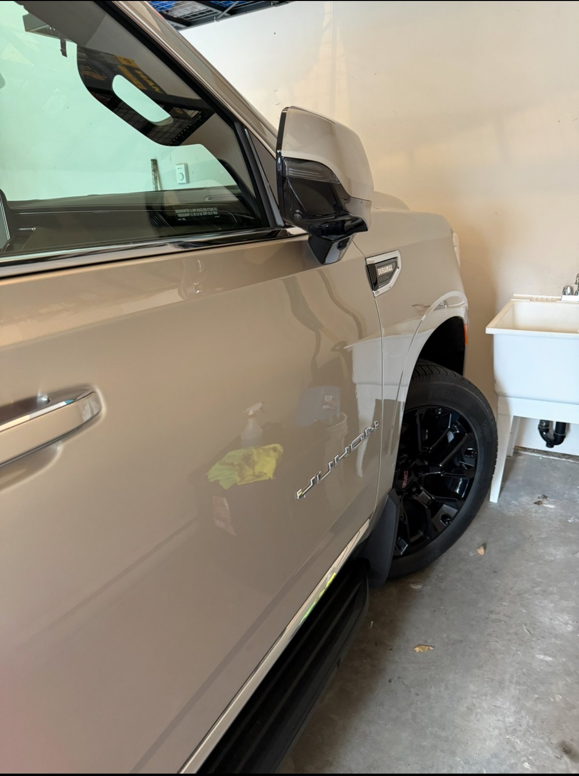

Yeah they were a pain but I do like the look. If I had to do it all over again.. I would have went with the weather techs. Not worth my time to do this.

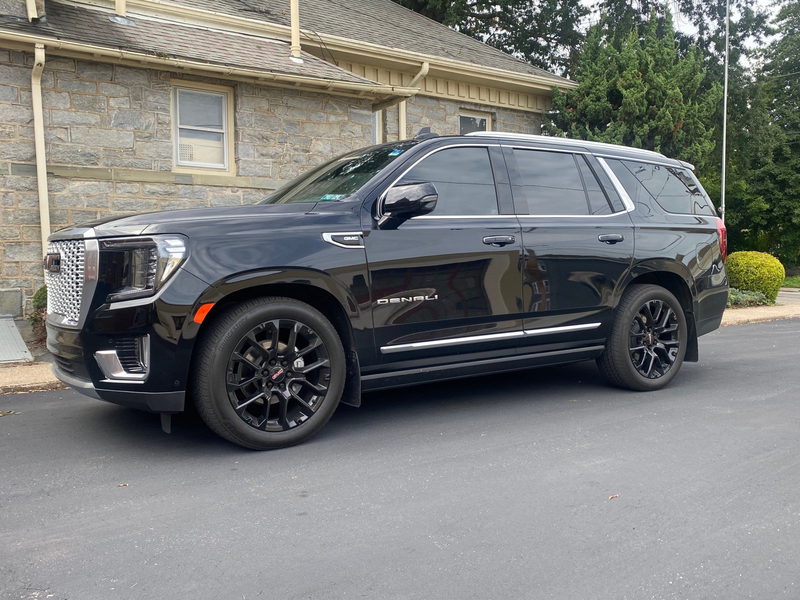

Would you be willing to post some pictures of your WT mudflaps installed? I just purchased a 26 Tahoe with power running boards and I'm looking for options.
KMeloney
May 2, 2009
3,476
721

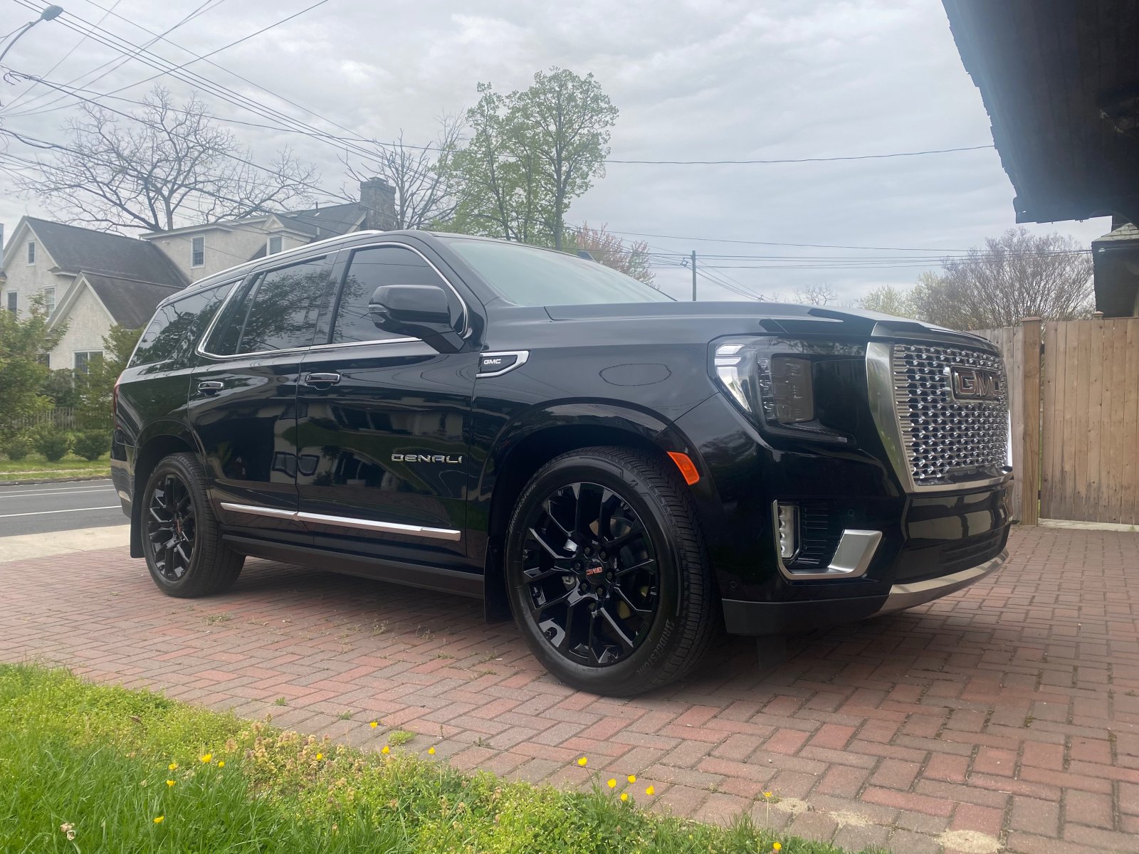

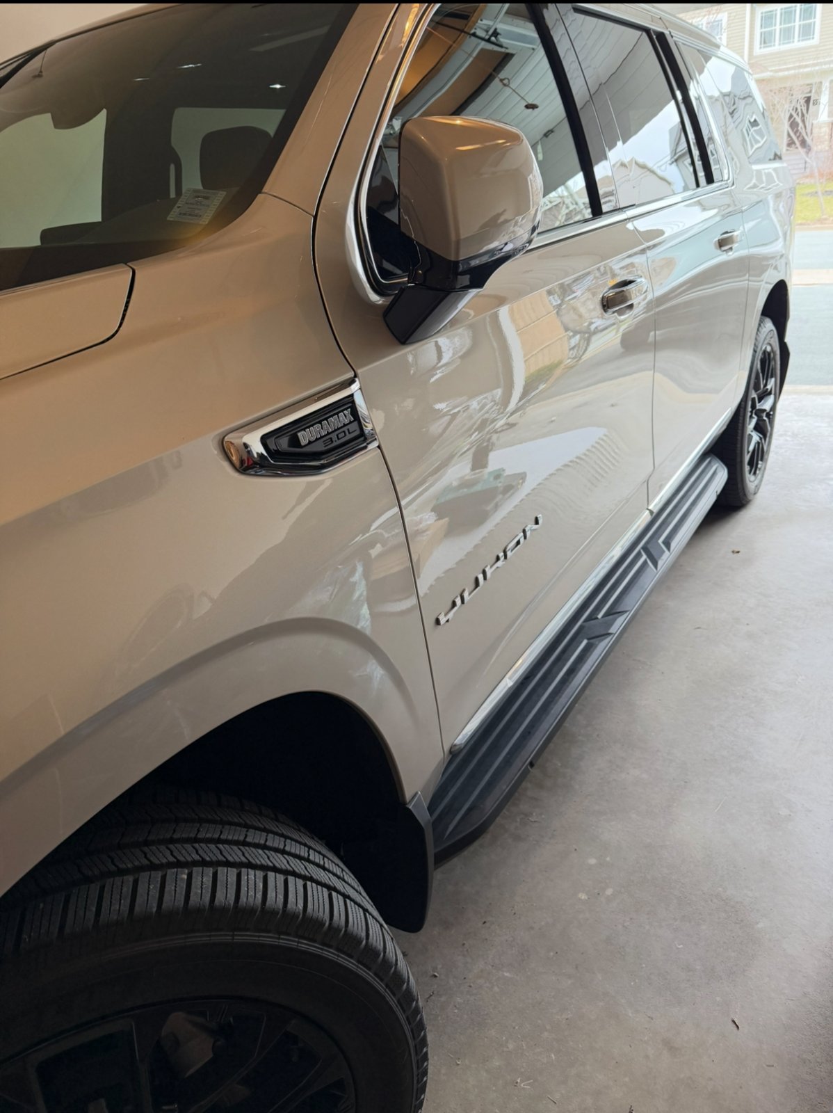

Here's my truck with the WT flaps. Not the best pic... But I'll find another and post it.

Well, I’m upgrading my ‘24 Yukon XL SLT to a ‘26 Yukon XL Denali. Fixed boards. Picking it up end of this week. OEM guards or the Weather tech….decisions decisions lol. I think I still have ptsd from this install but I like the look. Also knowing I can use a screw above and get a slim profile ratchet should make it much quicker than what I endured last time. I also still have that stupid rivet gun. Shouldn’t have to do as much running around for tools this time
