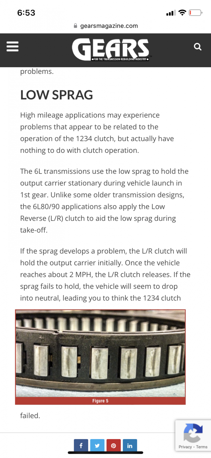

Look up low sprag failure, often overlooked in rebuilds-Andrew DD77AC07-098A-471D-848F-5BB072EC02E4.png

All you need is a few couple thousandths gashes and your transmission will act horrible , in fact it may have been the reason for the failure in the first place but new clutches/other parts made it grab enough to drive.

Only other thing mechanically besides lower sprag is L/R clutches but unless it’s a ghetto shop they should’ve done them too
