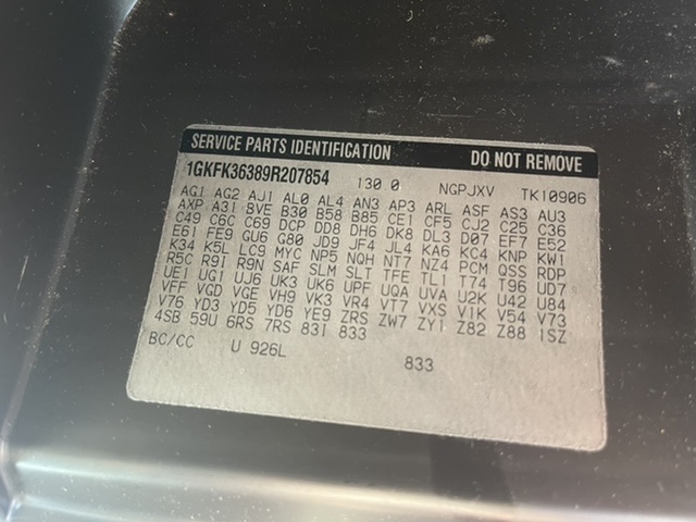

Hey, I’ve got a 2009 Yukon XL 4wd SLT.
I need to replace the shocks and struts. I’m getting so confused as to which ones I need and what to go with. I was leaning toward KYB monotubes, to get more stability as a whole…
Any input or feedback would be appreciated.

Your ZW7 (premium ride), 6RS, & 7RS are your suspension codes.
I recommend going to Rock Auto and find the front struts and rear shocks for those codes. I prefer Arnott or OEM.
Thank you! It’s confusing to sort all this out.
I just want to get this thing smoothed out again…
