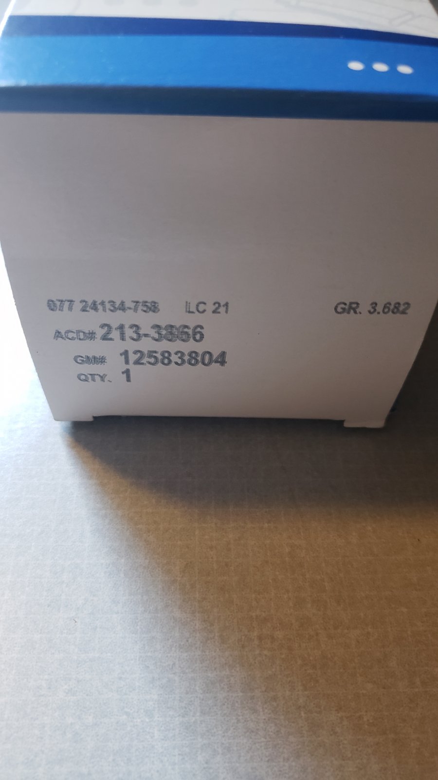

Both numbers on the same box or bag.

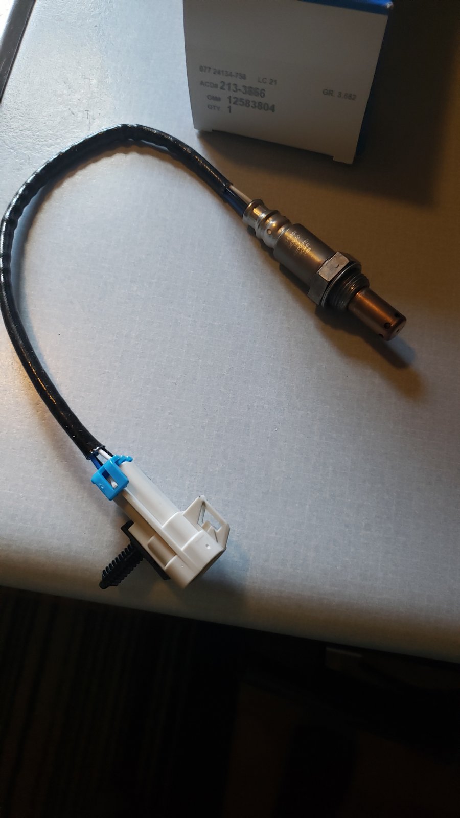

I ordered a set and received them today. They arrived in boxes and I was surprised they weren't wrapped inside the box or even have the plastic cap over the sensor and antisieze coated threads.

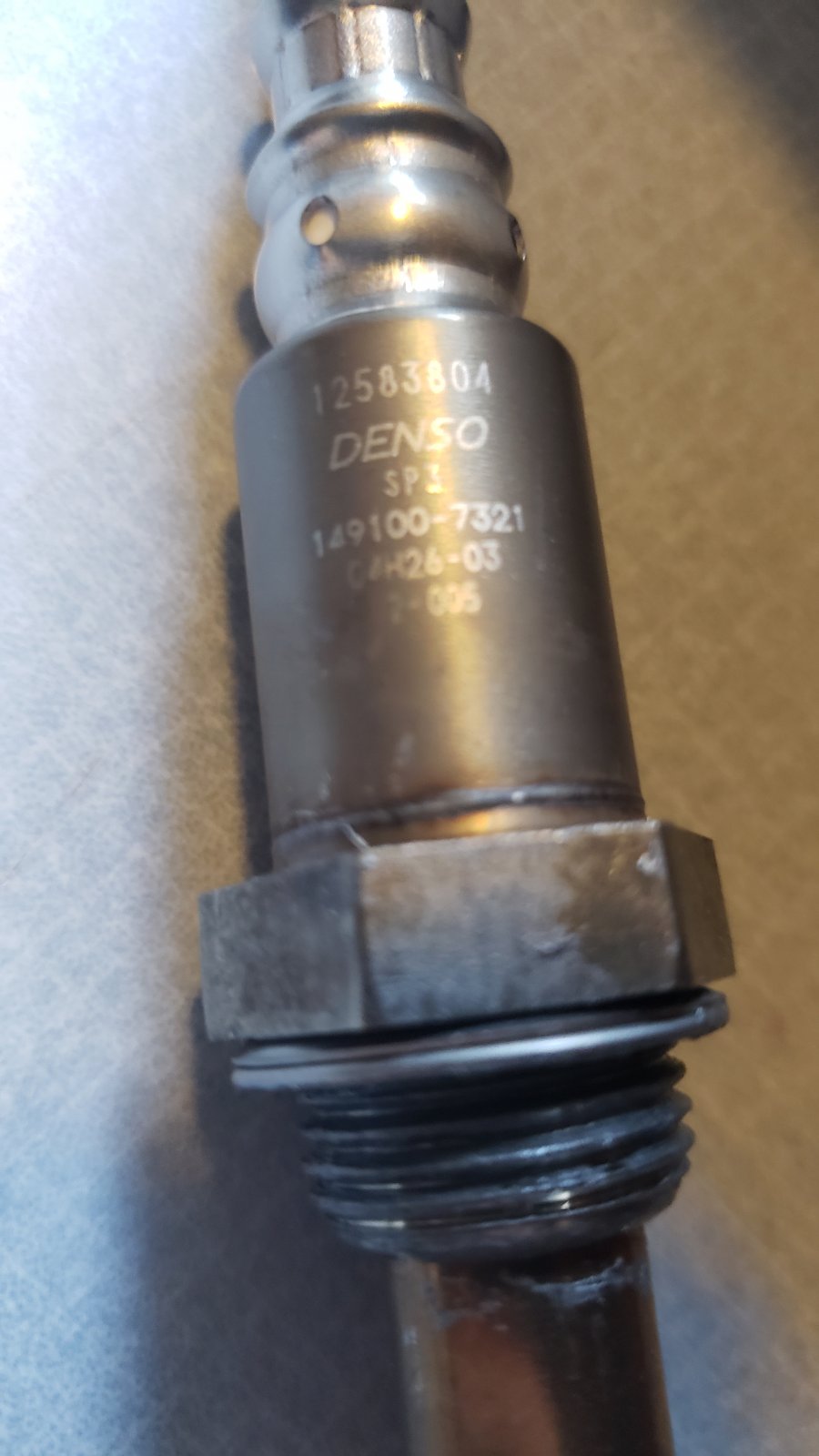

When I was looking up these sensors, I found the 2133866 numbered ones for $35 each, and the 12583804 numbered ones for $53 each. That's why I was asking if there was a difference between the two.
21,321
30,318
Only the price! LOL
We know they are Densos but the non-GM Densos are different and may not play nice with the computer system.
