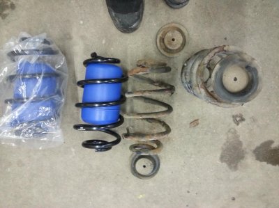

Was happy w/ my McGaughys deluxe 2/3, just wanted lower and level. Got all additional parts to make into their 3/5 w/ their helper bags. Hasn't turned out to swell yet. Back too high, front almost too low( likely make front work ) . Front measures under 30" w/ driver side cranked up to max. Did the relocaters, end links, shocks and swapped the 3" spring for the 5". Also removed rubber isolators. Back only dropped 3/8". WTF? Side by side, they look same height; only slightly 'thinner' coil diameter (maybe). Could they have shipped wrong spring? That's total fail in itself, but the new spring/shock combo rides like crap. Got to be 1:30am, so threw old spring/shock back in and 400+ lbs behind rear seat so it was closer to matching front and it rode like it should. NEED SOME HELP PLEASE.

Yup, moved that, even though didn't see it was needed in my case. Rides near perfect (at same height ) w/ old springs back in. even if they did send me new 3" spring, way such change in ride qaulity?

FWIW, two springs can look the same height when sitting side by side but if the coils have different rates they will compress totally different under the same weight.

No drop from "diff" spring, but drastic change in ride. Mod done and shocks right. Just 'cause we tried everything else we could think of; even set it down w/ out shocks = no difference. Today swapped new shocks back in w/ old spring and ride still great = new spring terrible. If I had to trade ride quality to get desired drop that would be one thing, and a choice to make; but many others w/ this set up give great reviews.

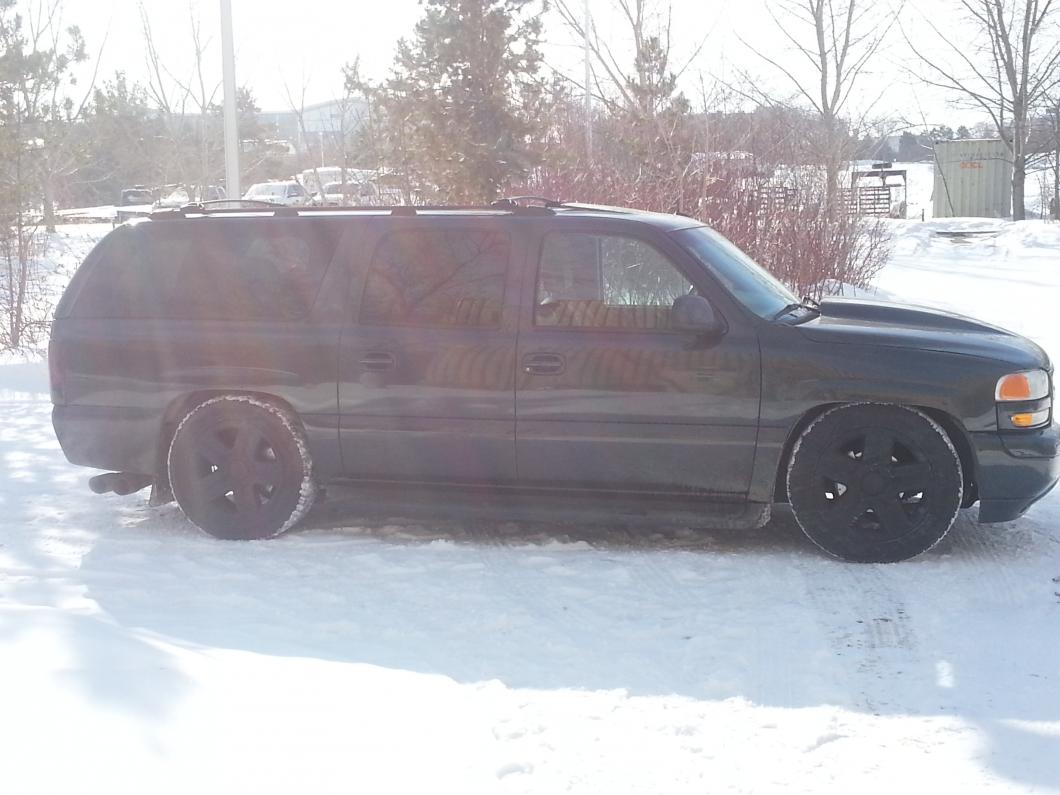

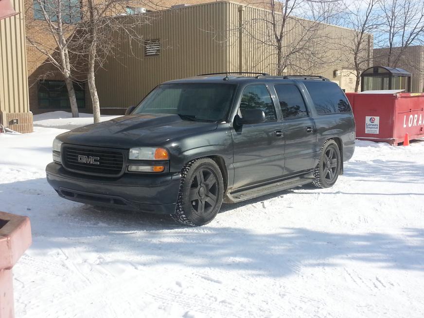

Pics are w/ old springs ( 3" / no bags and nearly 600lbs in hatch )
Just to get me through rest of weekend w/out driving around 'ass-up'
