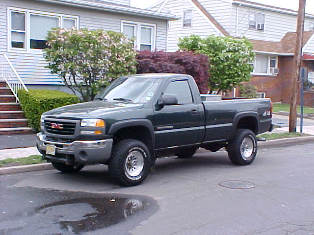

truck actually felt stronger loaded up with a 1000 lb of salt in the back and a 8 foot commercial fisher plow up front.
had 33's too from day one of owning it, aka it came home these were on the old truck i had so they went right on it. this is one of them factory freak trucks that came just a bit higher then most, but i still added 2 inch blocks out back and torsion bar keys up front.

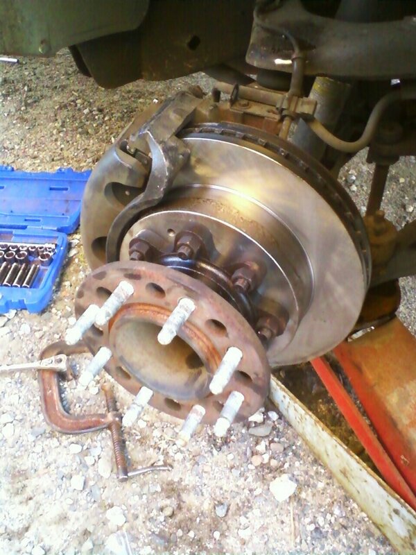

this truck also had huge rotors, i want to say 14 inch or larger and had monster dual piston calipers front and back, same pads front and back too.
if this truck could talk id be in jail lol

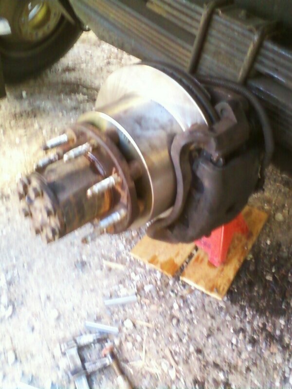

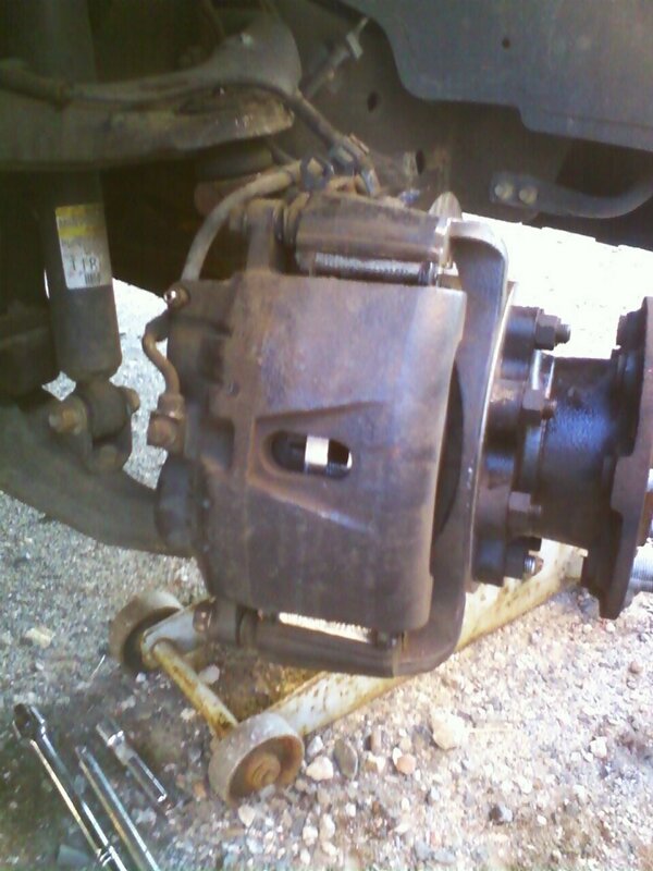

these brakes are on a 05 3500, same brakes and all tho but its a dually mason dump truck.
little tip for any one doing brakes on a leaf sprung rear end, you break the slider pins free, then take the bracket bolts out and remove the whole caliper and bracket as one unit, with all of GM's wisdom the slider bolts will not come out, the leaf springs are in the way. same deal for a 2500 with a short stack of springs.

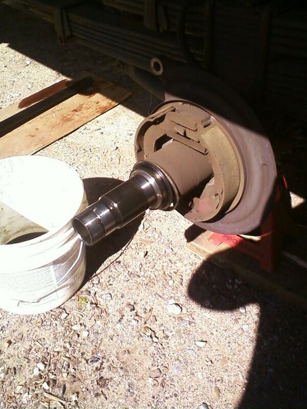

and for that rotor your pulling the axle and the locking nuts and bearings. more fun. talk about dead weight too.
in the end you got to love a full floating rear end.
