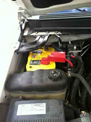

NJ04HOE
NJ04HOE
May 1, 2009
1,516
77
Paterson, NJ
It must be an oversight, as the Optima Yellow34/78 is the same dimensions as the red34r red top. The only issue I see is CA and CCA for the yellow top is lower than the red top, but they offer other batteries for the 2010 with even lower output. I'd say you're good.
I personally have no issues with the Optima. Everyone bisches because they're now assembled in Mexico, but so far, we have Optimas in all but 3 of our 12 cars, which includes two of them in our diesel GMC. The only one that's failed in a long time is the one in the race car, which was a yellow top that was 4 years old.
The other one of those 3 w/o the Optima has an Odyssey mini battery in it.
Thanks it's in
