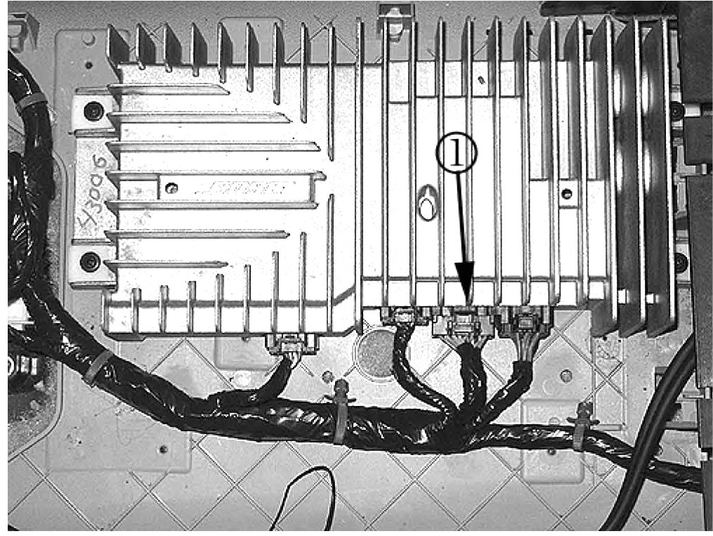

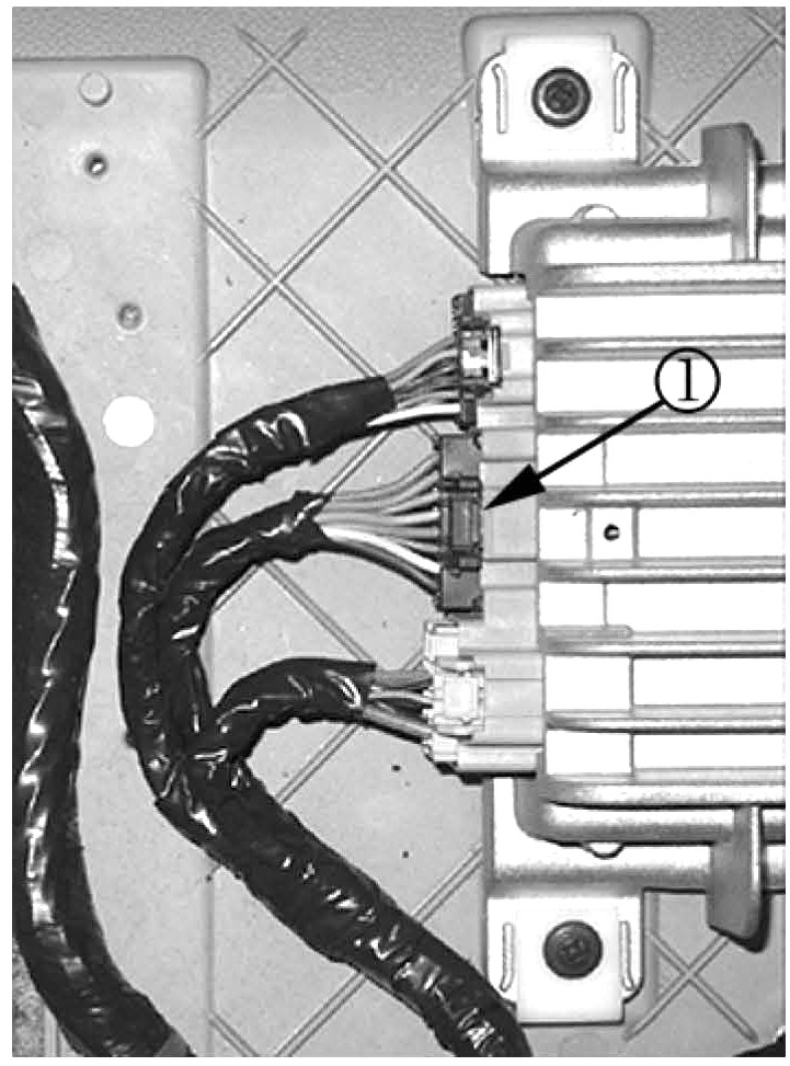

This happened to me again today and while shutting the car off (and opening the door) and turning it back on worked I started looking further for an answer.
Found this
Instruments/Audio - No Speaker Audio/Warning Chimes
Bulletin No.: 07-08-44-008
Date: April 18, 2007
TECHNICAL
Subject:
No Audio/No Sound Heard from Radio Speakers, Turn Signals, Hazard Signals and No Warning Chimes When a Door or Liftgate is Opened (Inspect/Seat C2 Audio Amplifier Connector) Models:
2007 Cadillac Escalade, Escalade ESV, Escalade EXT
2007 Chevrolet Avalanche, Silverado, Suburban, Tahoe
2007 GMC Sierra, Yukon, Yukon XL, Yukon Denali, Yukon Denali XL
with Speakers, Premium Audio w/Amplifier or Rear Stereo Audio (RPOs UQA, UQS or UK6)
Condition
Some customers may comment on one or all of the following conditions related to no audio/no sound:
No sound from one or more of the radio speakers.
No blinking sound heard form the turn signals or hazard signals when on.
No audio warning chimes heard when a door or liftgate is opened.
Cause
The C2 Audio Amplifier Connector may become unseated at the amplifier.
Correction
Inspect/Seat the C2 Audio Amplifier Connector (16-way, Black Connector).
Remove the radio, amplifier, and SIR fuses located in the Underhood Bussed Electrical Center
Visually inspect and pull on the C2 Audio Amplifier Connector (1).
If the connector is properly seated, then refer to SI for further diagnosis based on the customers condition.
If the connector is loose, then reinstall the C2 Audio Amplifier Connector.
Verify the connector is seated and locked into place.
Install the fuses.
Verify the condition has been fixed and clear any DTCs.
If securing the connector does not correct the condition, refer to SI for further diagnosis and repair.
Install the radio speaker amplifier assembly and any other components removed to gain access to the amplifier.

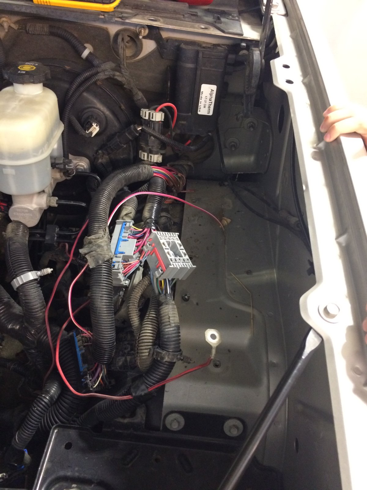

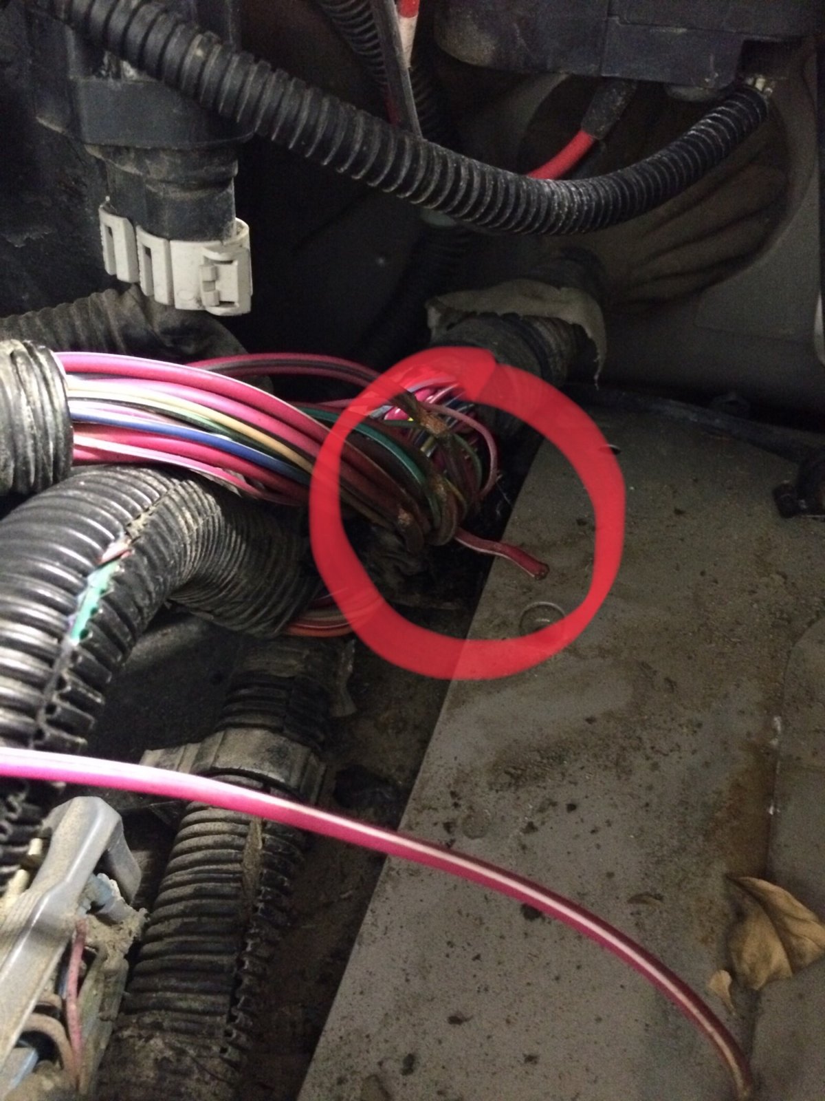

Solution....at least in my case. I finally took it to the dealer and had the problem diagnosed. The problem was no power to the amp. They found a broken wire (and several others almost worn through) under the main fuse box, under the hood. There is a metal plate under the fuse box and one bundle of wires was rubbing on it and wearing through the insulation. The power supply to the Amp was worn right through.

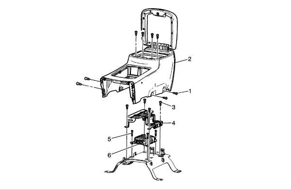

Ok, Im new here peeps. I have this same issue with a 2012 Yukon Denali. Its been ongoing for a year now. I recently narrowed my culprit down to the harness at the amplifier. After reading tons of write ups i decided to pull the center console up and check the amp and connections while I had no sound. When i wiggled the connectors at the amp, the sound popped on. I then zip tied the connector to its connection. Needless to say, this is an ongoing issue as the connector keeps wiggling out during trips. Im stumped. Can this harness be hardwired in????? SOMEBODY HELLLPPPPP....please?
