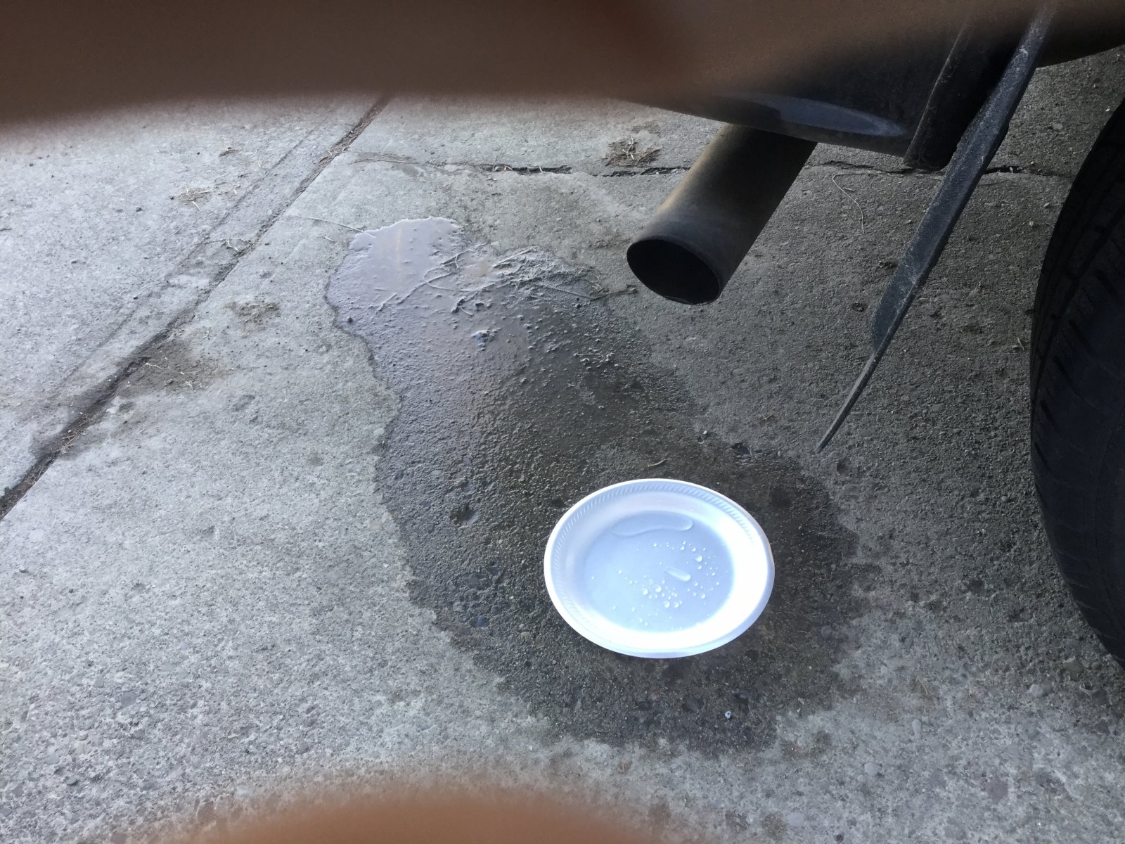

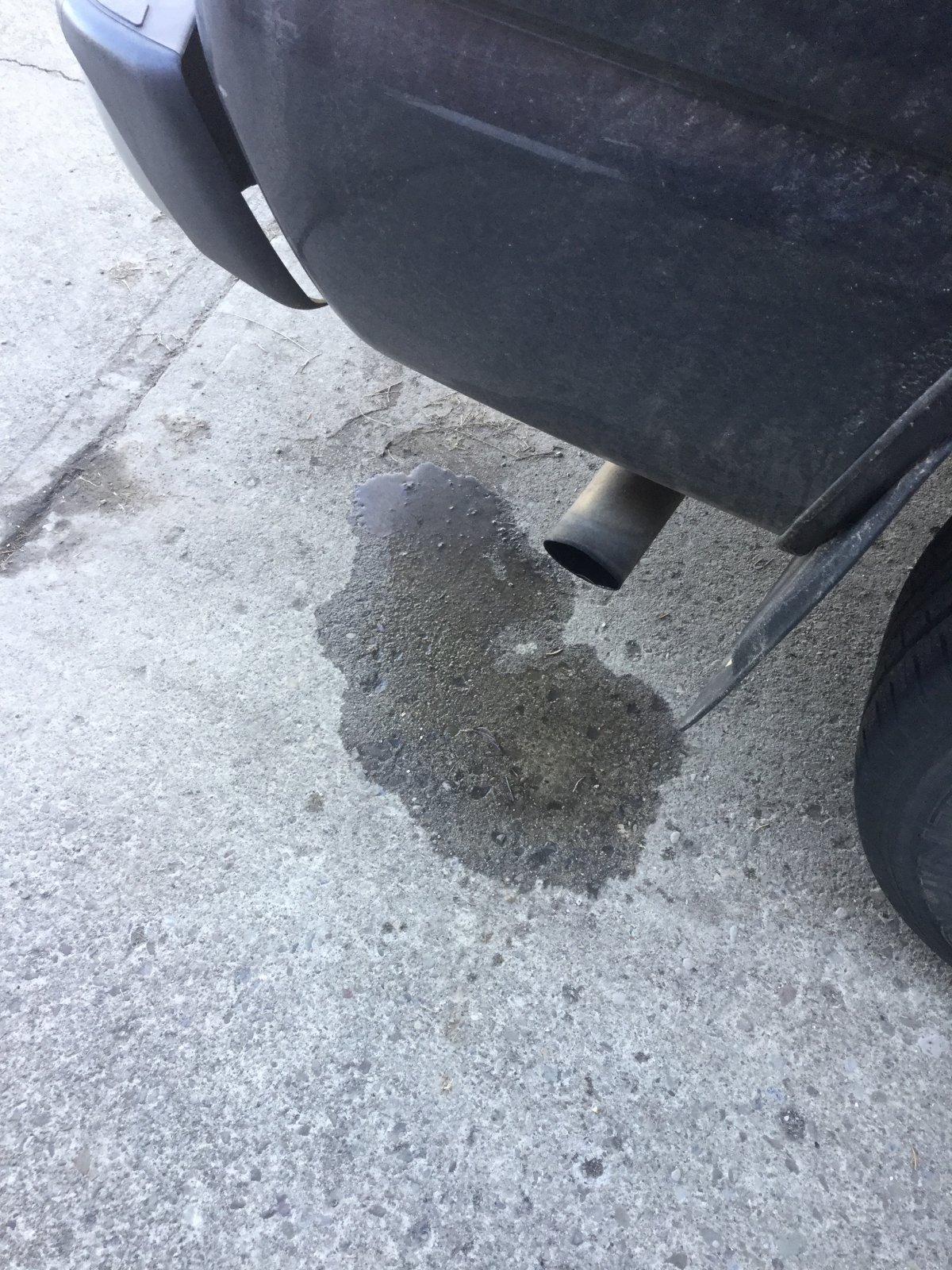

Tested fine but I noticed this

Taste it. Does it taste like anti-freeze. I mean, if you do taste it just a finger tip will do. But it is likely the water, by-product of the combustion process, that all tailpipes will drip out.
By the way, what "tested fine?"

I tested it with a block tester and no issues there! The water keeps dripping tho, exhaust doesnt smell “off”. Call me paranoid but I really dont wanna taste that LOL

Well then it appears that the head gaskets are good at this time. You are losing it somewhere. You might want to send an oil sample in to have it evaluated. I don't know who to recommend and oil testing but others here will. Just do a search for oil samples and oil testing. But I bet if you LOOK hard enough you can see signs of where the problem is.
