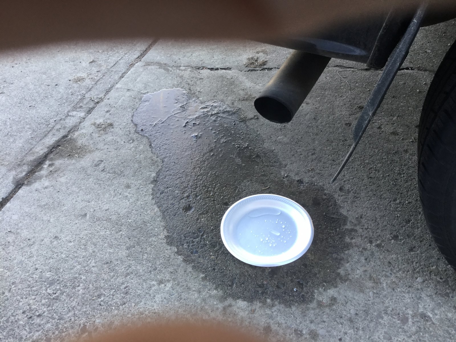

Welp she held pressure. My question is, if I put uv dye into the coolant, will it show up in the exhaust water if the truck has a bad head gasket? Also if the cylinder head is cracked and coolant is making it’s way into the oil, will the uv light pick up the dye in the oil?
30,574
48,063
water condensation out of the tail pipe is normal, you need to get a flashlight and get under the truck and look up, places to check are the heater hose area (along passenger firewall), radiator hoses and T, bottom of the water pump, bottom of radiator and sides of radiator, rear hvac unit (bottom right rear under the back bumper behind the wheel). IN ALL INSTANCES the coolant will flow down because you know.... Gravity. If you cant find a specific leak location get a big piece of cardboard and leave it under the engine area overnight and look at it in the morning.

Actually its holding pressure so if there is a leak I’m gonna say its internal. The only other thing i can think of is that maybe there was air in the system from when the hose clamp was repaired and when it cleared up it made it appear as if im losing coolant. If its the dang castech heads causing it im gonna have a friggin stroke. Trucks worth no more then 4 g’s as it sits. Its loosing way to much coolant to not either be air in the system or something internal.

Just because it is now holding pressure does not mean there is no leak. It may only show when hot or cold. Cardboard is a great start to set under there and see what happens. Don't assume the worst yet.
