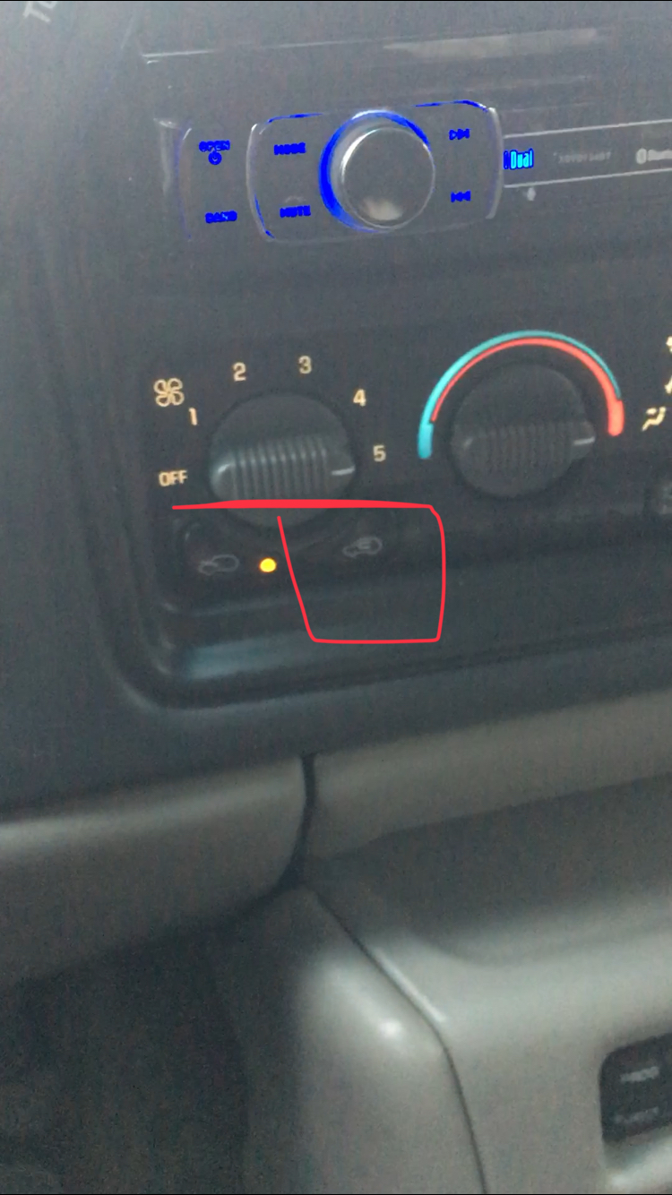

I’ve also notice it won’t let me change to the other air type. It lights up 4 times and just doesn’t switch. Does this mean it’s the blend door?

Thats recirculated air, sometines it has to be on an a/c function, cooler temp for that to work, try swapping temp first then air direction and see whats up
