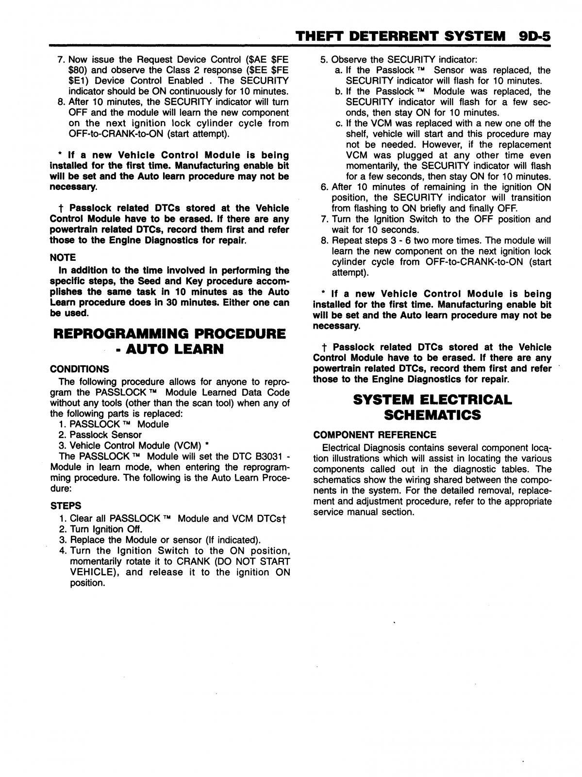

You’ll have Passlock on a 98, but even if it’s tripped (Security light stays lit on cluster) it usually allows it to start for a moment before the VCM kills the injectors. Technically, though, it has to get a valid signal from the passlock module to enable the injectors. The passlock sensor at the ignition switch signals the module. There’s a reset procedure for that and is required following ignition switch replacement, but it sounds like you have a separate issue if the starter solenoid won’t even click using the ignition switch.
I’ve usually had to clear the Passlock codes to get mine to reset, but it’s a catch-22 with your DLC issue. Maybe try the reset procedure anyway.

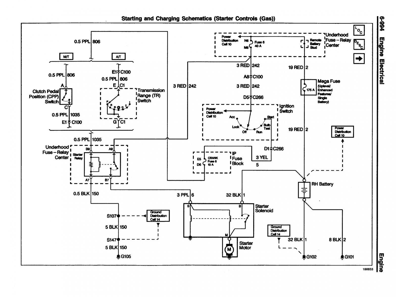

Here is the starter diagram for 1998:

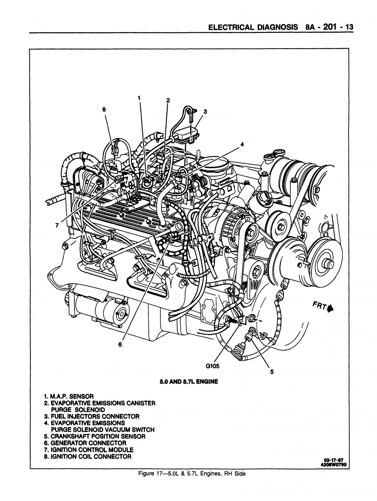

If you have voltage at relay B9 when turning the ignition switch, take a look at ground G105:

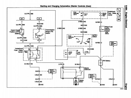

First you gotta get those grounds corrected. Check starter relay terminal a7 in the schematics on first page here and see if ground is connected to the coil of starter relay. It will never crank without bypassing the relay if that ground is missing.
