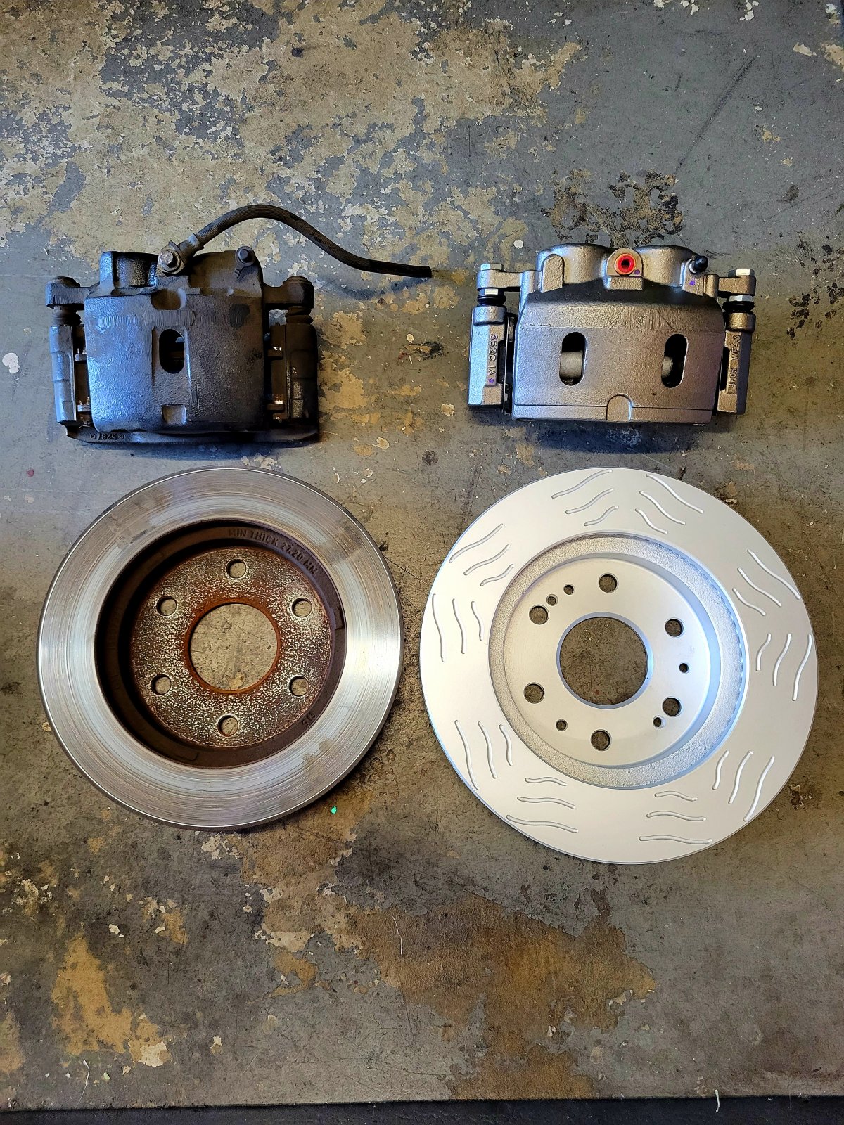

Finally did a full brake job (front and rear) with new calipers, rotors, pads, and stainless braided hoses (all six). The fronts got changed to the larger 07+ calipers/rotors.

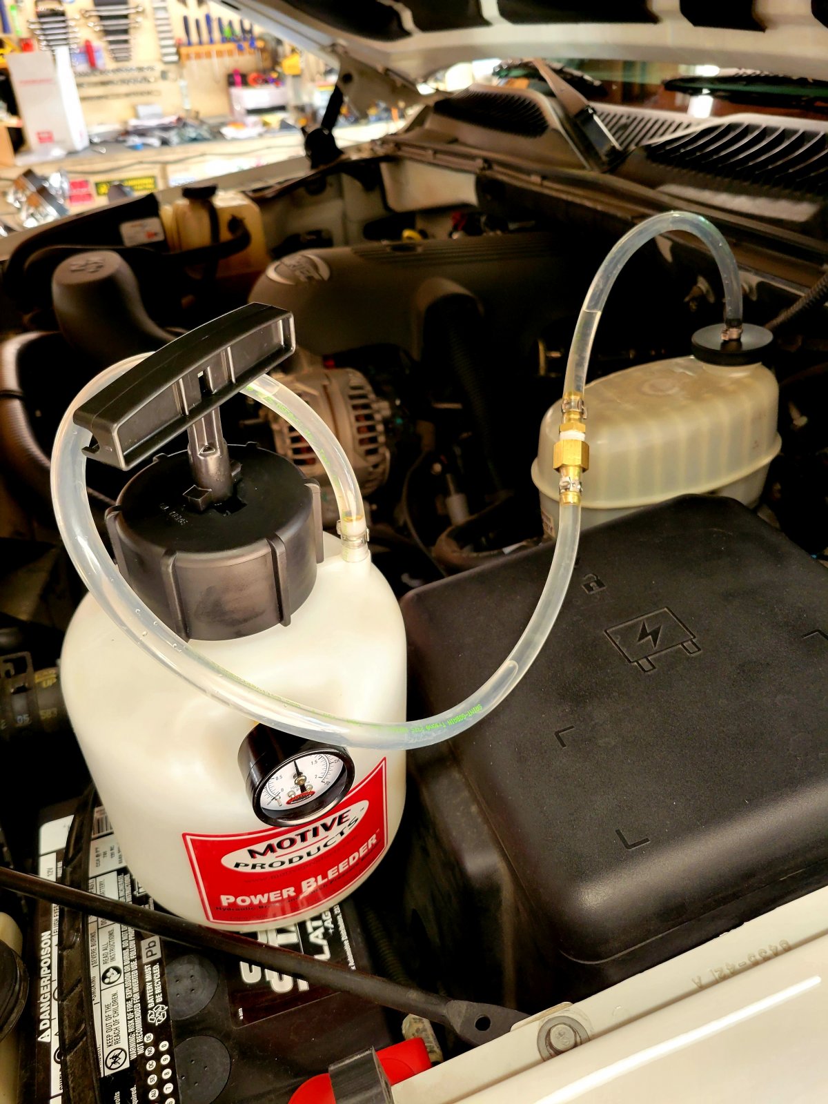

I bled the entire system refilling with fresh fluid. Test driving does not feel firm like I was expecting. I'm thinking a second bleed is probably necessary after driving and seating the pads. Must still be some air in the system. Anyone have any experience with this? Thanks!

I did not have a power bleeder when I did mine. I just pumped the pedal to build pressure, then opened the bleed valve. The first time was soft, but after a few more repeats of the pump and bleed... Pedal feel improved. Felt fine to me after that. Brakes work great.
I would go through the process of working the brakes in. A few good stomps on the pedal to seat everything real good. Then, check the fluid level and top of it more is needed in the reservoir.

Yea it's not even close to feeling 'hard'. The power bleeder essentially does a pressure test at 15psi, I've checked all fittings several times and all look good. Might not be able to bleed until end of the week. I'll report back. Thanks!
