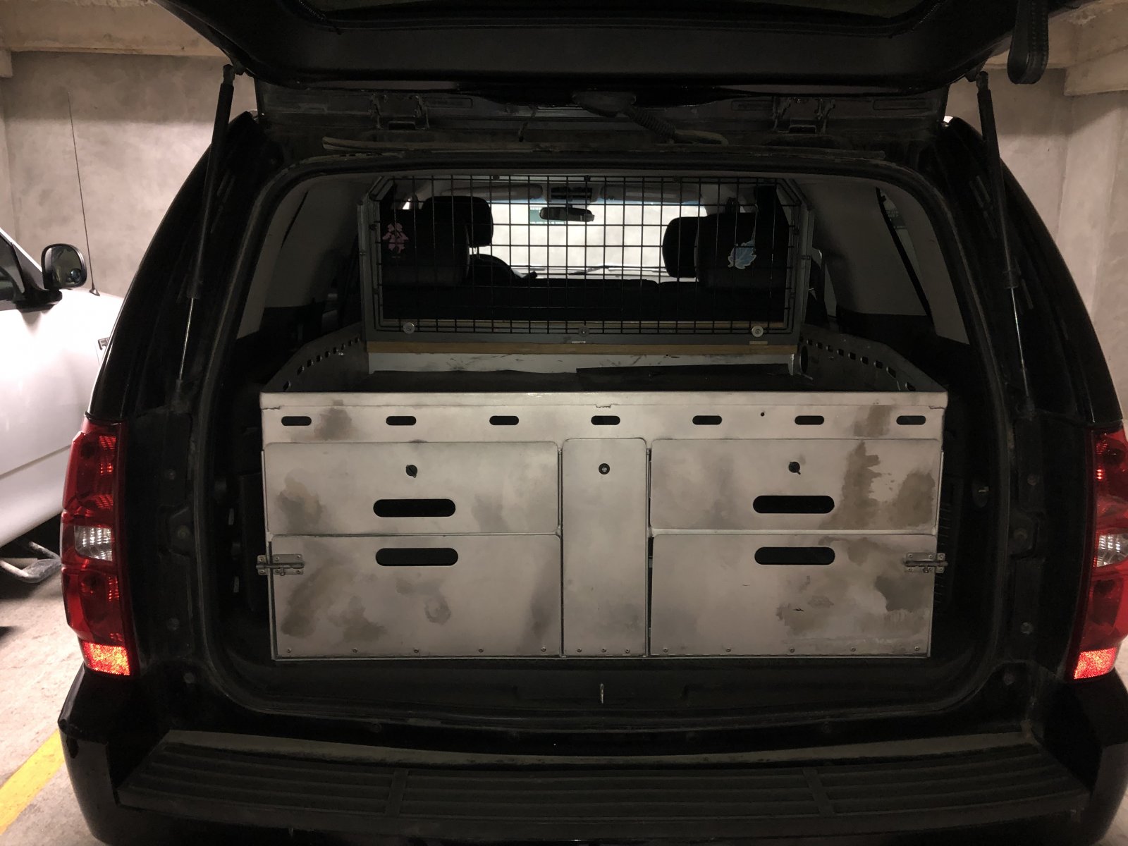

Sometimes the radio console. Occasionally a front pushbar. More often with the weapon locker And cargo barrier.
Notice the diamond pattern in the window, that’s the cargo barrier. You can see it better behind the folded seat. Also the front of the locker.

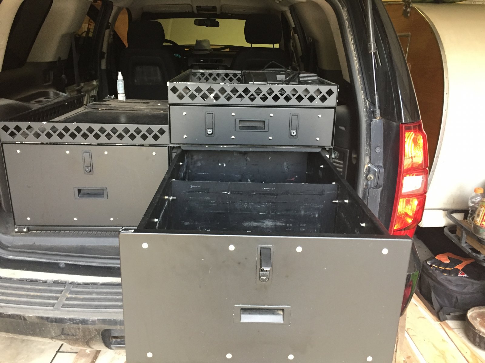

Thanks! What extras do those patrol cars come with?
Both of mine came with a locker, only thecopcar had a barrier. I got rid of the silver one, because it was heavier.

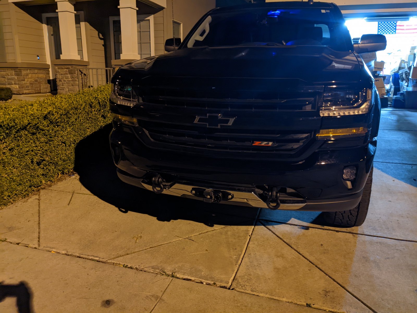

I'm doing research on this as well. I'm going to put a drawtite front receiver on my 06 z71 burb and go with a winch tray insert that can go front or rear pending the situation. The hitch is rated for a 9500lb straight pull so a 10k winch is what I'm eying. I will use the front hitch for more than the winch so I that's why I want the winch mobile. I did just watch a video on a hide a winch setup from rough country and harbor freight.

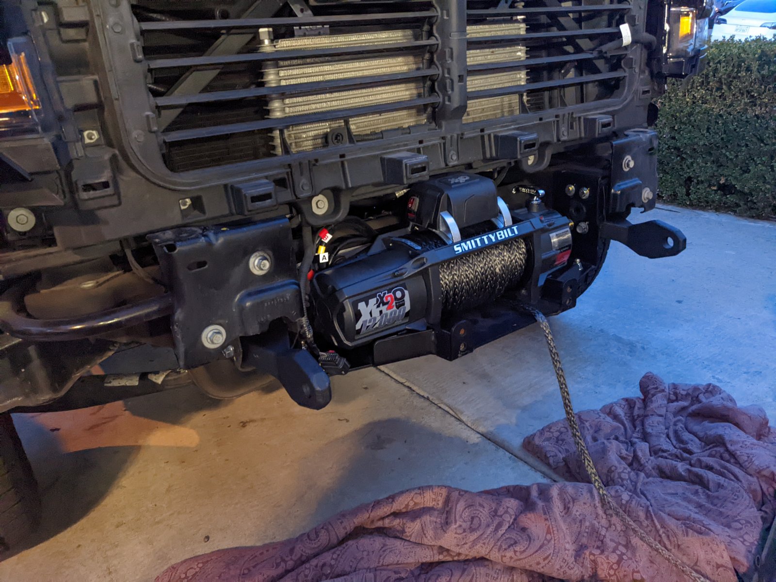

a rough country hidden mount kit is what I used on my silverado, probably works in a similar manner for the gmt 800's, some of the bumper mount has to be cut between the frame, drill a few holes and then it bolts up
Clean install!!!
Can you still access the power switch and clutch lever on the top of the winch?
I'm still having to address necessities, like proper brake action. But, I may get to a winch some day...
30,579
48,077
Clean install!!!
I can reach up under the bumper for the clutch and switch very easily, the bracket makes it kind of cupped in but there is room
