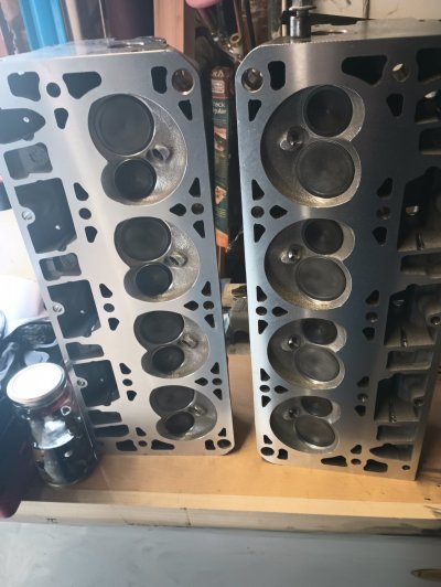

Yeah. I would get your heads remachined. You certainly have the budget. My local machine shop charges like $350 IIRC for this service, which includes cleaning, taking enough material on the cylinder side to clean them up, valve work, and new stem seals. If you figure out what cam you want and the cam requires different springs, then have that work performed by the shop all at once.
I'm about to drop off some 317 heads this week for an engine I'm putting together slowly. They are usually done within a week.
These are a different set of the same heads (317) I had them work on.
