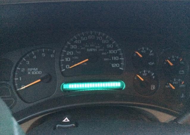

Messed with truck tonight. It had about 12v on battery and sluggishly started. I found one fuse at instrument panel fuse box, left of driver, That had a wire sticking out of it. Fuse was not properly set. The fuse was labeled 'tbc accy'- truck body controller accessory. I think this wire was for the entertainment system for rear of vehicle installed by dealer. Pretty shoddy install. Cluster was dead again bTW.
I checked the fuses in engine compartment as well. I found one labeled 'IPC/DIC' - instrument panel cluster /driver information center. After I pulled it, with key out of ignition, I measured 12v. After resetting it, the mileage went blank, meaning all LEDs were lit up. But it would not turn off, event after couple minutes, and interior lights dimmed off. I pulled the fuse again for the night thinking my drain may be from cluster. I will check it tomorrow.

here is a picture of my dash once i put the fuse back in:

Took it out tonight. Battery was at 11.6v. But started up fine. Gauges were all working fine again. When I shut it off, this time, there was one dot in middle of odometer on, even after vehicle was locked. I came back 15min later, gauges dead again. Crazy. When they work, everything is perfect.
When I shut it off, battery was at 12.16v.

So i finally took my cluster completely apart. There was really nothing in there that you could mess with as it is all microchips. There were two capacitors that seemed ok though i did not measure there capacity.
The LED tubes that have the odometer and gear indicator had what seemed like a hot spot on inside of both as if something had burned out.
I then re-assembled it all, plugged it back in. It has been working fine since. Has not gone out once. I am suspecting that it could be a problem with the contacts in the connector between cluster and wiring harness. I saw a YouTube video that showed how to re-tightened the female part of connector.
It is weird that it is working now though. I am thinking it may be short lived. Wait and see. The weird thing is that when i unbolted the cluster, is moved the wires around at the connector, and there was not change in cluster. You would think that if this was an issue, it would show.

So its been two weeks, every time i start up the truck, cluster is working perfectly. Don't know what I did, but I guess it worked... Frustrating (in a good way). I guess I will focus on the other issues :)
