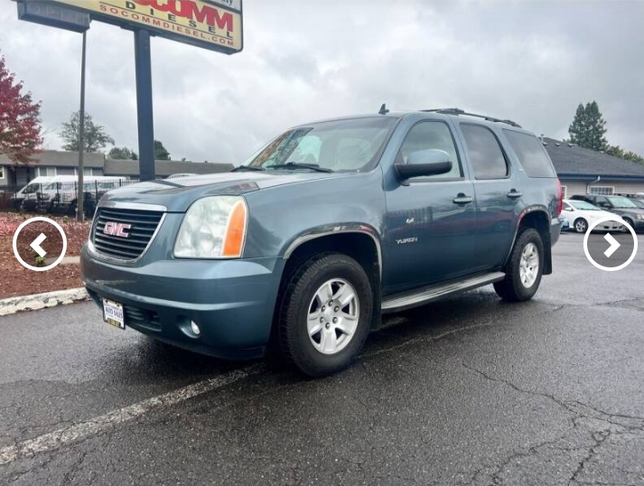

Thanks for the responses and the warm welcome everyone! She's a dirty girl right now, so all I've got is a pic from the dealer's listing. I'll get her cleaned up and take my own pics soon.

Rich color. GM didn’t do too many of the red & blue trucks. The batt cables rot from inside out. Like a pretty Apple, there’s gremlins inside waiting to ruin your day with bogus DTC codes or a mouth full of worms.
