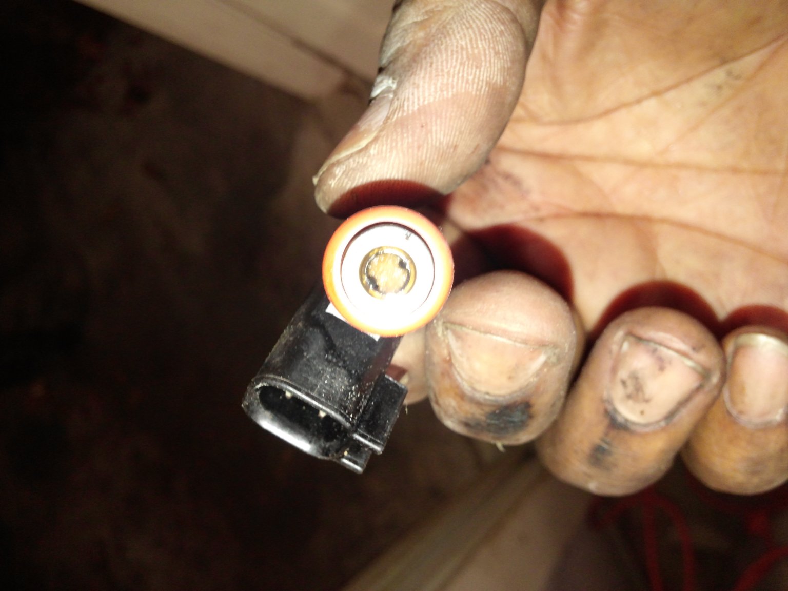

It must be doing something because if i unplug it the truck stops. Everything works correctly with the cooling system. i checked the plugs and seems that one is getting good spark but the other had carbon on it
It may be functional...but it is definitely broken. That blue grommet on the connector shouldn't be showing, it should be inside the black part showing in this image. Yours is missing that bit.. Should look like this:

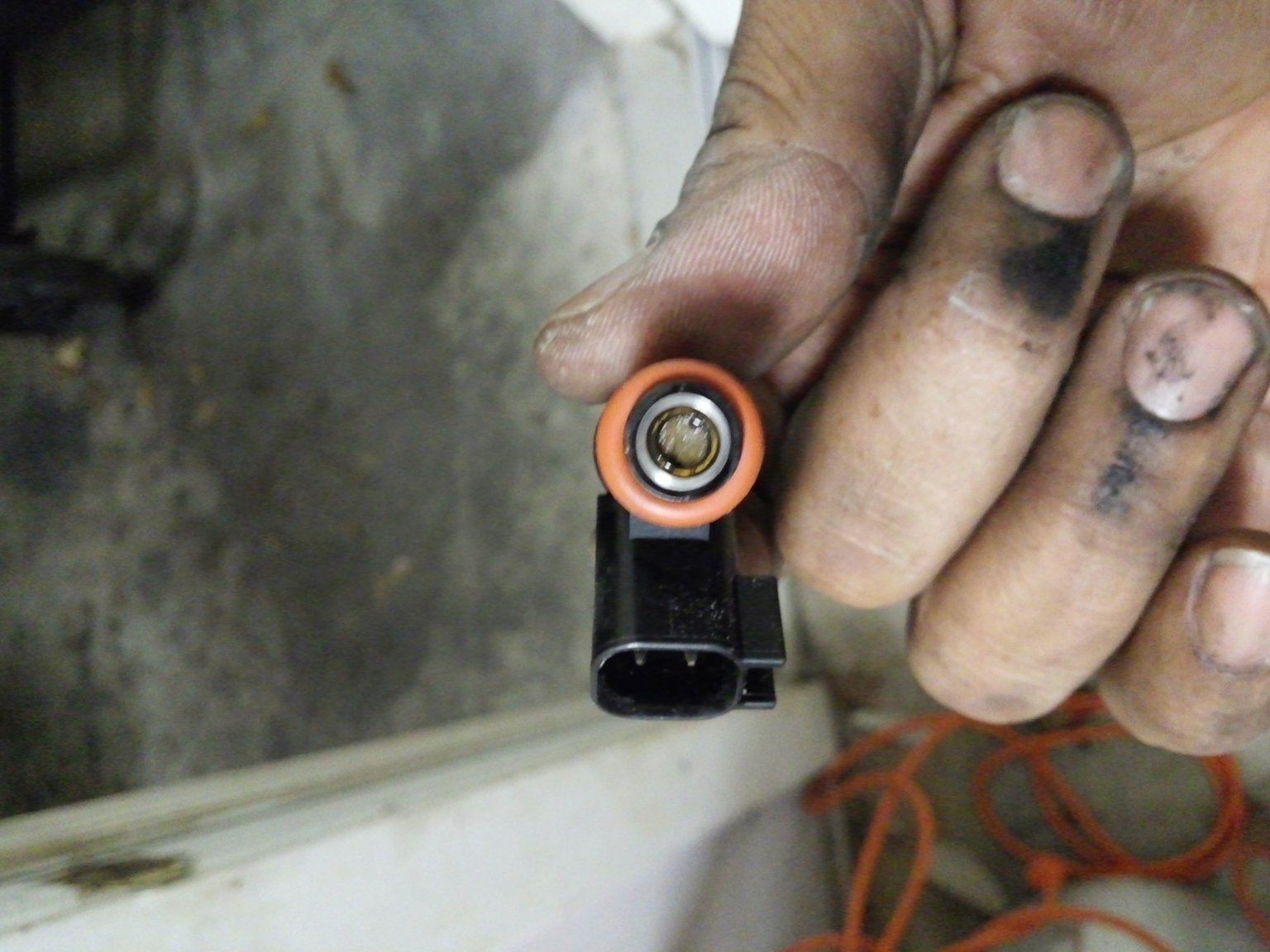

Compression checked out fine, the source of the miss is two injectors that are stuck open. The oil is coming from the valve cover gasket that needs to be changed.

I got the injectors installed and WOW what a difference! This thing is actually pretty strong! I have noticed that I'm still running a little rich though from the exhaust sometimes and I'm still working on that.

yeah, they were done. I posted pics of the crap that I found inside of them that was clogging them up. I still have a little stumble when I first start it but other wise she runs really well. I drove it 110 miles this morning and she did well. I'll be doing a water pump in the next week or so and that should be it for the mechanicals for a while. Knock on wood.
