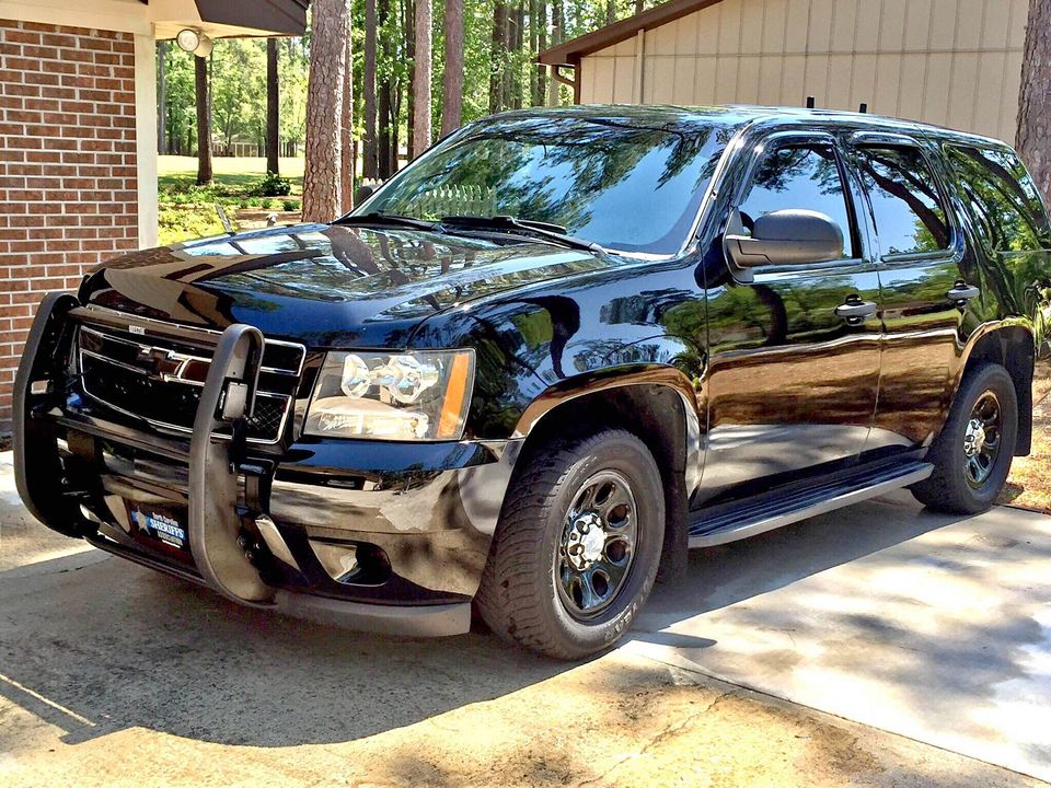

I’ve been a lurker for a while as I researched tahoes/Yukons as our next vehicle and finally landed on a 2013 Tahoe PPV. Picked it up for 9k with 140k and a list of recent maintenance the previous owner had performed. The PO was a volunteer with our local Sheriffs Office and managed to keep the lighting, sirens, etc during his ownership. Before selling to me they were all disabled.
Now here’s my problem, we’ve had the vehicle for about a month with no issues, then the other morning we went to start the truck and it was dead, but the radio, aftermarket XM radio and aftermarket GPS all came on. Hooked a jump box to it and it started immediately and started up fine the rest of the day. I thought maybe something was left on overnight and killed the battery. The next morning…it happened again. And this morning…again. So I’m assuming there’s a parasitic draw killing it overnight. Any advice or knowledge on what can actually been unhooked from the batteries? I believe the PO may have just “cut” the wires running to all the PPV-related accessories and something is shorting out and drawing power? Any advice/knowledge/recommendations would be great!
