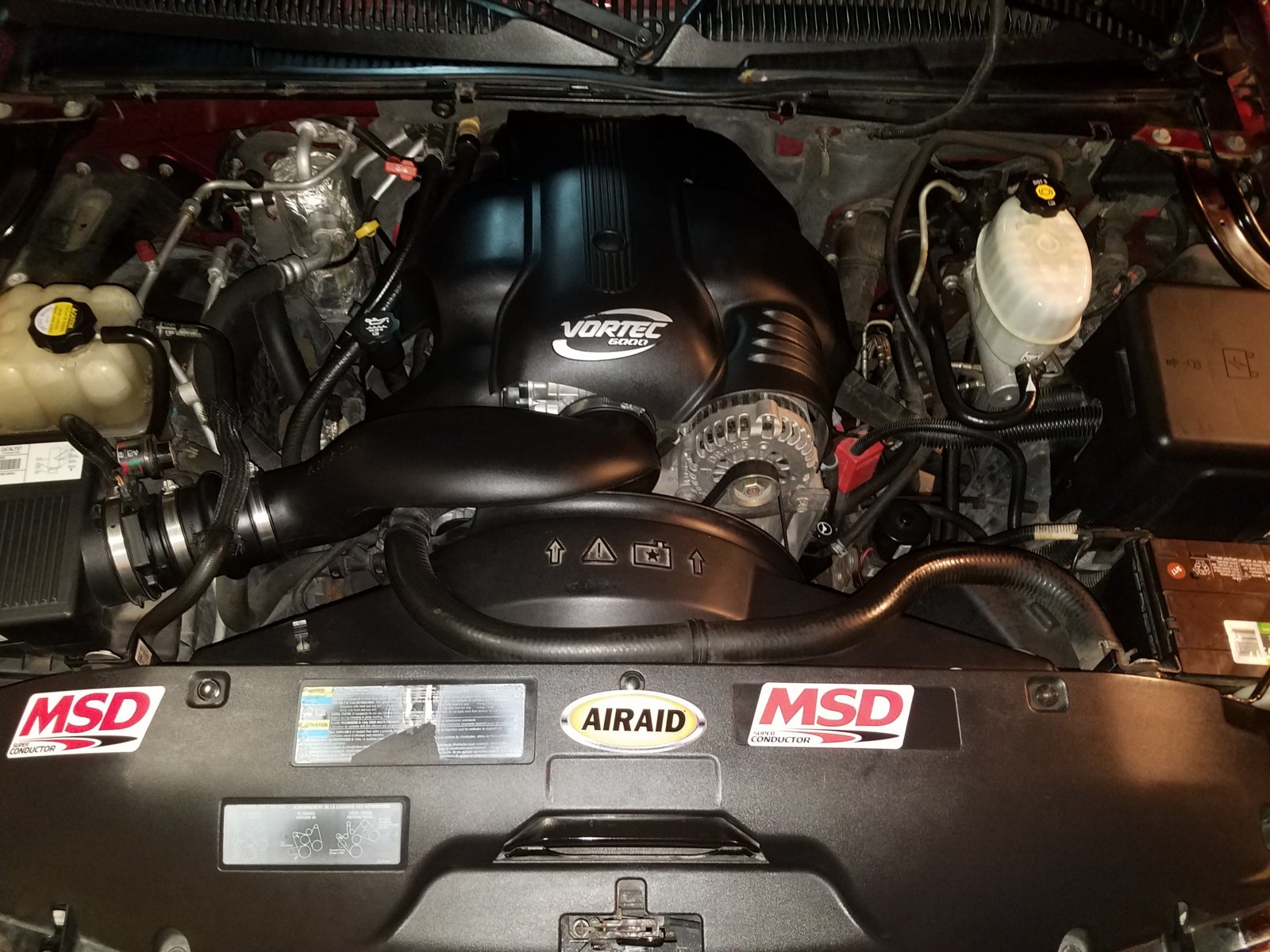

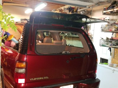

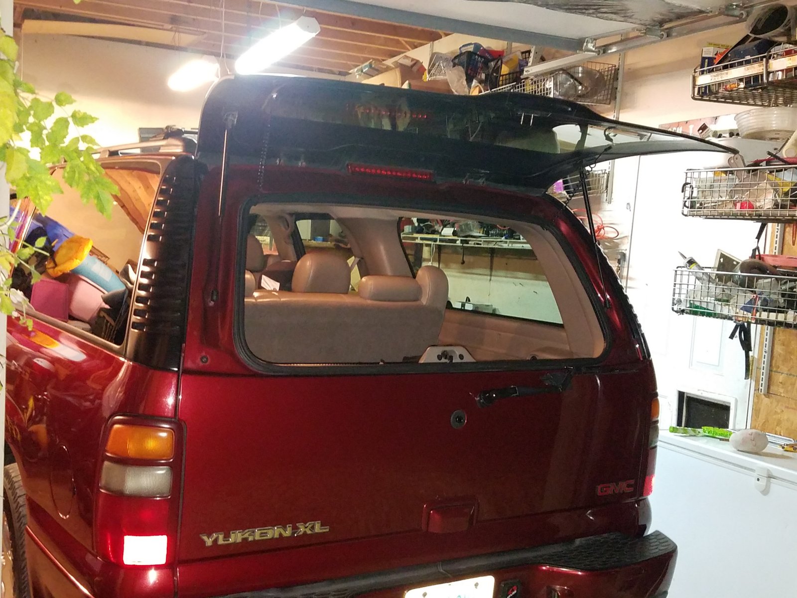

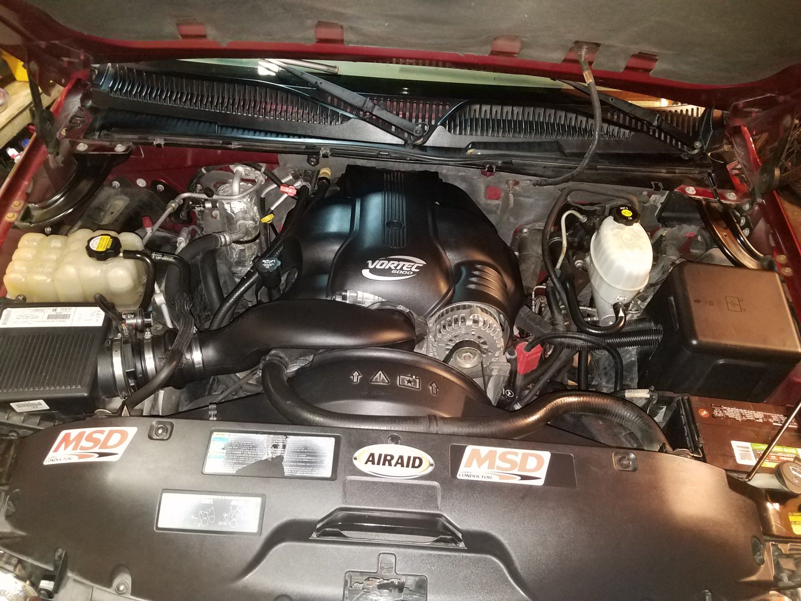

got the intake, pulled the battery negative, installed it and the window shocks, reattached the battery and took it for a 20 mile drive... I will say with confidence that there is more low end torqur, less pedal lag, and just all around better.. im happy, and I don't have to hold the back window up with my head anymore.. movin on uuup!!! lol
:cheers:
I would like to add that there is a noticeable tone change in the motor, me likey

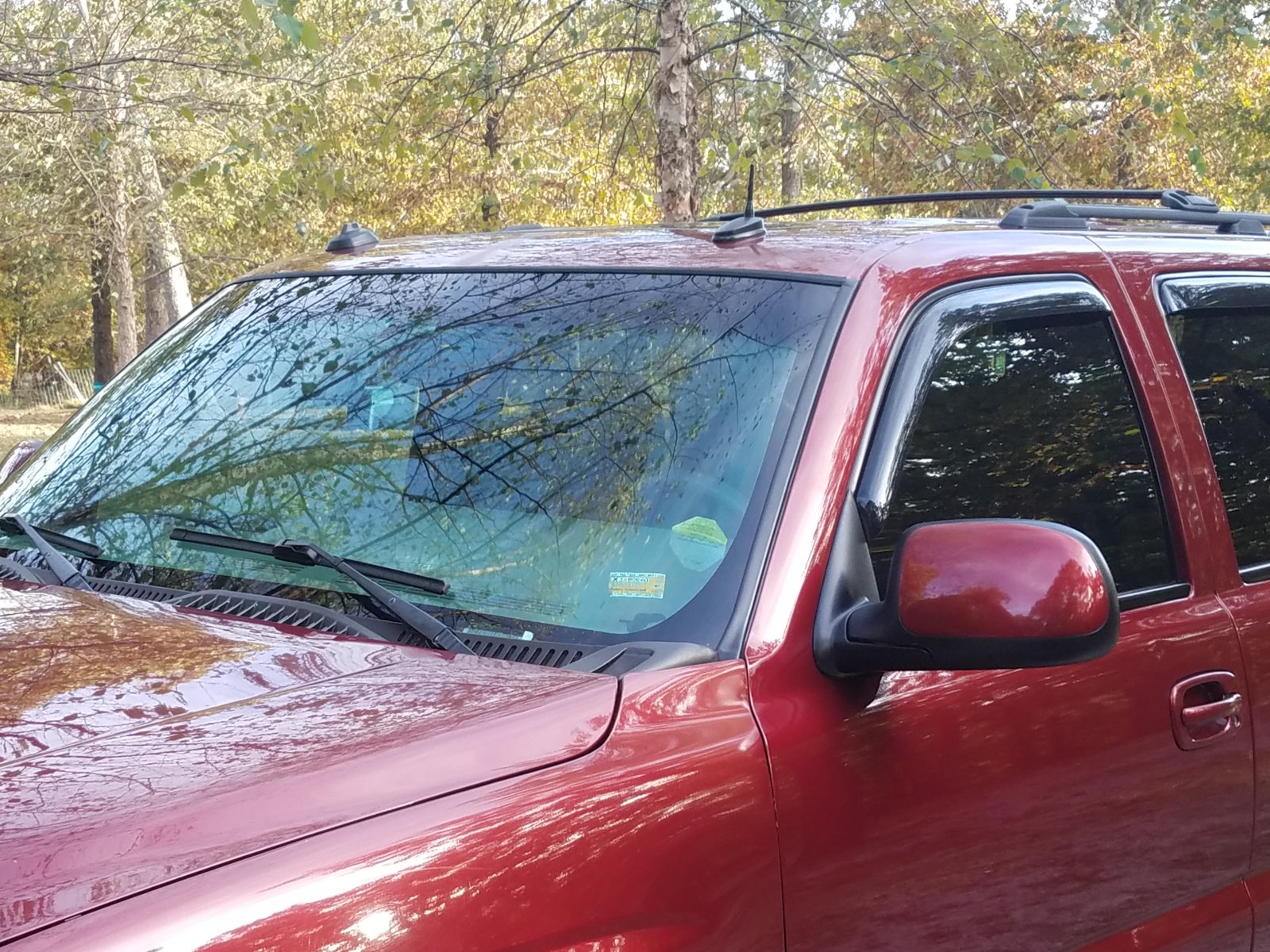

got the window tint done...
I love the windshield tint, takes away almost all ligh5 glare at night, you know, the "shining star" coming off headlights... gone. Nice.

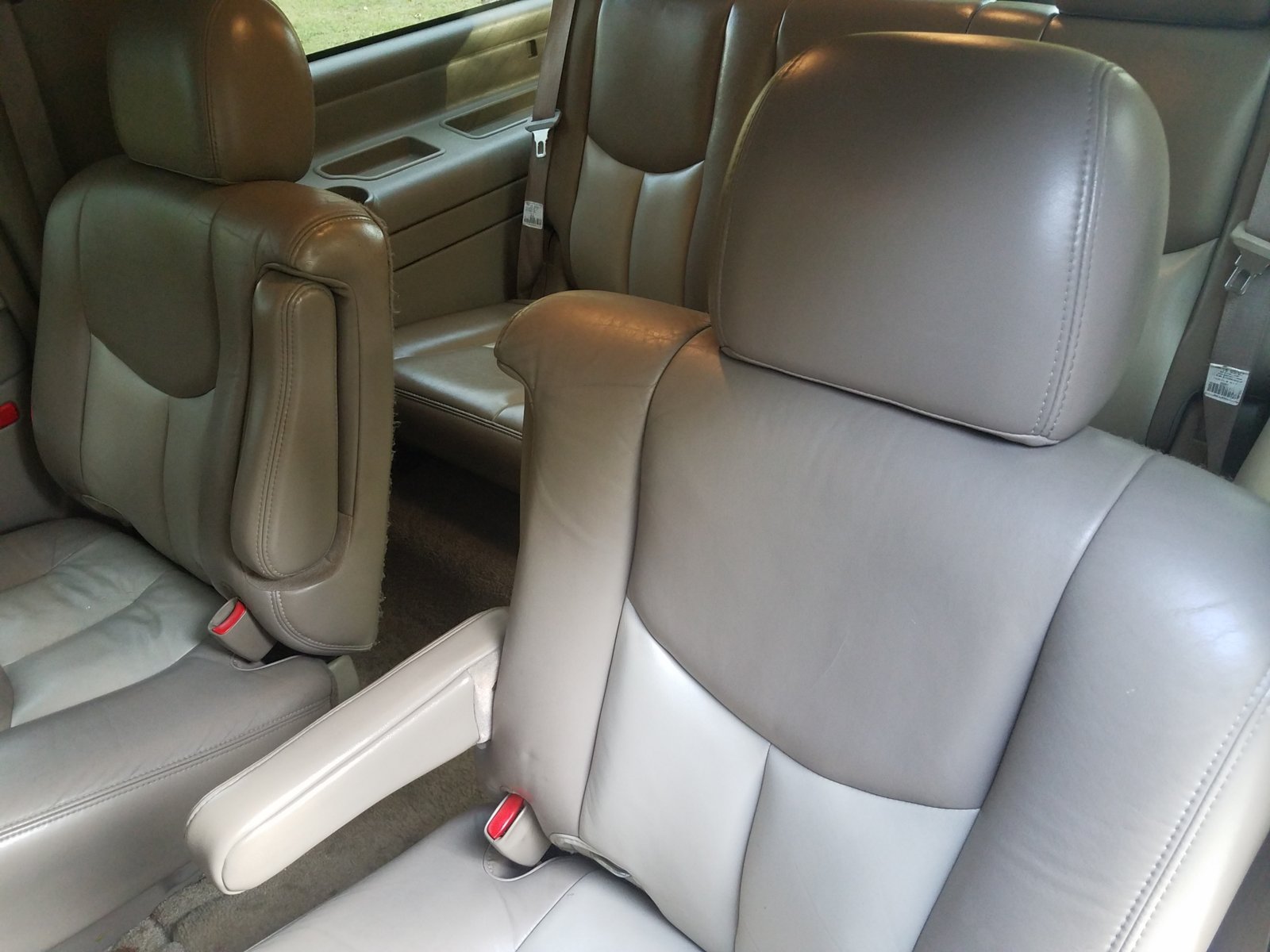

leather cleaned and conditioned all the seats today!!! I'll take pics of that too.

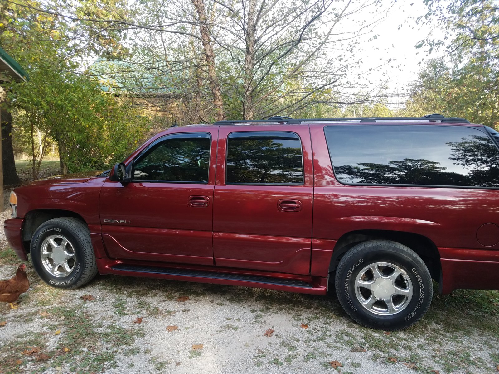

couple of the tint, inside, inside tint contrast of 35% to 70%, and a darker photo that might show the windshield better.
she's a beaut clark! a beaut!

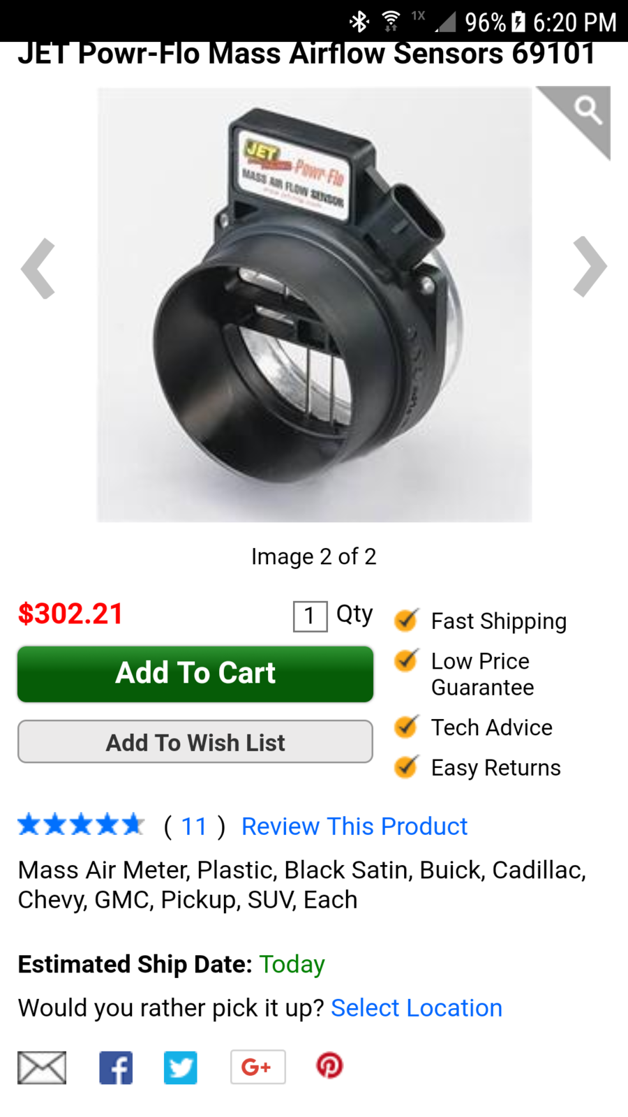

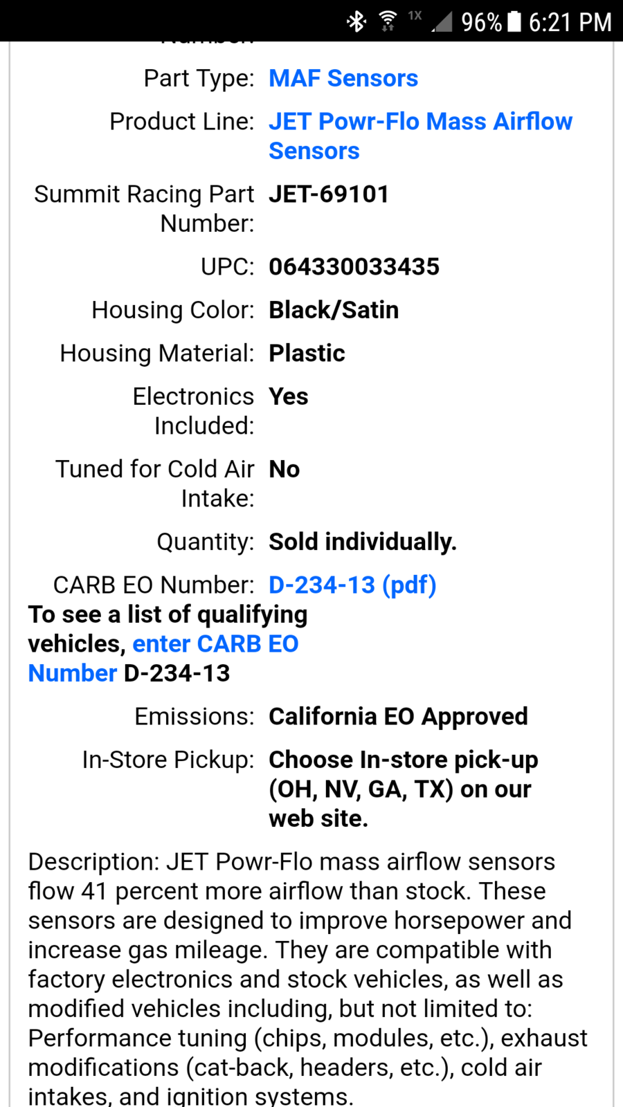

eta- I have not done any tune of any kind... when I get to the exhaust(1000ish), and cats(400 after welding), I will get a tune then. I was thinking of putting a jet maf sensor in when its done, but i want more opinions on the brand and if it's worth it. says that it's a better map flashed on a stock maf sensor... but is it worth the money.

something like this
if you go to jegs website and look it up on their page, they say that I need a low temp thermostat and a throttle body spacer...???
52,956
If you really want to waste $300 then get that MAF sensor. If yours is bad, get an AC Delco for $70 or if it's not bad don't buy either. I have my stock one on my supercharged Denali and it works fine. That Jet won't do you a damn thing except drain your wallet. Put that money towards a BlackBear tune.

I already bought a new maf sensor when I originally bought it, I was just wondering if the cost of 2 and a half sensors is worth 1.
thanks for helping!
im not racing it so i was thinking if it would help when I stamped on it for passes or something.

No it won’t help at all. Like I said, if the stock one is good enough to measure the amount of air that Im pulling through it, it’s certainly good enough for your engine.
52,956
Remember, it's a Mass Air Flow sensor- it doesn't increase or decrease the amount of air entering your engine, it just measures how much is entering. And also there's no need for an aftermarket throttle body either-once again the stock one is enough for even a supercharged engine which is consuming way more air than a stock engine. Don't fall for the hype that a bigger TB is going to make you more power. A good tune will do that though. For $600 you can buy an Autocal with lifetime tunes from Blackbear Performance and gain HP as well as make your shifting faster and firmer and will wake up your truck more than you can imagine. And you can install tunes yourself that they create for you. They e-mail the tune to you. You just hook up the Autocal to your OBD port and install it. If you want to spend some money to make your truck faster, it's the way to go.
Great advice. I've read the stock Tb can handle up to 500 hp! So you're good to go on that end.
