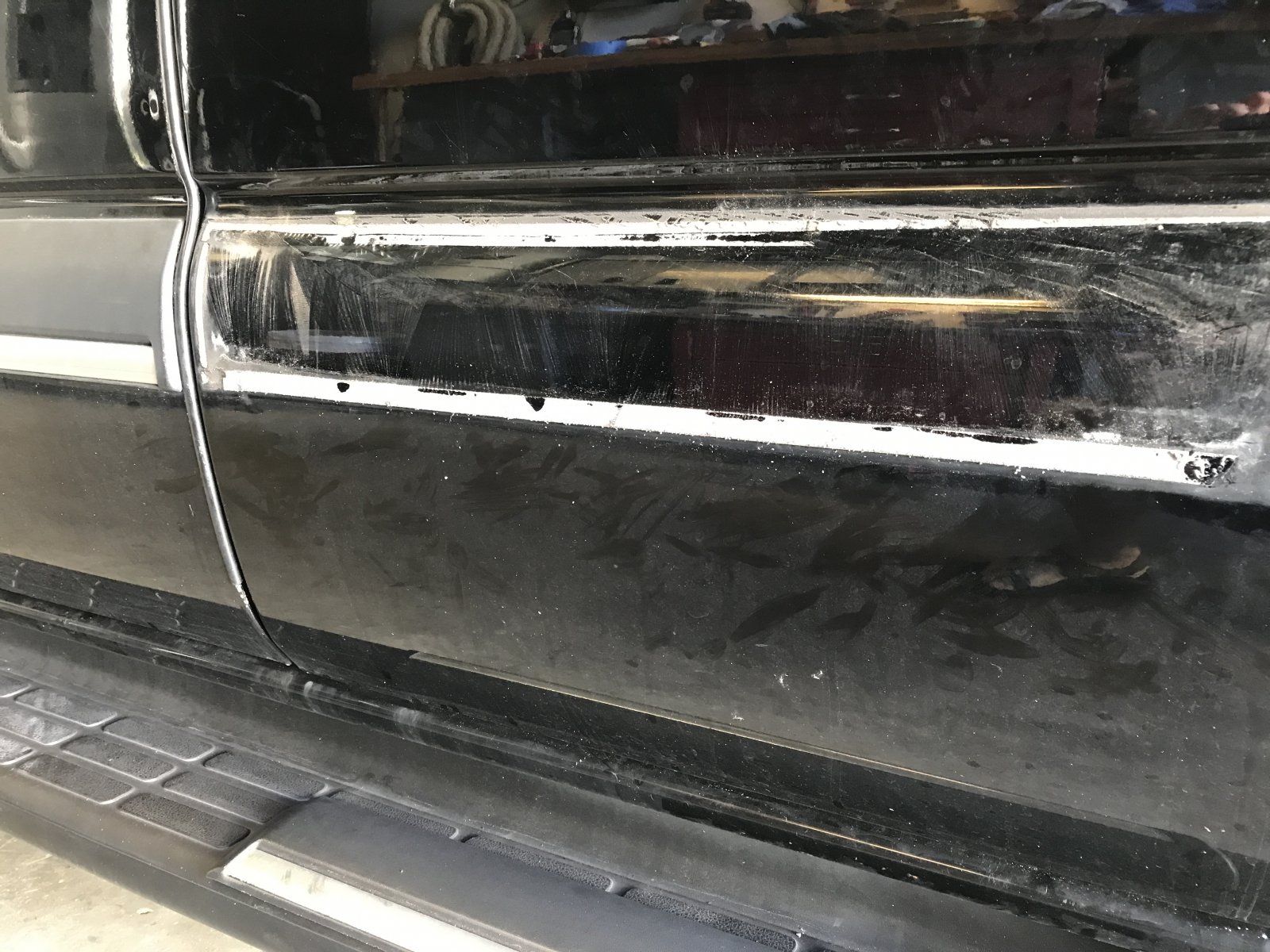

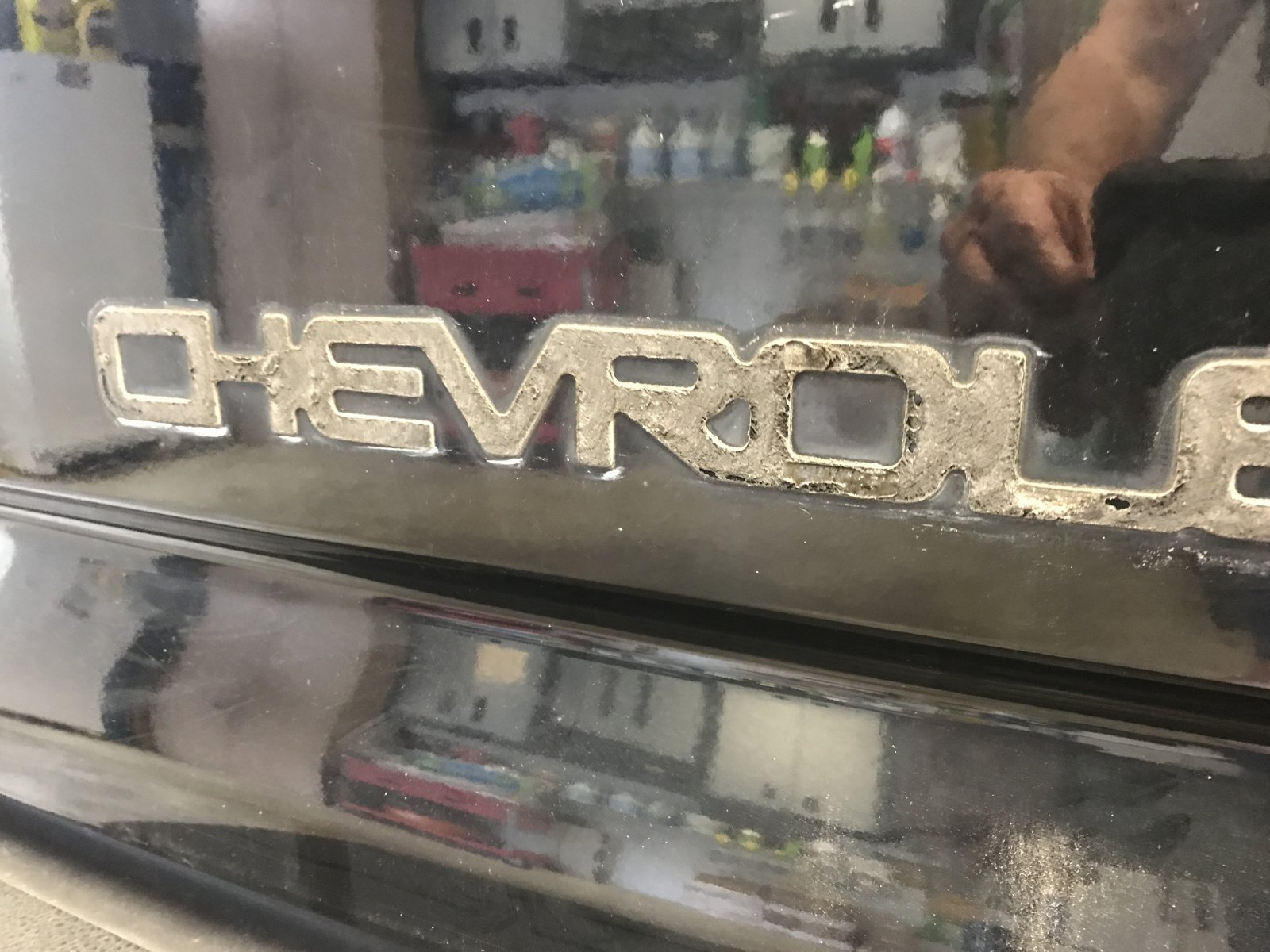

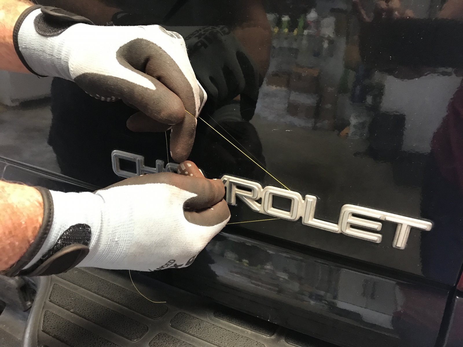

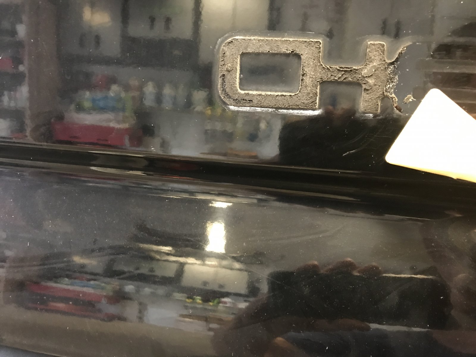

I used 20# braided fishing line to cut off the badges (pics). This leaves a lot of adhesive stuck to the paint. With some effort I was able to get the adhesive off with plastic putty knives and Goof Off to get the residue. No paint harm.
Thanks again for all who post on this forum!
3M Magic Wheel removes that residue pretty good.
52,956
Yea, I heard. I ordered one yesterday and it arrives tomorrow. I'm going to leave the rest of the residue on till it get's here. I ordered "3M Stripe Off Wheel". Probably the same.
Yeah that’s it. I might have just been thinking it’s magic because it erases stuff. :lol2:

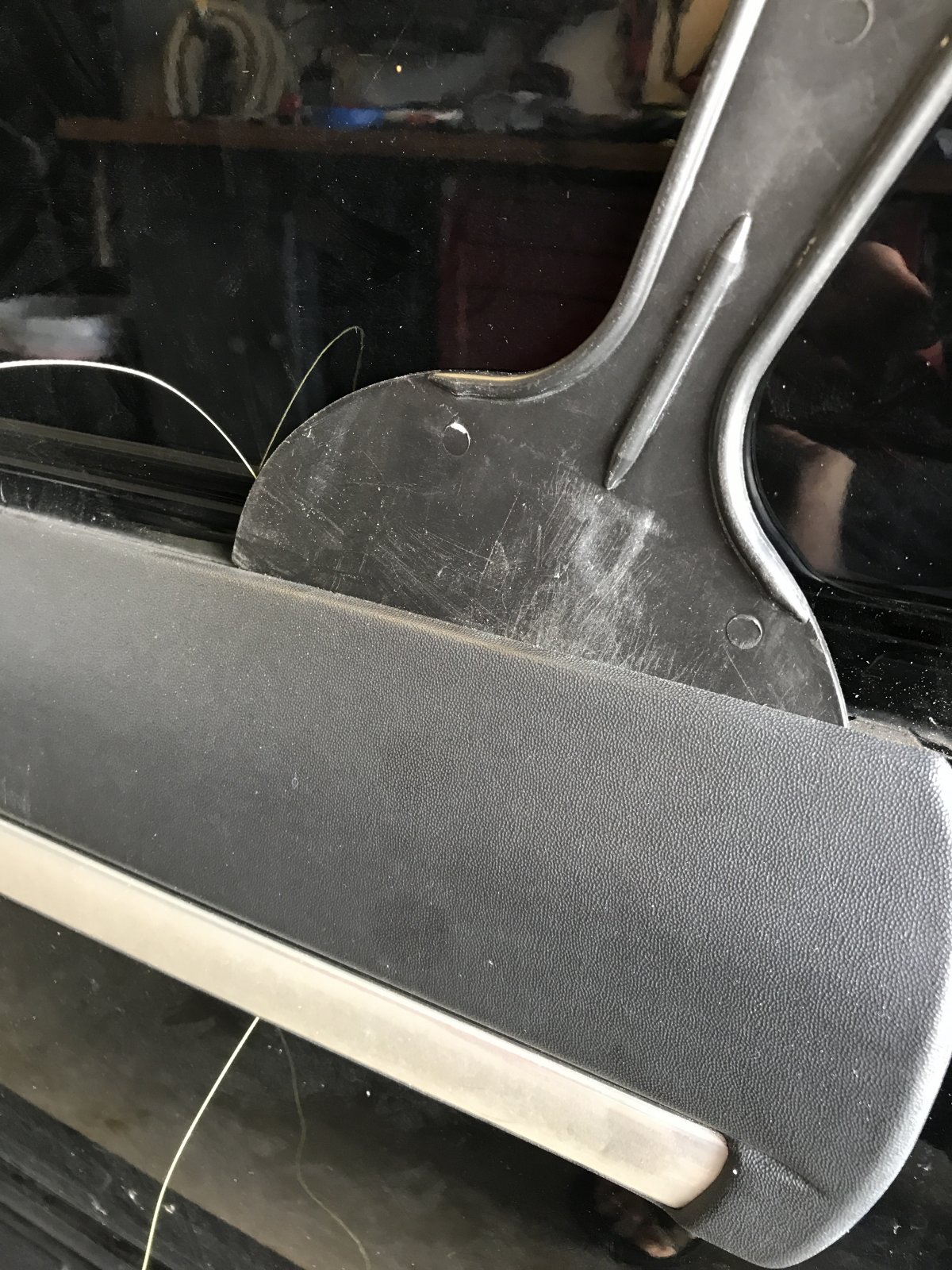

Used 40# braided fishing line here because the 20# was breaking too often. The top of the trim follows the curve into the body and the top strand will cut into the trim if you're not careful. I followed the separated trim with a plastic putty knife which gives a little space to keep the line out of the plastic (pic).

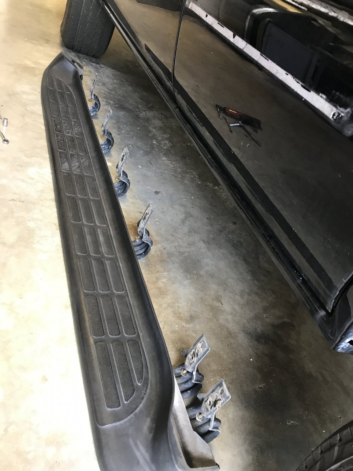

Running Board Removal

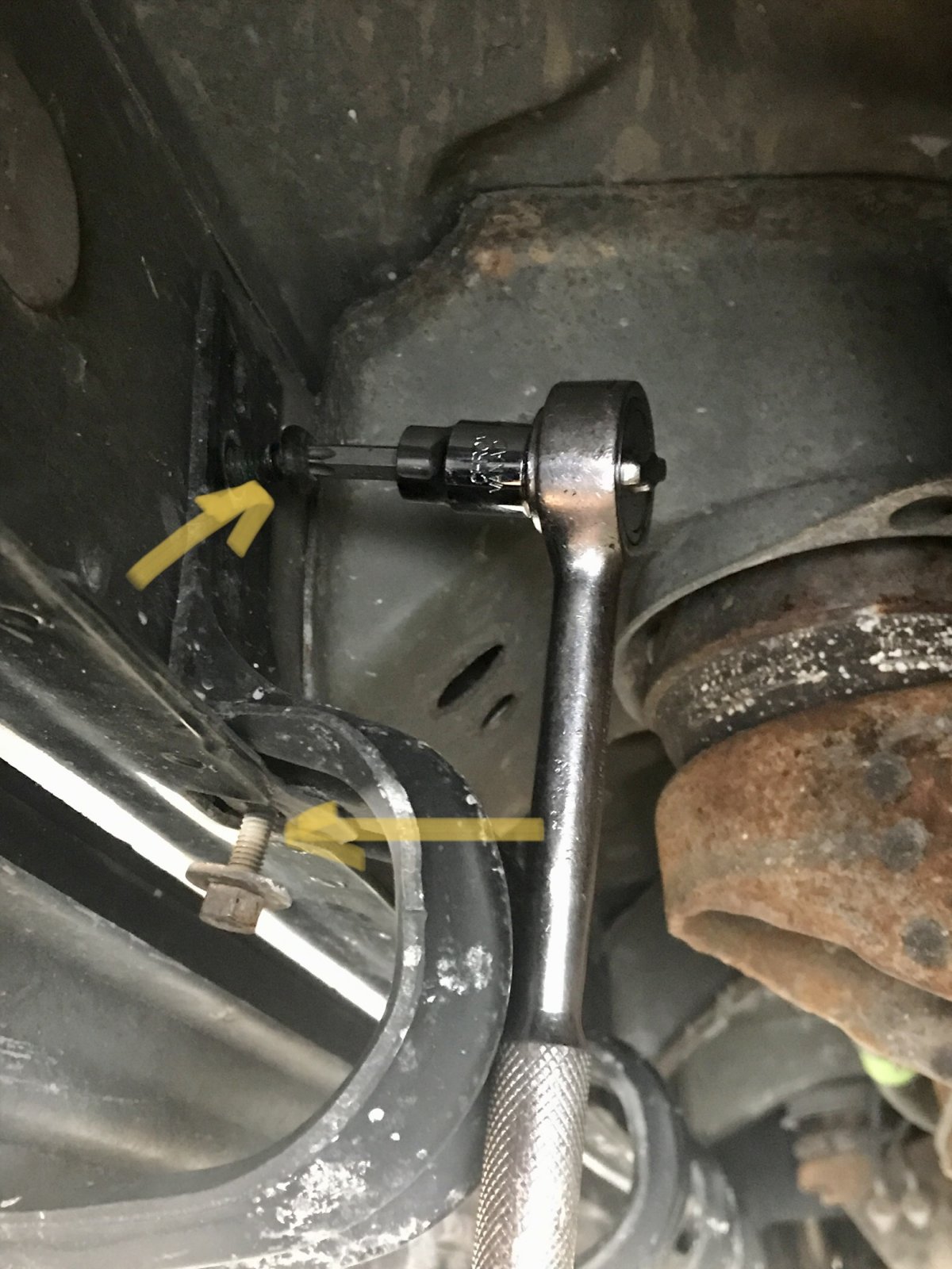

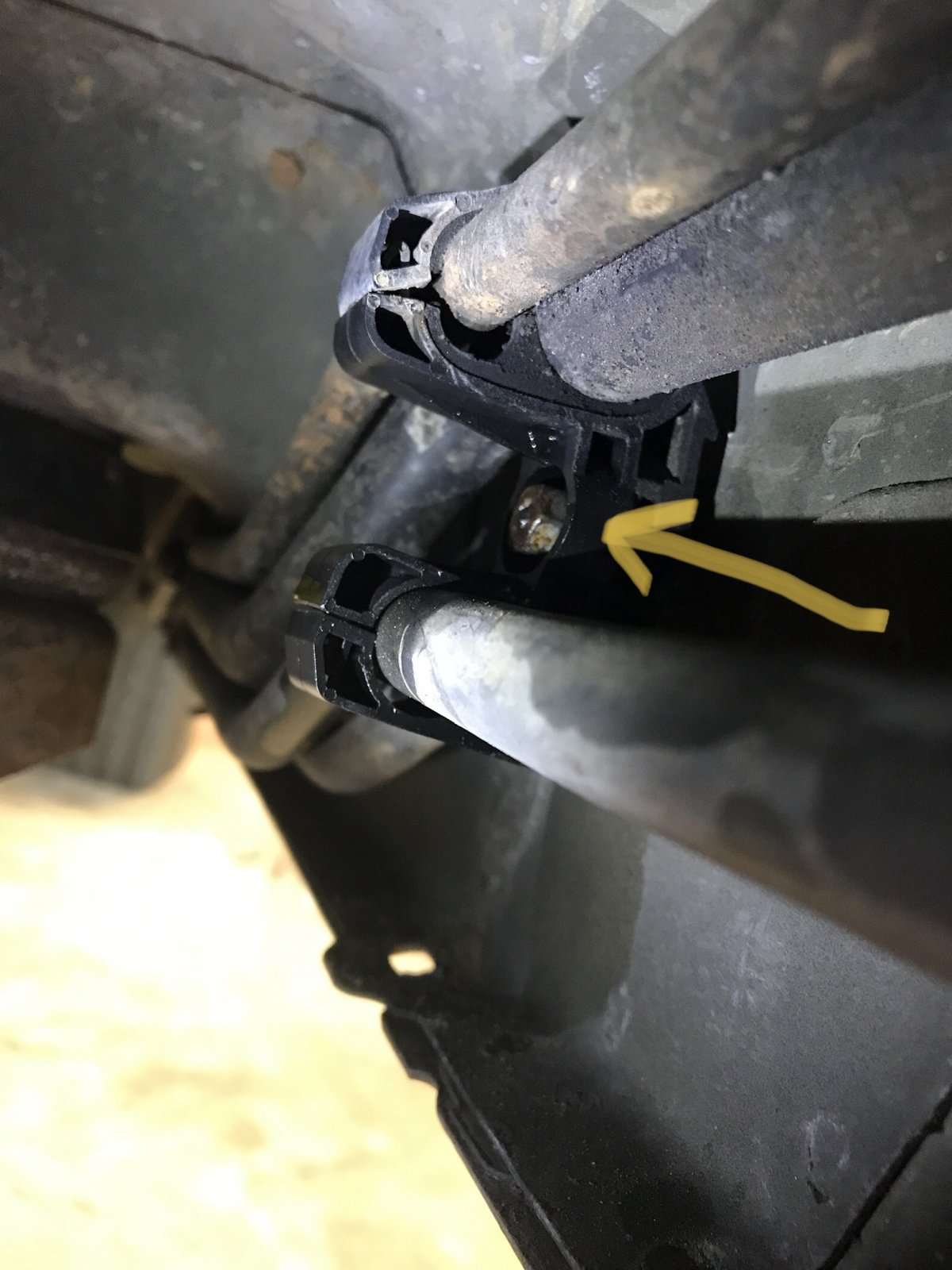

Left side was easy. Just 6 bolts underneath, 6 more on the inside of the body (pic with yellow arrows) panel, and one up front. The right side has Refrigerant lines for the rear AC that get in the way of the running board brackets. I just loosened the nuts on the refrigerant line mounts (pic with one arrow) and had enough movement to free the brackets.

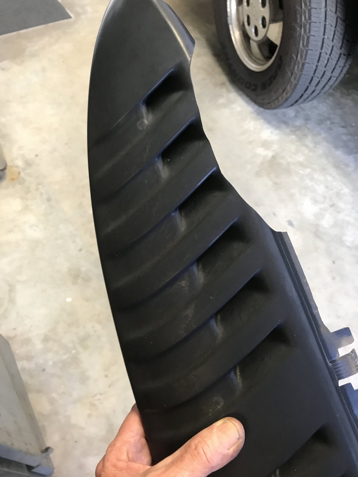

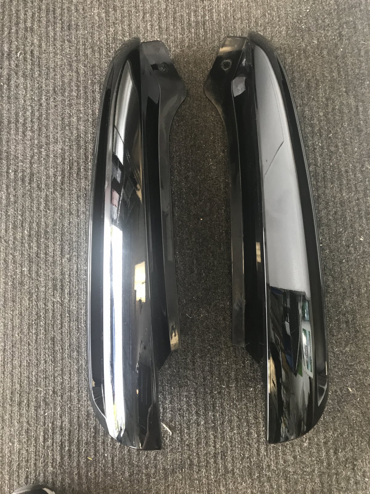

They are called (D-pillar) appliques; remove them while it's nice and warm out, maybe after they've been sitting in the sun for a while. Working on plastic in the cold is not a good idea.
Oops! They were very brittle. Oh well, looks like I will have new ones.

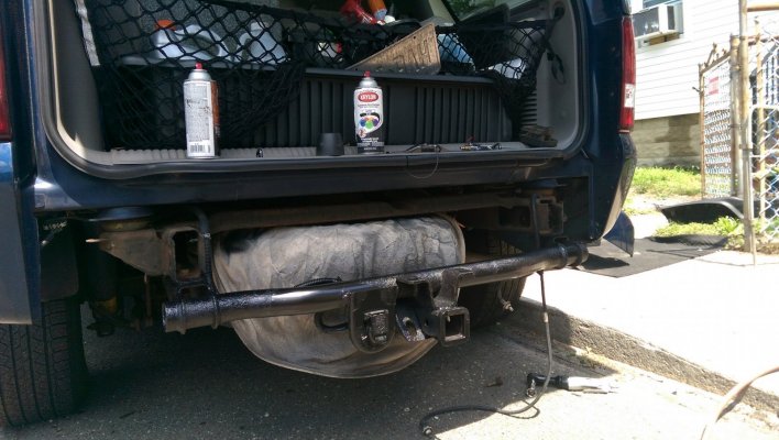

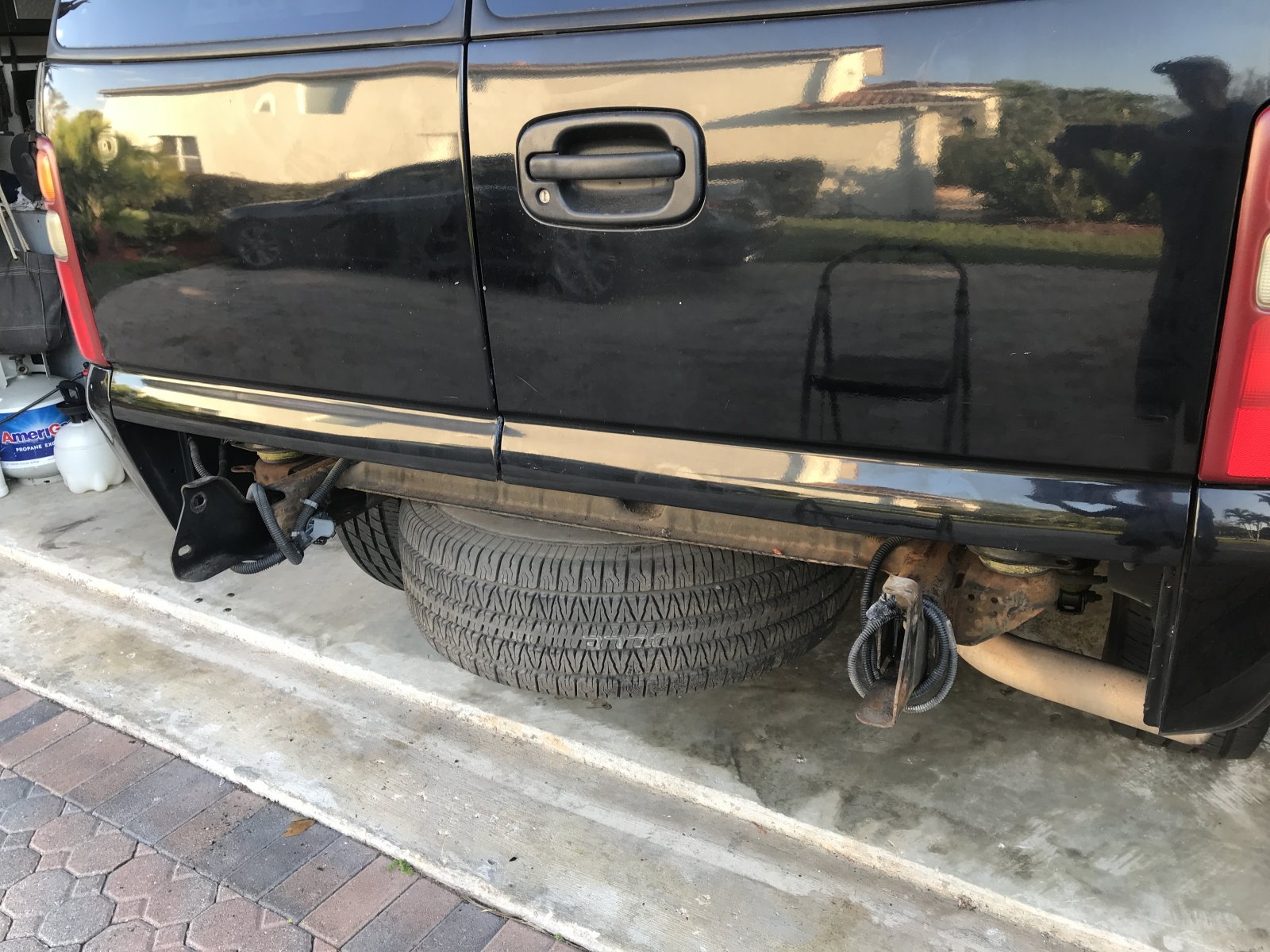

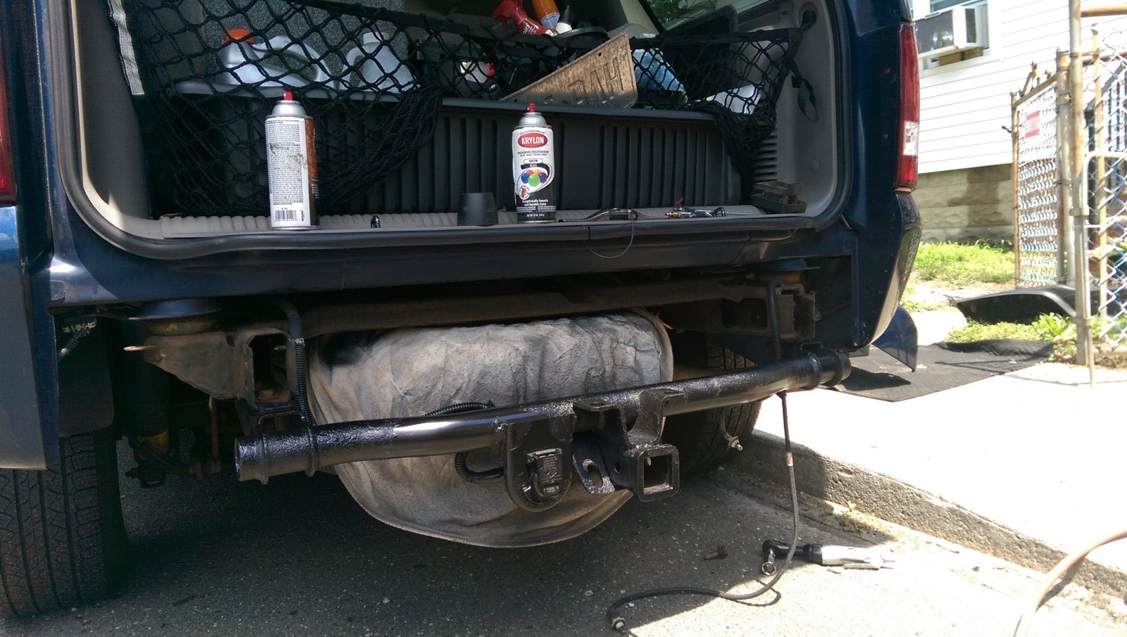

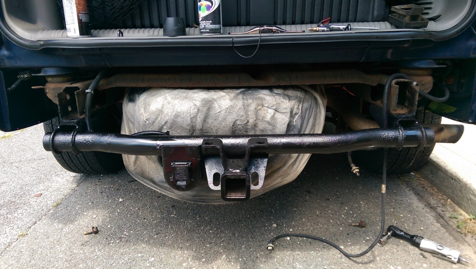

It's off. No big deal. Had to remove hitch first. Also realized you have to open barn doors to get it high enough to work it off.

I didn't need to remove my hitch 1st on my 03, but I have the rear hatch. I wonder if that's why.IMAG0086.jpgIMAG0087.jpg

I didn't need to remove my hitch 1st on my 03, but I have the rear hatch. I wonder if that's why.View attachment 359286View attachment 359287
I see now. I first unbolted the hitch from the frame thinking it would come off with the bumper but because the hitch bracket was still under the frame the combo wouldn't lift up. I then took the hitch off at those two bolts in the center. Makes sense. Thanks.

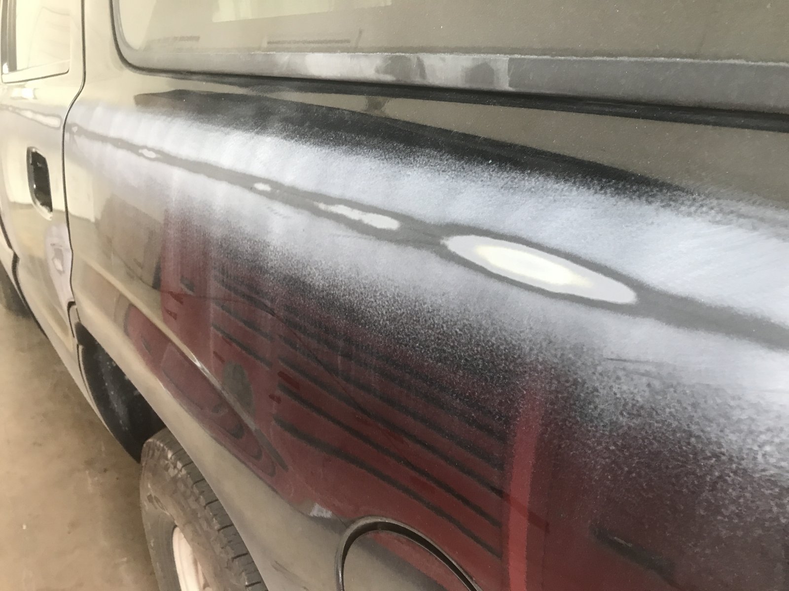

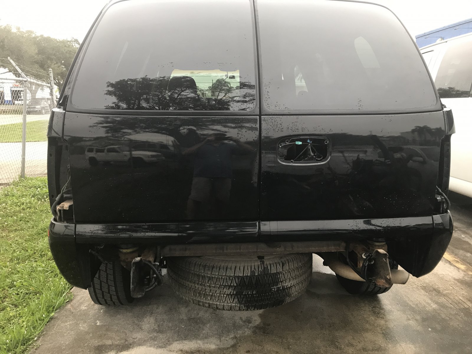

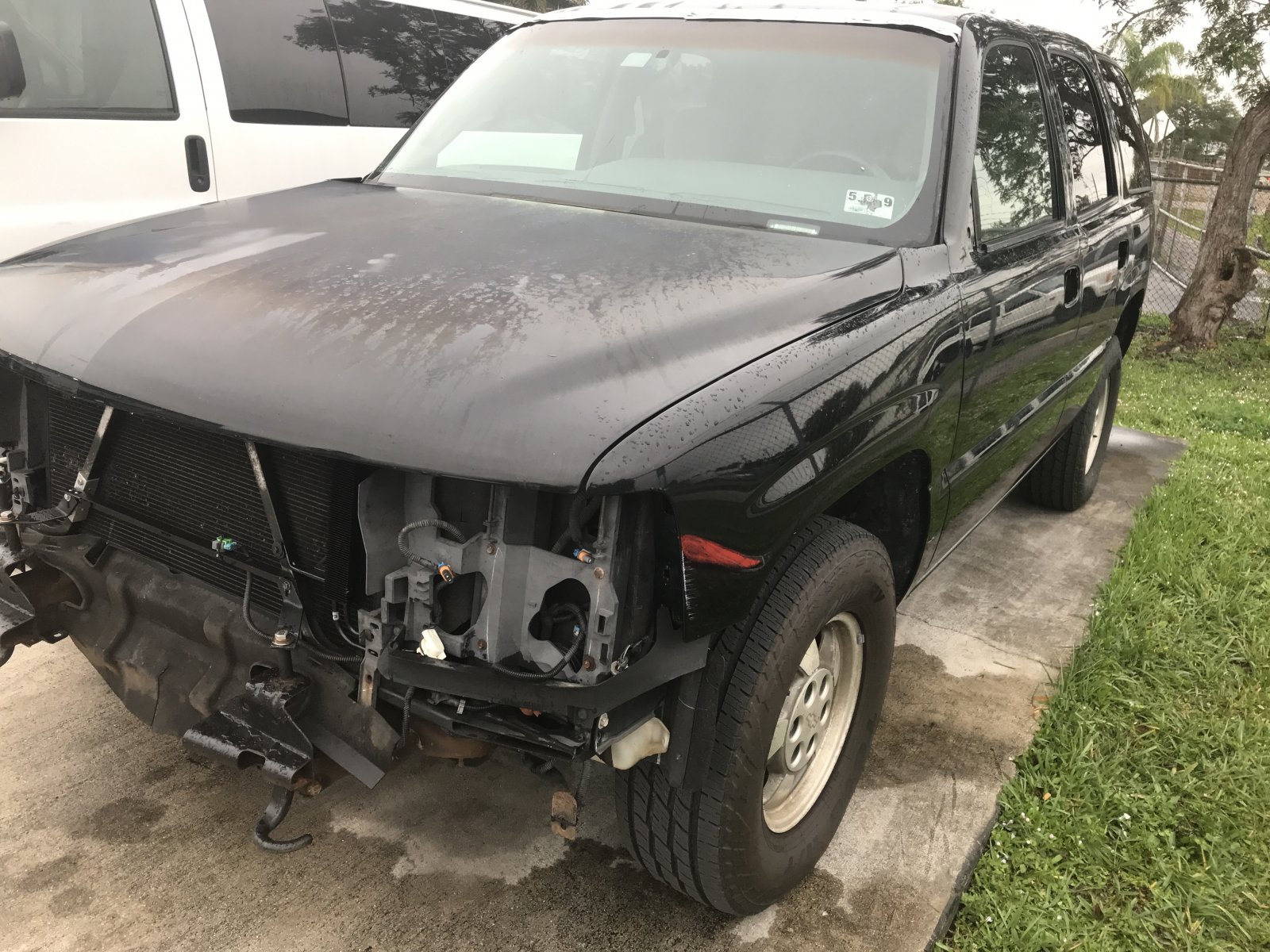

All parts removed and it's at the Paint shop.
Since we were wondering about the shop quality at $6K cost, I asked the owner about the process. He said they fix all rust, dents, and scratches then prime all bare metal. The primed areas and the rest of the "good" paint is sanded before painting. They use 3 coats of black base coat (BASF Urathane) and 2 layers of clear coat. The painting is done in a 95 degree temperature controlled booth. The finish is then baked at 150 degrees for some time.
I'm looking forward to seeing it in a week or two.

D Pillar Trim
Found a set of black Escalade D Pillar Trim pieces on eBay. They were in good shape with all the clips in place. The clear coat was starting to peel near the edges so I took them to the paint shop to have repainted when they paint the Tahoe. (pic)

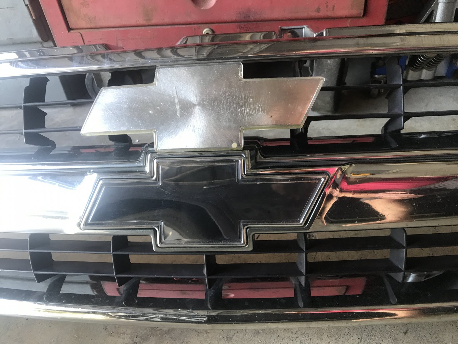

Replaced the grill bow tie with a metal one from Amazon. The original one is contoured and the new one is flat, but fits in the recess just fine. (old & installed new one in pic)

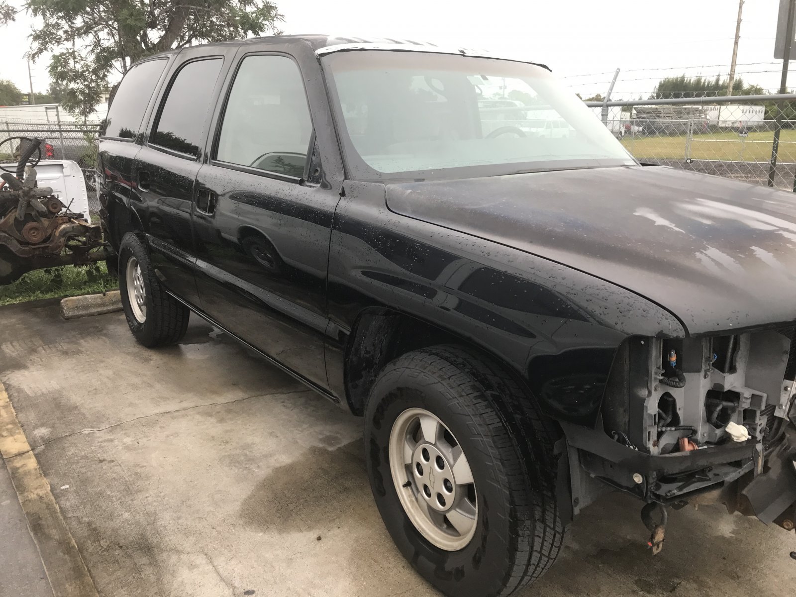

106

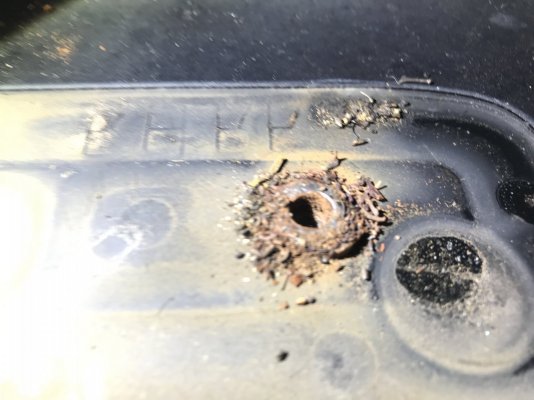

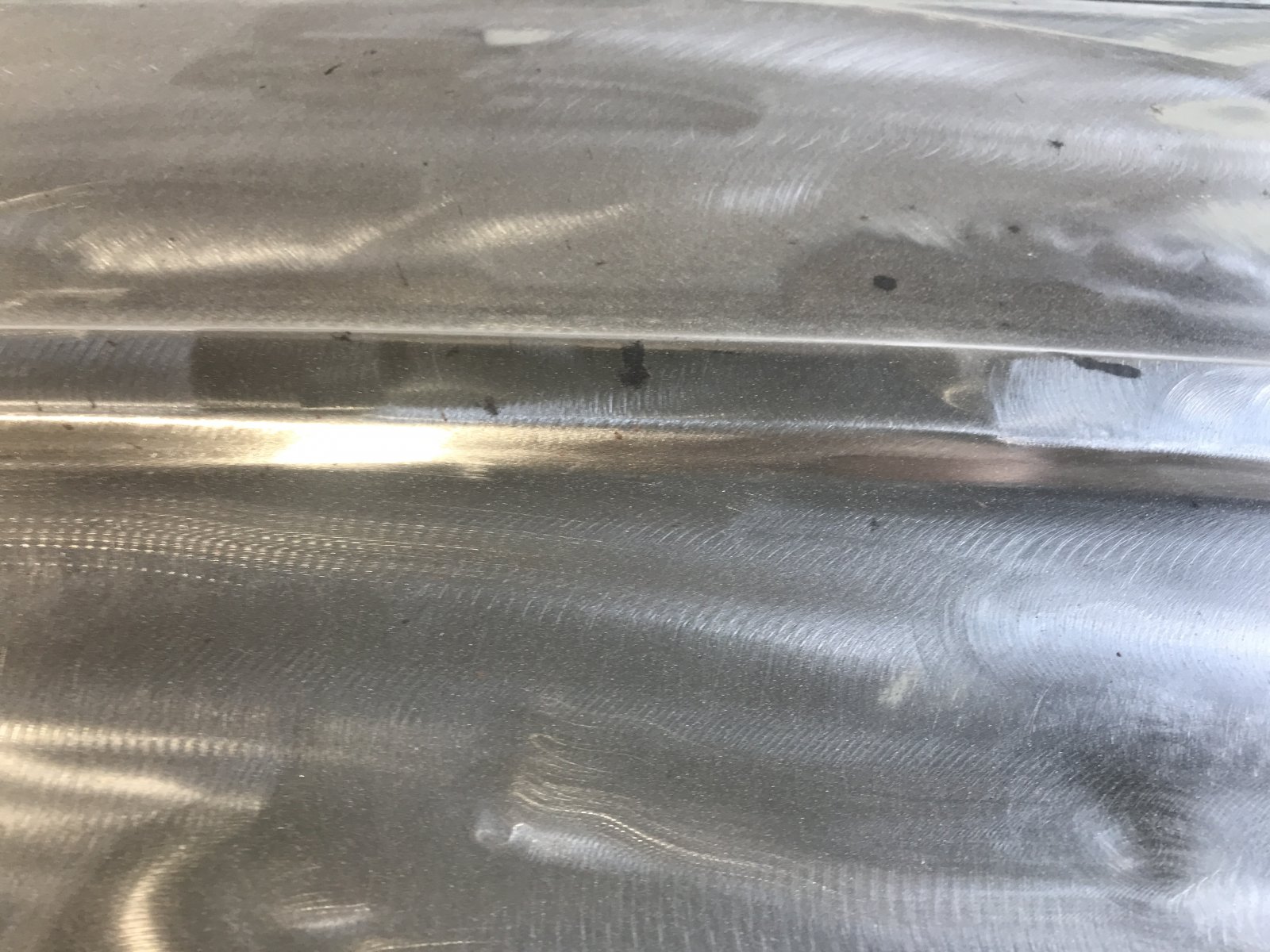

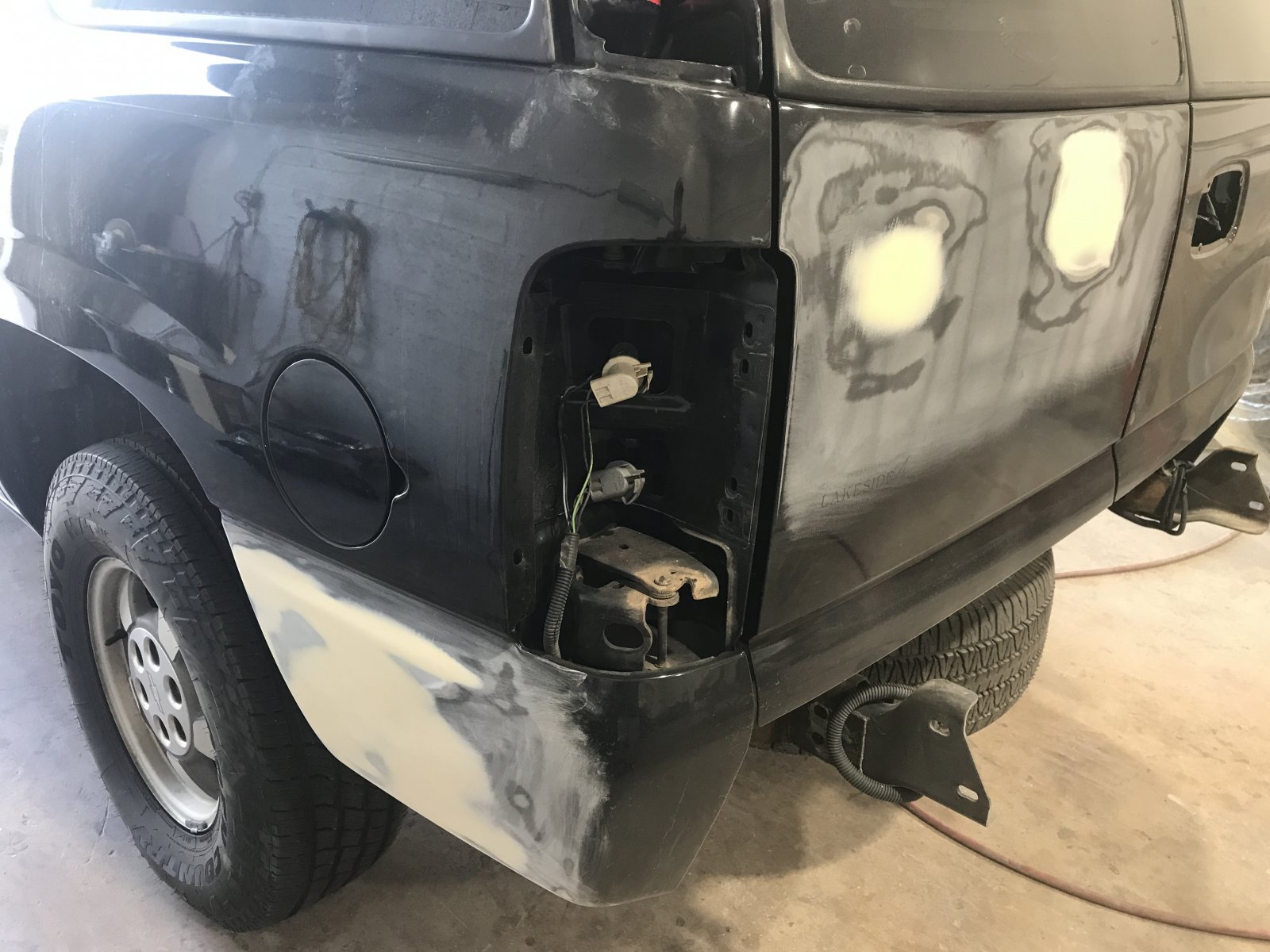

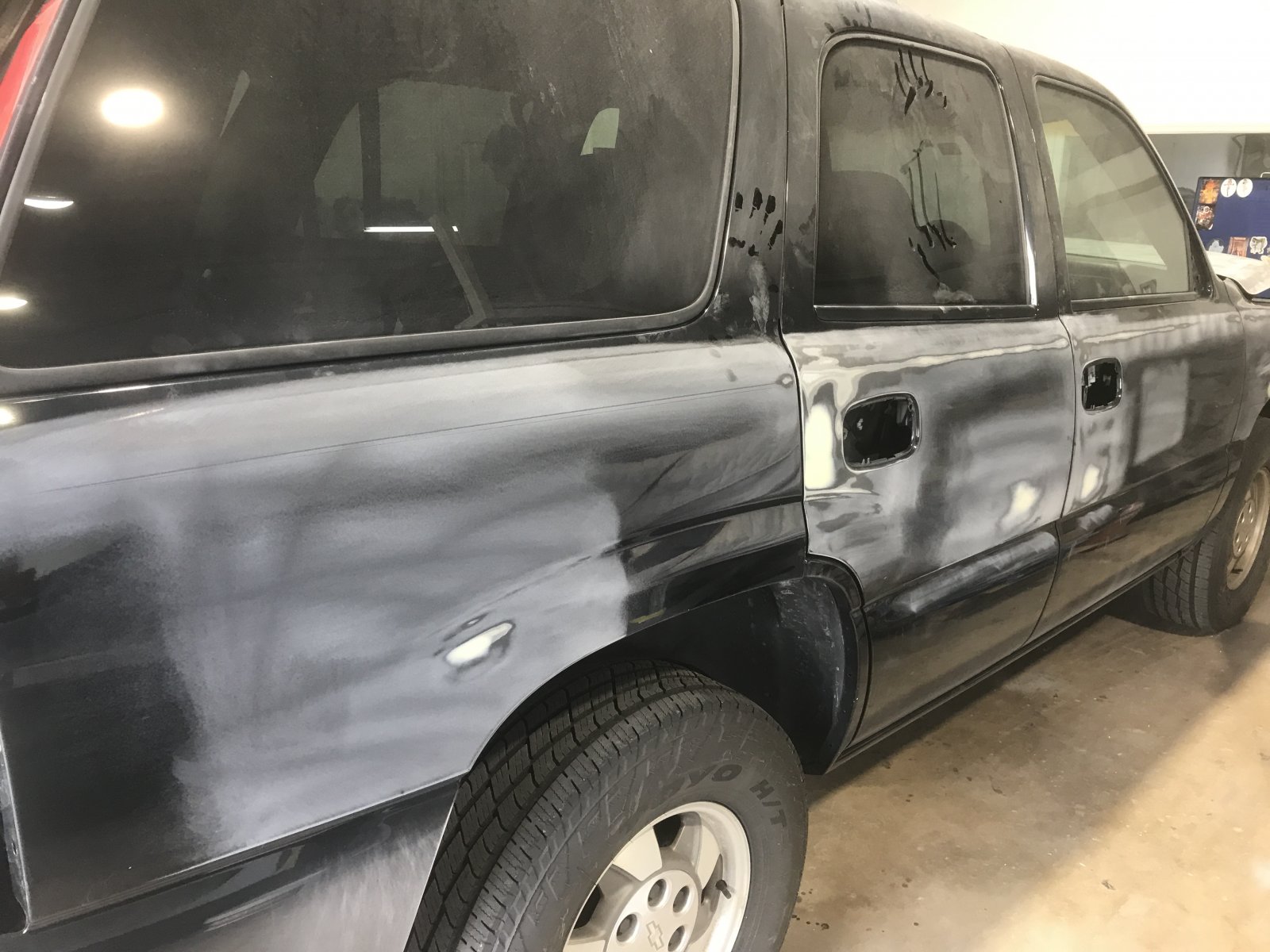

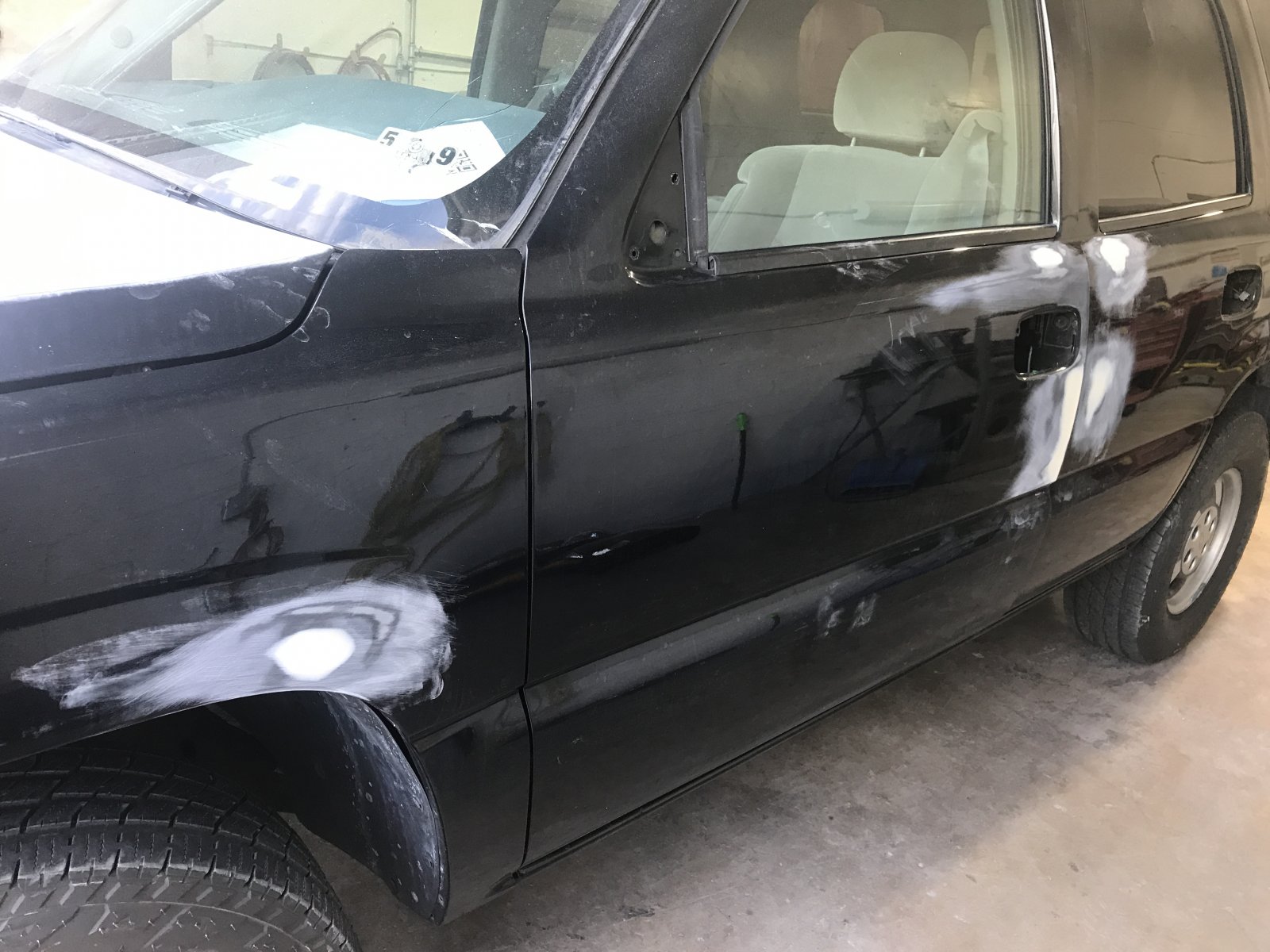

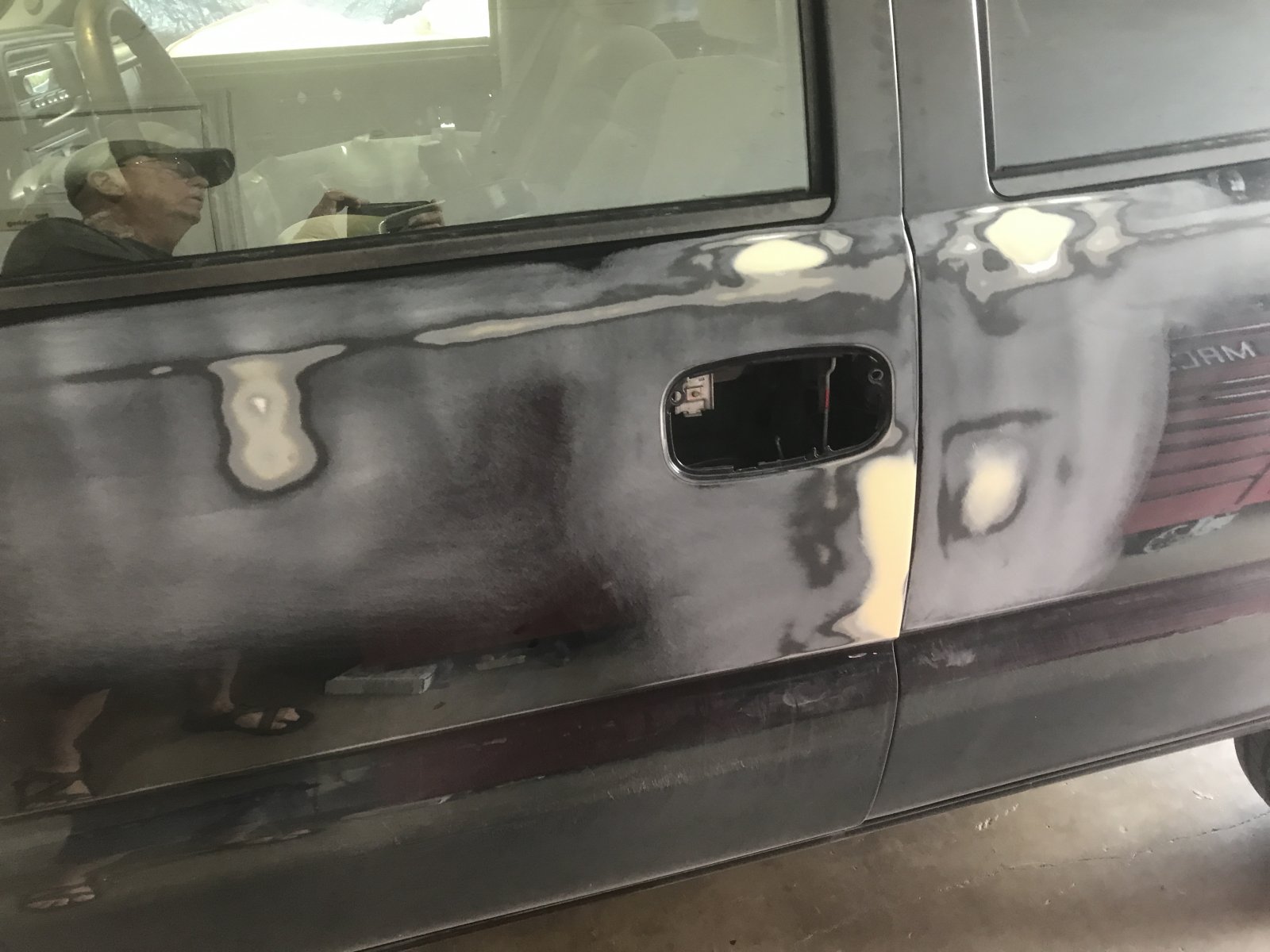

Took some pics at the body shop. Notice the tan spots on the roof (1st pic). It's not flaky rust like the ones on the surface. They said it's imbeded rust in the metal. They will probably bubble up in the future. It may take 1 year or may last 10 years. Options - 1. Chase all of them through and make patch repairs. 2. Replace the entire roof or 3. Epoxy over them and see how long they last. Option 1 & 2 are way too expensive. We're going with 3 and will just have to do spot repairs if they surface.
What would the epoxy cost to redo it all?
I visited the shop today and asked about the epoxy application. They are planning on applying epoxy to the entire roof. Thanks for asking and prompting me to check.

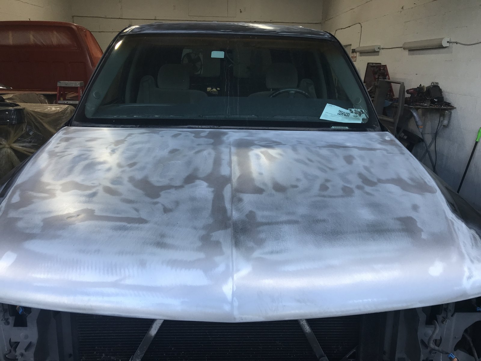

Visited the shop today. Pics of progress.

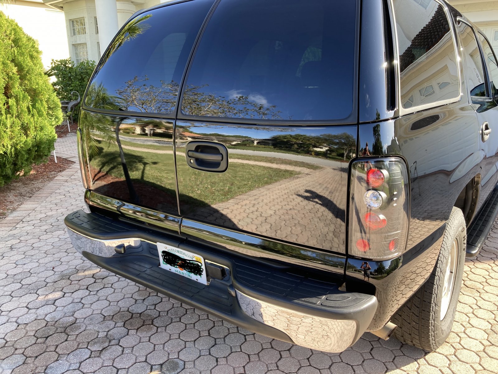

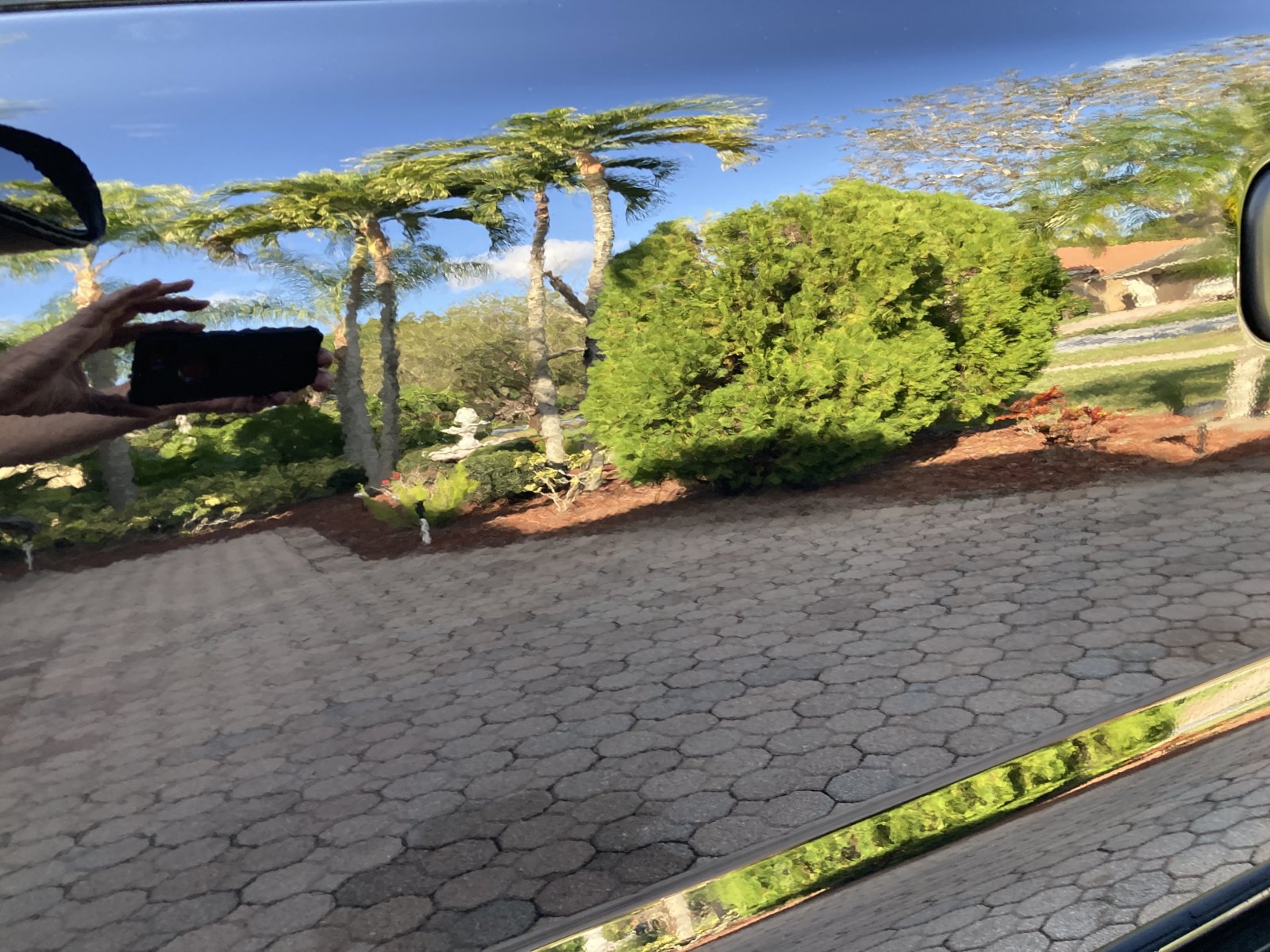

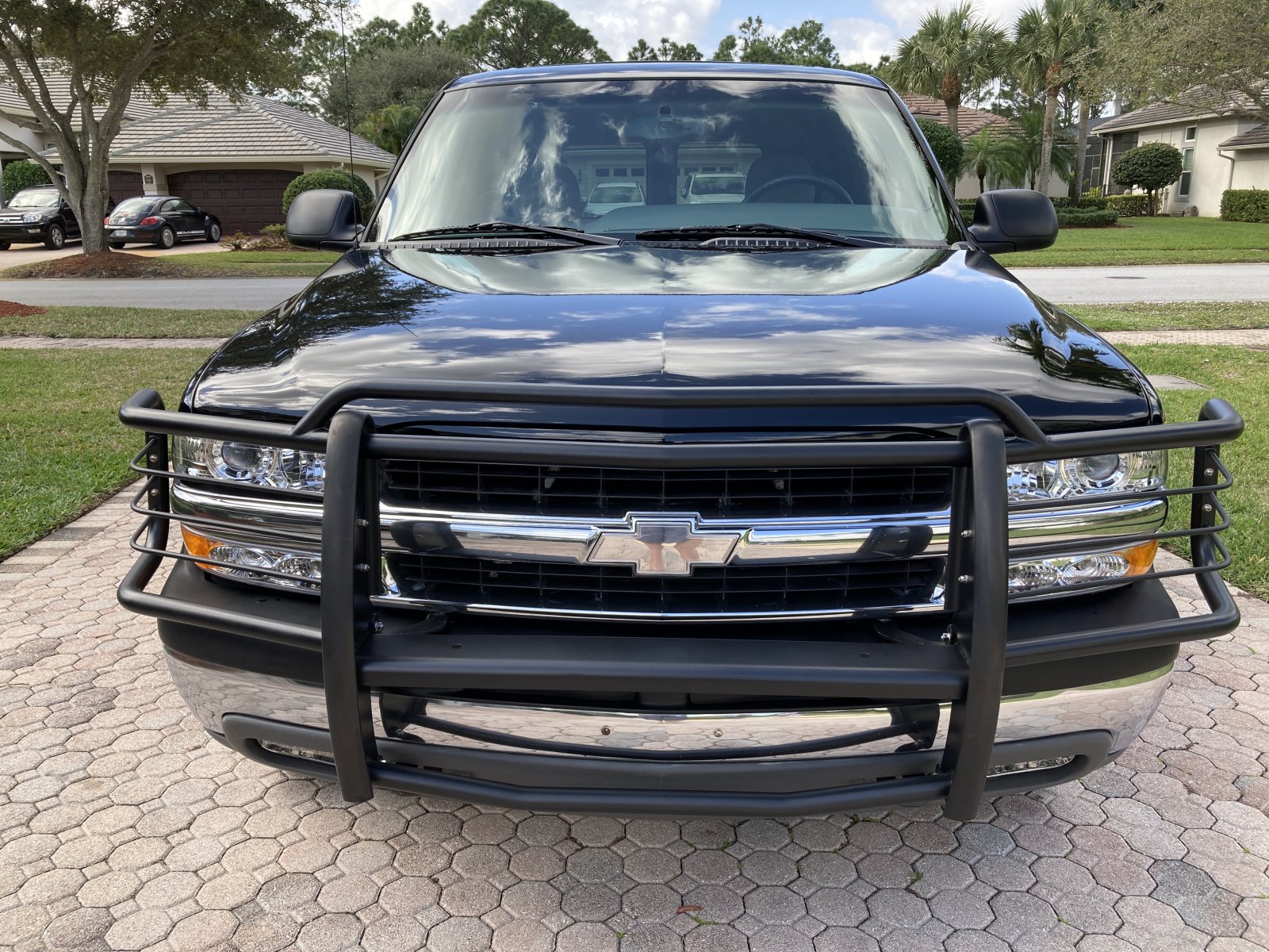

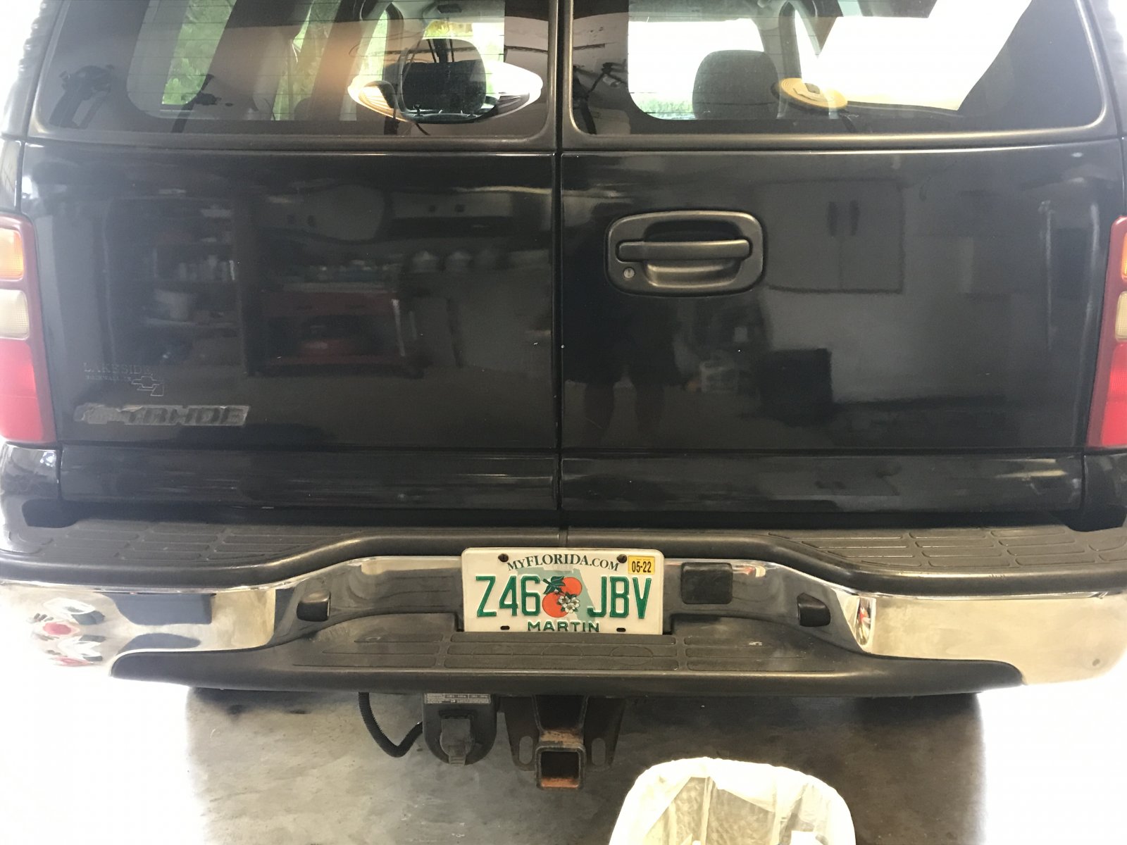

It's painted and back together! I'm pretty happy. Every exterior light has been replaced down to tag lights. Next, will be some inside improvements like a head unit with back up camera and car play.
