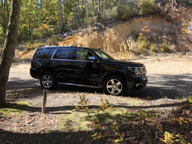

Hi all.
I just bought a 2015 Tahoe LTZ for my wife, we have 5 kids between us and it was a great vehicle in regards to size, features, and price.
I got a high mileage one, 104k on the clock, but it's in great shape in and out. Got it for about 7k below KBB due to it having a dirty carfax(front/rear collision but airbags did not deploy, I checked it on lift there was no frame damage). That's the main reason I was able to afford the 2015, was looking at 2013 but the 2015 was just another level.
Anyway, wife loves it but here are some "issues" I'm having with it.
1)I tested all the features and they all work but for the life of me I can't get the frontal collision alert to go off. It's supposed to put a red light on the windshield and vibrate the seat. That being said I can't try to run someone off the road to test it. Any way to test this? I can tell you the car icon in the dash works(green and yellow car) and the vibrating seat works for everything else. Also the lane assist is working properly so I know the actual sensors should be working.
2)Being a MA car, it has some surface rust. I knew about it before I bought but for 26k this truck was a steal. I am debating to take it to a body shop to sand blast and repaint the undercarriage. Or I was going to wire wheel it and POR15 it all(did that on my 2006 F150) Here are some pics. Is this necessary or it looks OK as is? There are no rust holes or flaking, just rust color and some undercoating is peeling off. It can't be getting better though. I plan to run this truck into the ground, 200k miles I think.
