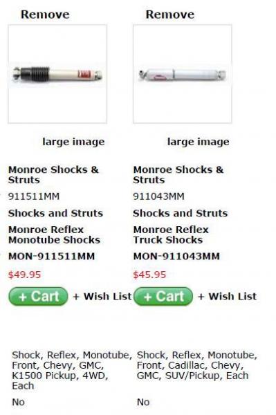

98 Tahoe added a leaf at the rear to help with the towing, running 285/70/16. i need new shocks now and am at cross roads. I use this only for occasional weekend driving / towing and is not the DD. Hence, do not want to break the bank for this. That been said i need to know if the following Sensa trac are ok for the Tahoe given the extra leaf and the tire choice.
Monroe Sensa trac
37130 Front
37086 Rear
The Monroe site recommends 'Reflex'
911043 for front
911511 for rear
Please advise.
thanks in advance

Is your rig 4wd or 2wd?
If your gonna use reflex for the fronts;
If it's 4wd, then use part# 911511 for the fronts.
If it's 2wd, then use part# 911043 for the fronts.
See this thread.
See this chart;
As for the rears, my Sensitraks are still running good after about a year or so.
