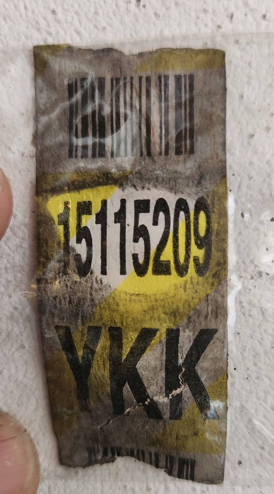

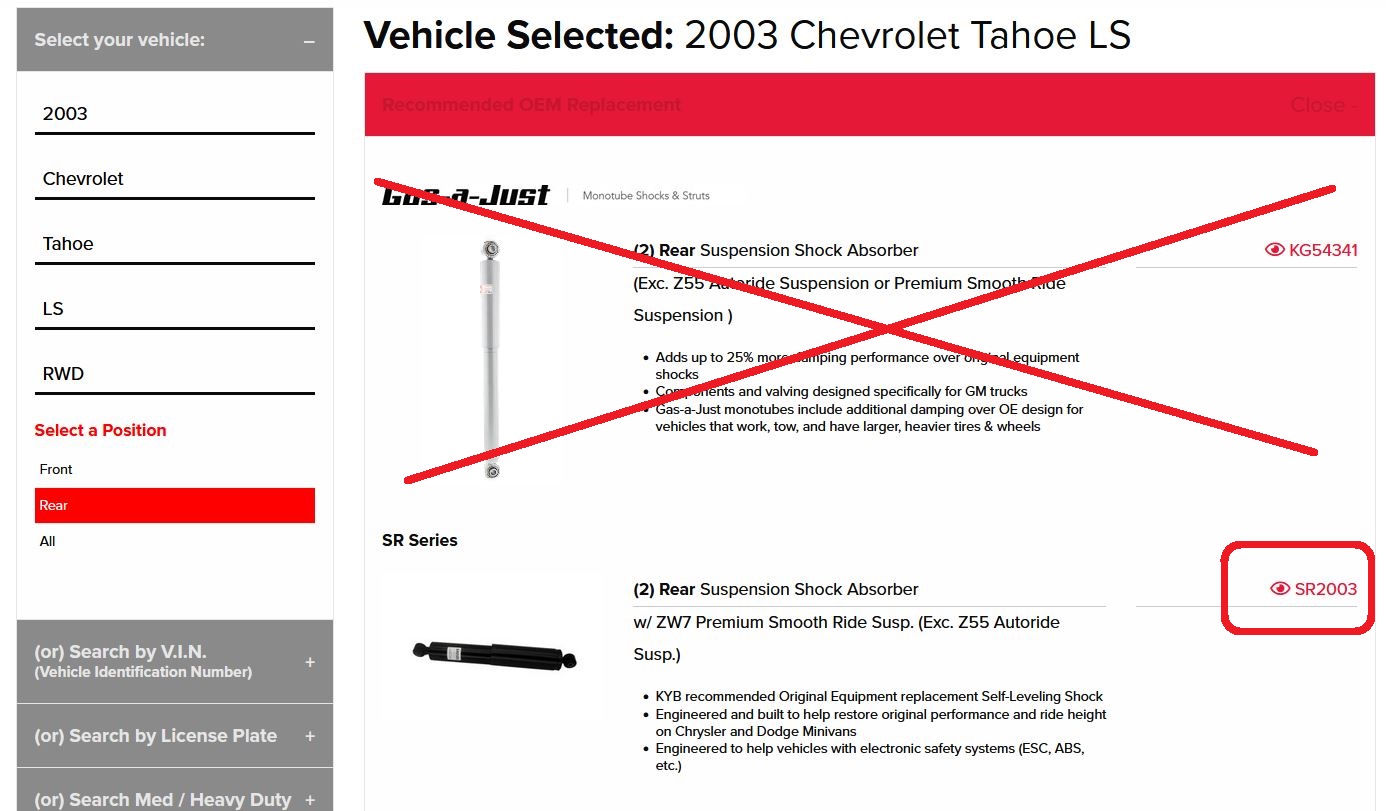

I still have the OEM stickers on the springs. Matched for the " ZW7 - Premium shocks" NOT self leveling, so the springs are a tad stiffer, than the 'self adjusting' shocks. ( self-adjusting shocks support more, requiring a softer spring)From the www.kyb.com/catalog:
For anything, stay away from the Excel-G shocks -- get the Gas-a-Just or better.

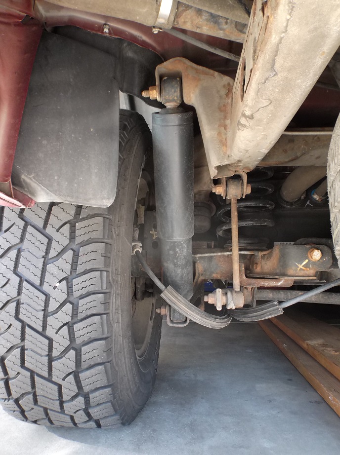

How long have you had this SUV, and can you tell if the PSR shocks in the rear were converted to standard shocks? That conversion can be done if the rear coil springs are done at the same time.

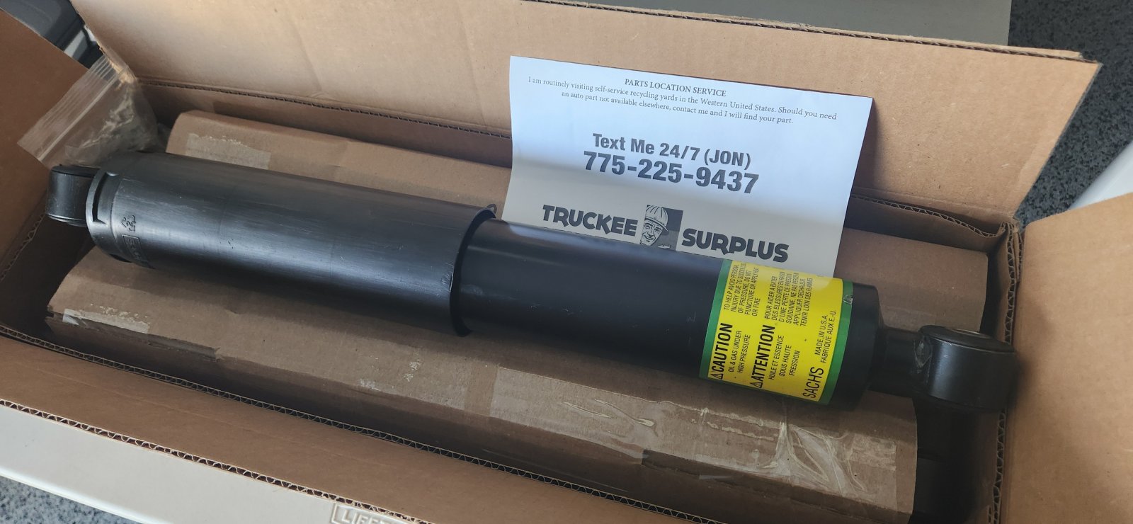

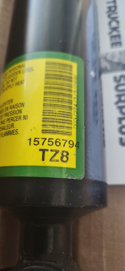

Rock Auto has the PSR Nivomat replacement shocks under the GM Genuine and KYB brands.

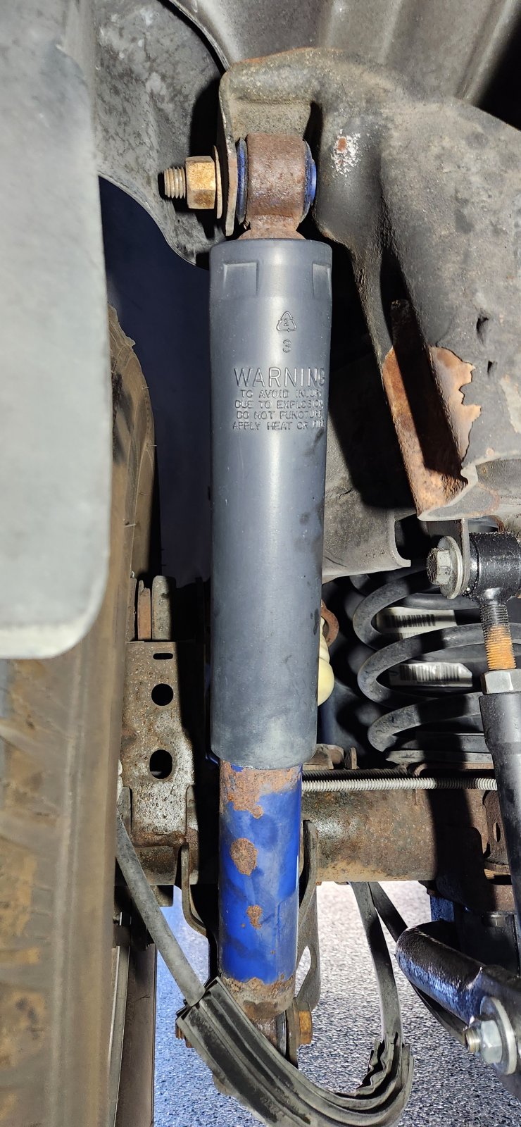

What do your current shocks look like, and do the springs still have the tags on them? Here's what the OE Nivomat shocks look like. They're quite a bit fatter (more girth) than standard shocks.
My shocks are the OEM 'blue' color. They just have 175,000 miles on them, so I figured, new - same "should" perform better than old.
Edit.... The sticker on the springs shows the part number and then, below, that 'designation' (?) "YKK" seems to be on a few different springs.....
