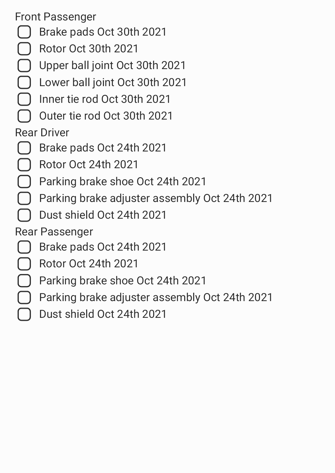

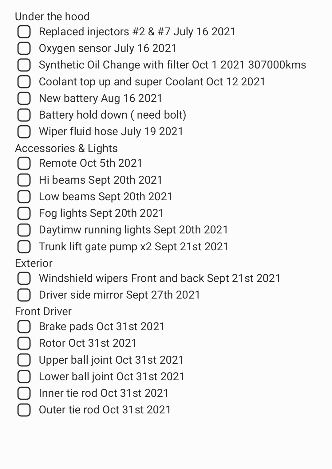

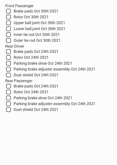

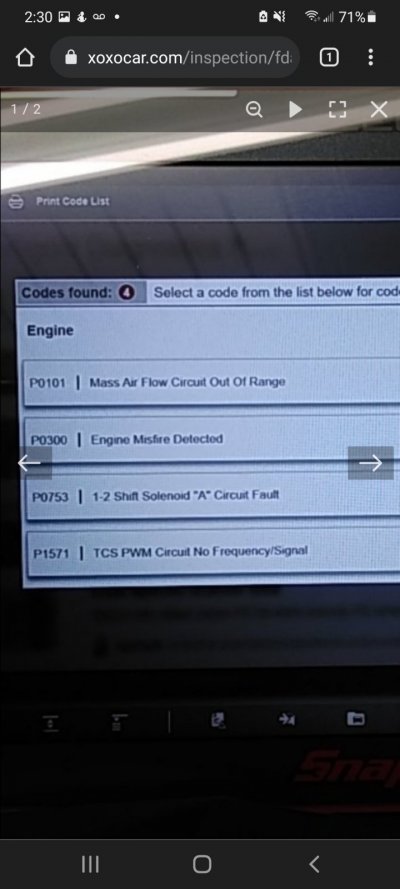

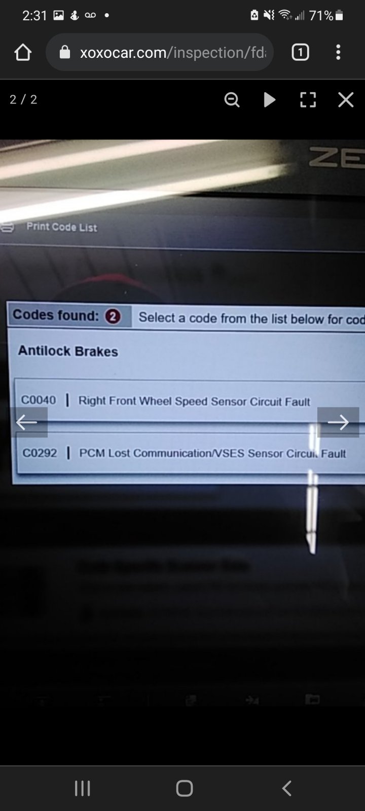

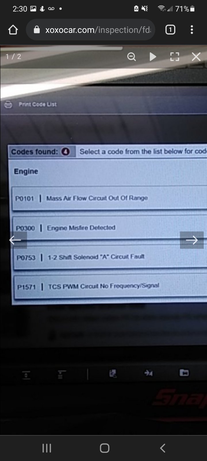

Hi I'm looking for advice on what I should be doing do this yukon to bring its maintenance back up to date, I purchased this yukon a year ago finally getting the funds about 6 months ago to start working on it and getting it drivable, I had the transmission swapped with a rebuilt one on Sept 9th 2021, the shop just found out my check engine light is not working ( this was working before ) so after I received the truck with the transmission I drove it and did not know the vehicle was sending codes, it drove fine but the shop found out it was only using 2nd gear and 3rd gear, the guy I bought the transmission from says it could be the solenoid or an electrical issue somewhere else and the shop also found that my starter solenoid is starting to get stuck and not disengage, my wheel bearing sensor might be faulty (causing traction active to come on), my belt and fan clutch are old, which was causing a grinding type squeal

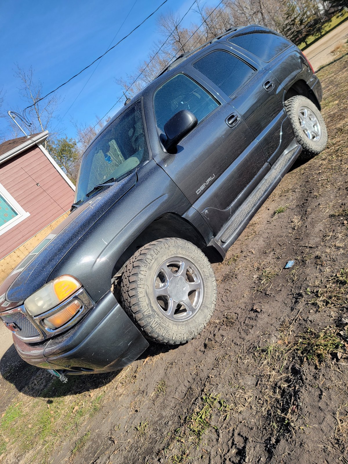

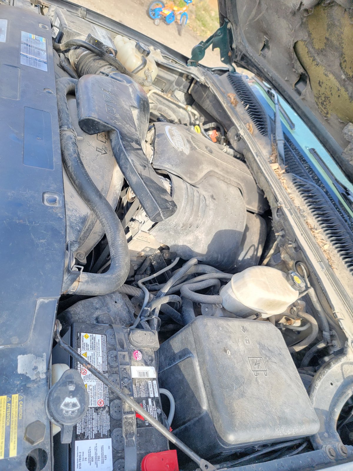

Thank you very much for the welcoming, I plan to participate and learn as much as I can from everyone, I'm very interested in these trucks I always wanted one and now I finally have one and everyone has some interesting and unique ideas here, I think I'm only going to read a couple of posts on the thread but then I'm reading the whole thing because it's so interesting what everyone has to say haha

Yes I do agree with you, the seats are so comfortable even in decent condition, can't wait to rebuild the seats to like new condition but it's been sitting since I found out a couple days ago my check engine light is not working and I have a p0753 but it drives fine, I was told it's only using 2nd and 3rd gear, but I don't want to risk ruining the transmission I put in it.

These rigs are known for ground problems. I would check all of them before thinking there is a problem with the trans.

I saw that plug hanging out of the grill. You must live somewhere very cold. If in the rust belt, then all grounds are essential to check and reseat.
As for the code for the 1-2 shift solenoid. They fail occasionally, so it could be that easy and they are not expensive. I want to say that you can even change that solenoid without removing the valve body, but someone will correct me if that's not true.

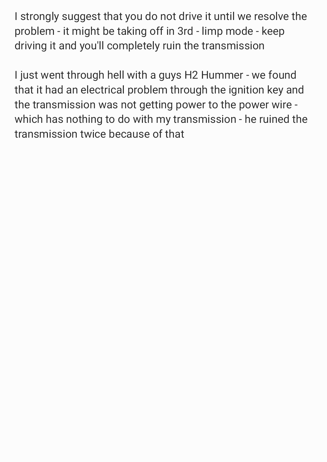

Yes I live in Canada haha very cold, but I bought a rebuilt 4l65e with a corvette servo, accumulator work, hardened sunshell, a rebuilt torque converter so since my engine light wasn't working I didn't know my transmission was sending a code till I took it in for an alignment and asked some questions.
I contacted the person I bought the transmission from he is very sure it's not his transmission that is causing the problems but I'm hoping it's only the solenoid or the harness if he didn't put a brand new one in, I would expect what you suggested would be the case if the vehicle had it's original transmission, the original was toast from previous owner

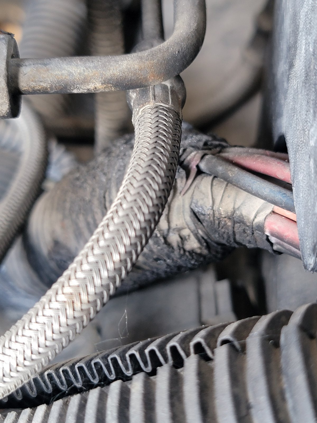

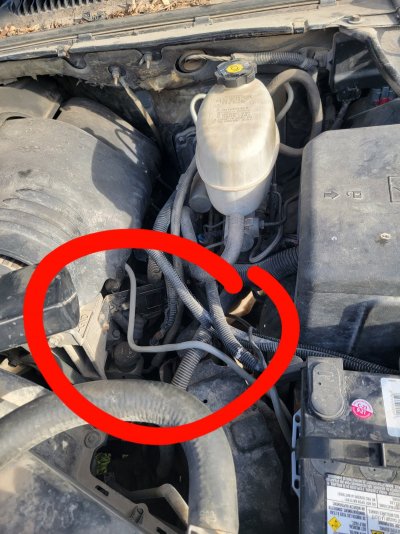

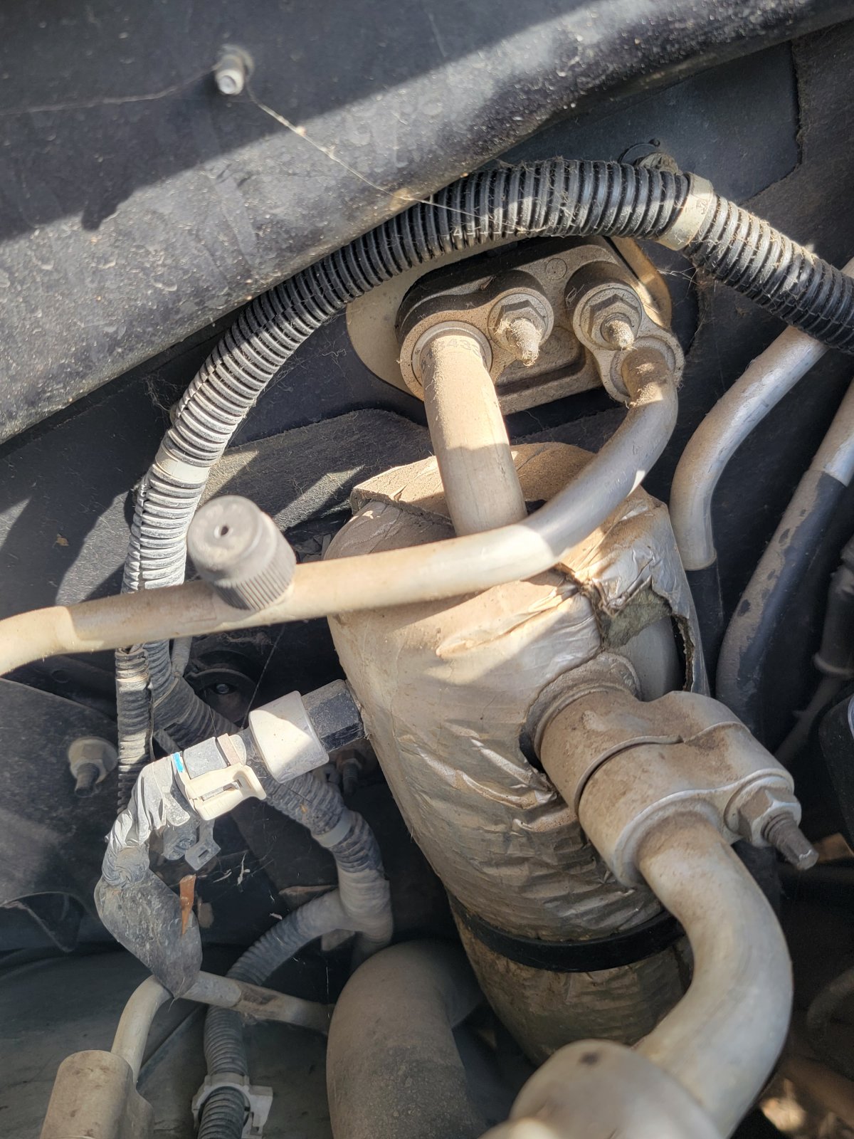

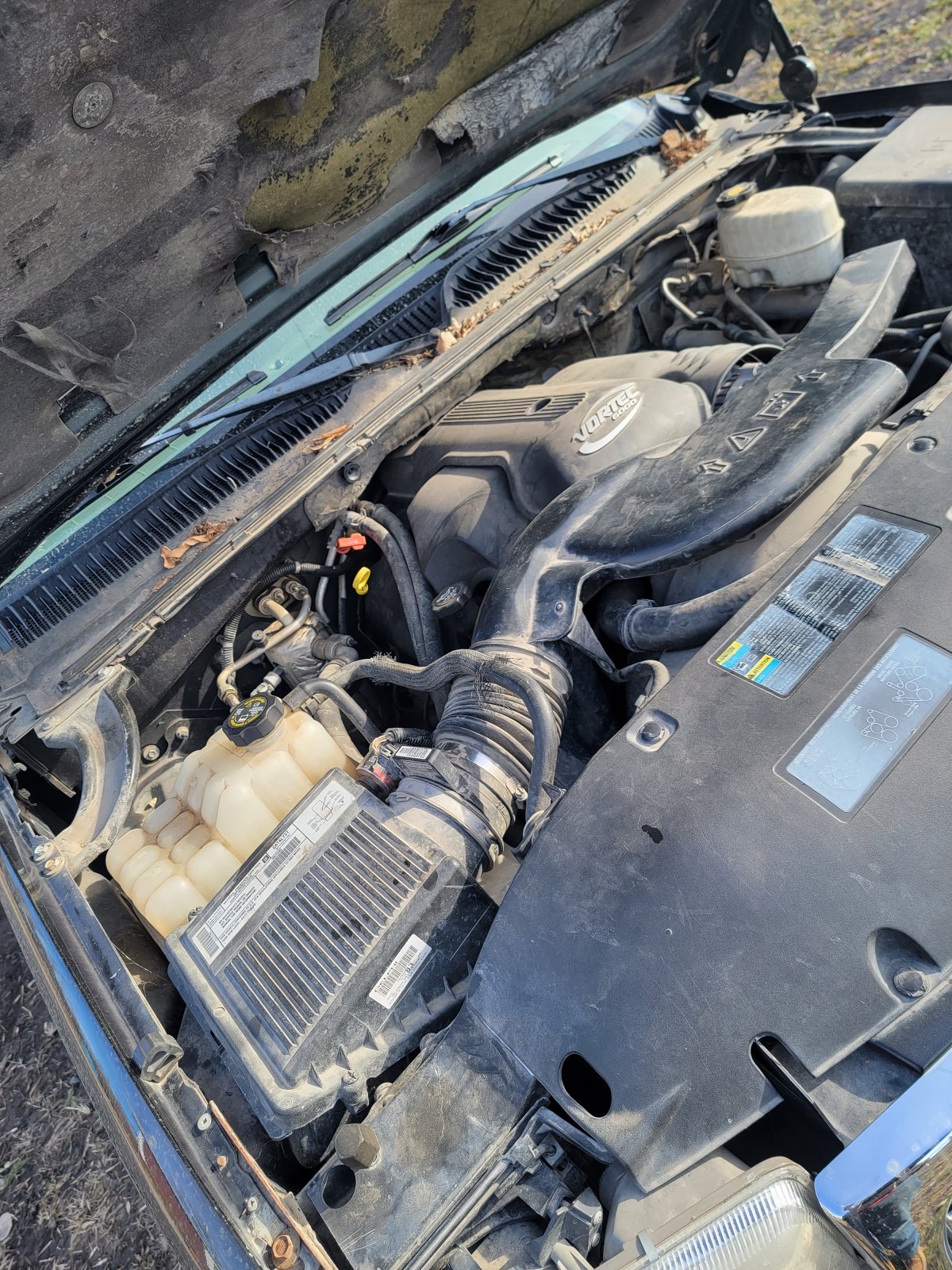

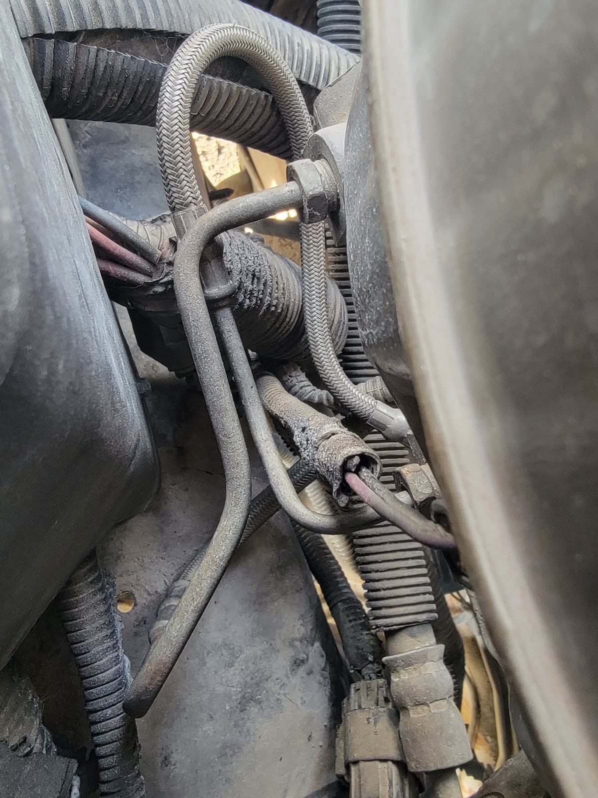

Could these areas be causing problems, they look pretty rough

PNWYukon
May 13, 2015
321
250
Olympia, WA
Hope you got a warranty from the transmission person. Going that deep into a transmissions rebuild, you would think valve body solenoids would have been replaced along with all the other springs, o-rings, seals.
"he is very sure it's not his transmission that is causing the problems",
Said every mechanic ever. No matter what he said the transmission is throwing codes and not shifting, that's a huge problem.

He is going to help me resolve the issue, he is sending me a solenoid first so I don't have to pull the transmission already, I'm just hoping he thought the solenoid was good enough but then stopped working, he said another transmission he sent for someone's Hummer had an electrical problem at the ignition and the transmission wasn't getting enough power and it went into limp mode and they fried it twice until they found that out but my shop said I have 2nd and 3rd gear, my temperatures were normal when i was driving around, just when I come to stops I'm starting in 2nd and my electrical problem seems to have my yukon trying to start itself
