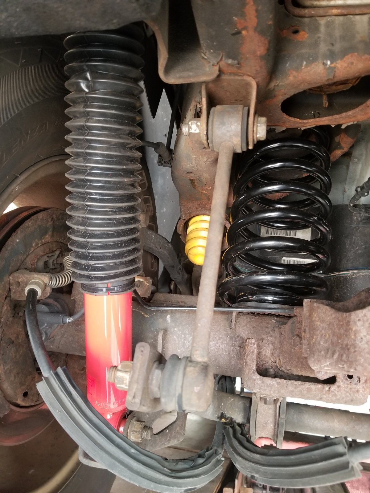

I finally found a lower mile family hauler but didn't quite do all my research..2006 Yukon XL Denali. Plan is to use it for camping and beach trips. After realizing this doesn't have a "true" 4wd system I'm starting to wonder if this will work or leave me stuck in the sand. For those of you who have had both systems is the AWD still decent? Plan is to put on 285/70/17 tires and finish off my front lift. So far did the Moog HD coils and KYB monomax shocks as the air ride had issues.

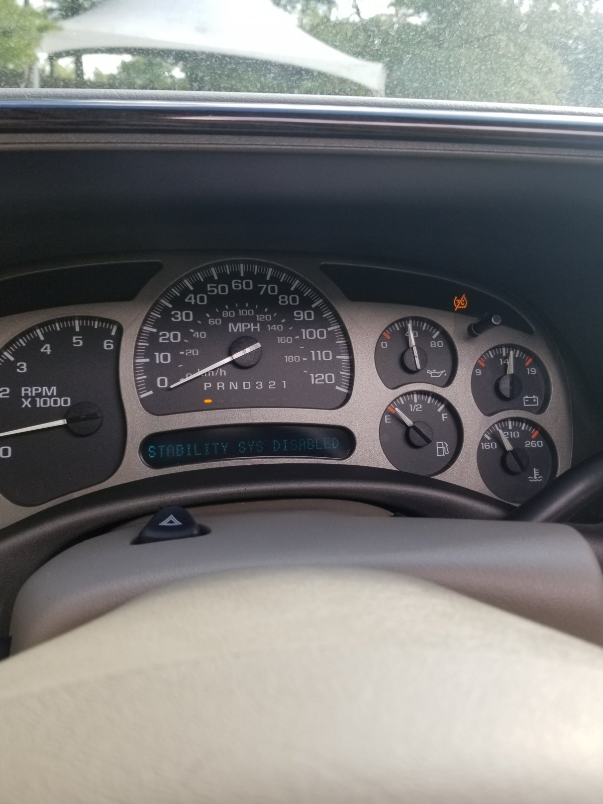

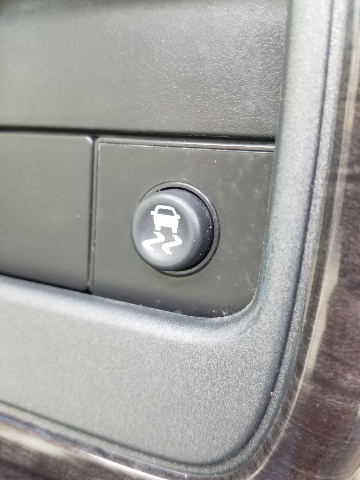

Ya I didn't seem to get lucky with the G80 option and I dont know if it actually has stabilitrak?..
That seems like a traction control button atleast, I think if there is stibilitrak there’s some way weird to disable it. My 01 does not have g80 traction control or stibilitrak and goes through a lot!
