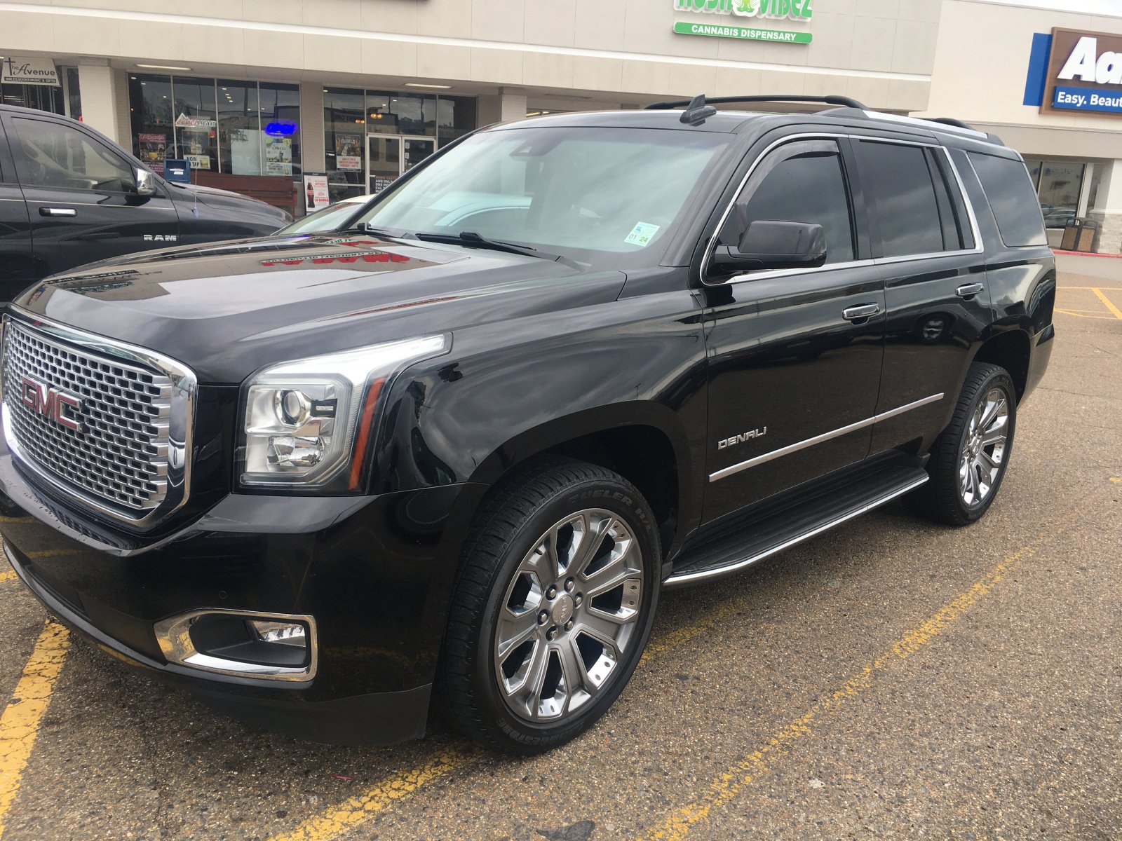

Just picked up a 16 Yukon Denali for a great deal and looking to deck it out. Thinking about putting a 2/4 drop on it with magnaride delete. Is this worth doing? Also wanting to put 24s on it but having a hard time deciding on 305/35/24 or 295/35/24 and if the 305s will rub etc. Honestly just looking for suggestions and do/donts. It has 22s on it now but would rather the 24s. I’ll keep the 22s to ride during our small winter.

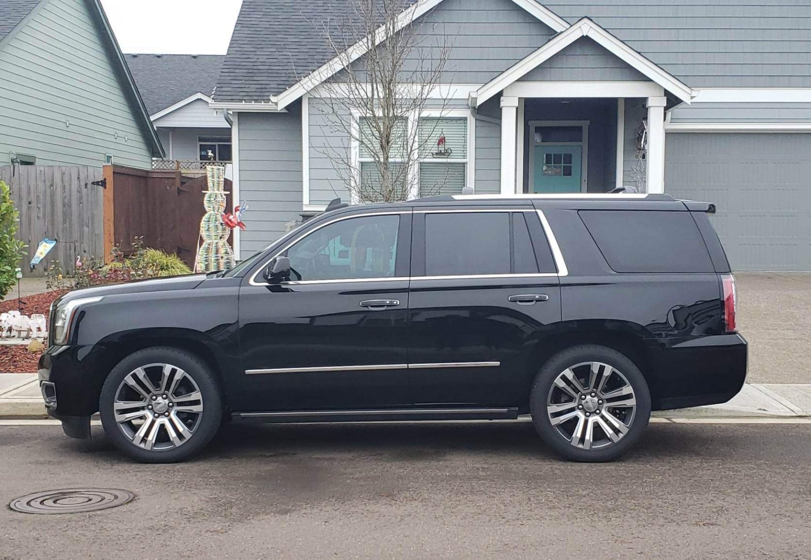

I have a 2018 with BellTech 2/3 drop + Hellwig swaybar. With 285/45/22 I rub a little up front on tight turns with and incline or decline. I would like to run 305s and still may. I ran 305s on my 2008 Avalanche with the BellTech 2/3 drop.
The drivability/handling with the drop + Hellwig swaybars is fantastic.
