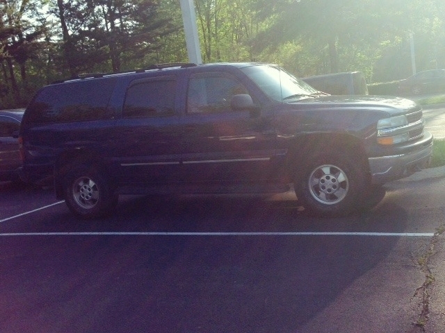

What up guys and gals, just picked up a 2000 NBS 1500 Suburban, it's 4wd and Metallic Indigo Blue. Was a family tow vehicle, has tow hitch front and rear, along with trans cooler and all that tow package stuff. Me and my dad have turned all the wrenches on it since we picked it up in 2000 with 0 miles on it, so I know exactly what I am getting and can't wait to tear it apart and build it back up.

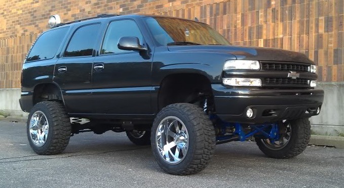

It's mainly because they are 12" wide with a -44 offset and I will be running spacers pushing them out even farther. So got to get the cabin of the truck up over the center of the tire and give it room for suspension travel...or cut the **** out of the front fender and the inner fenders against the cab and remove the washer fluid container on the driverside..... rather just lift it and have the options to go bigger later...
here is a reference of that exact lift, wheel, and tire combo

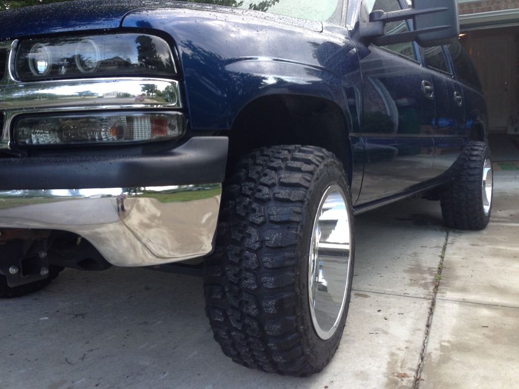

It's not that the tire is to big around they only measure 32.8. But the wheels are 20x12s w/ -44 offset. So the amount they are offest push them into the front and rear of the fender when turning.
They are on the truck now with just ford keys and Cognito arms, had to to remove lower valance and do the Norcal fender mod. Only one that rubs now is the driverside when backing up at full lock. I can live with it cause it's only a little rub and it's plastic liner to tire so I am good with that until I can get the lift.

Welcome. . If you don't run a spacer you will probably have better clearance results and not destroy wheel bearings every 4months. So far so good.

Some lock to lock clearance pictures would be nice.
Also why did you not simply 45* smooth trim the plastic lower valence like everyone else does? Will look much better reinstalled.

Just posted clearance pics in this thread, will probably put them in my build log for reference later. http://www.tahoeyukonforum.com/forum/showthread.php?t=72923
Didn't cut it b/c lifting it as soon as $$ get right and going to color match and put it back on. Entire HVAC unit went out in my house so there went the $$ I had saved for the lift. Right now I am in the process of moving my girl in so waiting till we get squared away and then going to get back to saving for the lift. Should have it by end of the year I hope.
