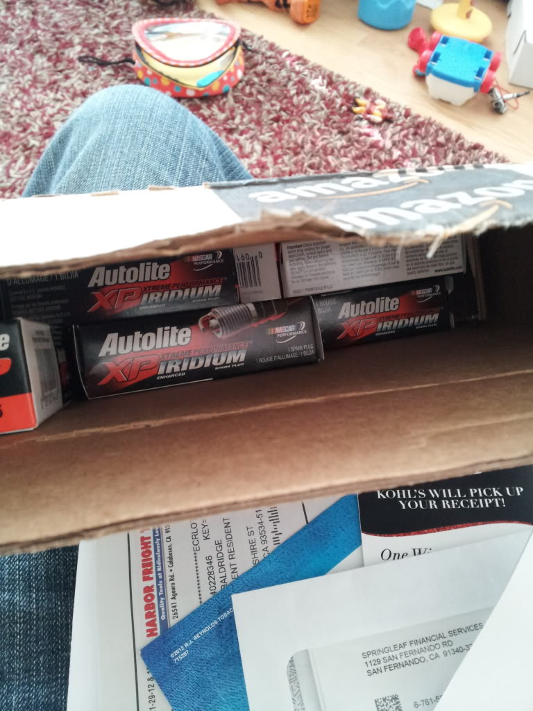

Preggapped at .060.
---------- Post added at 09:06 PM ---------- Previous post was at 09:03 PM ----------
And burn that harbor freight flyer.
imi4tth3w
Jan 14, 2010
386
60
Texas
there is absolutely nothing wrong with harbor freight? i mean if you own a shop and need tools, stay far away, but for the average weekend mechanic, they are great.
