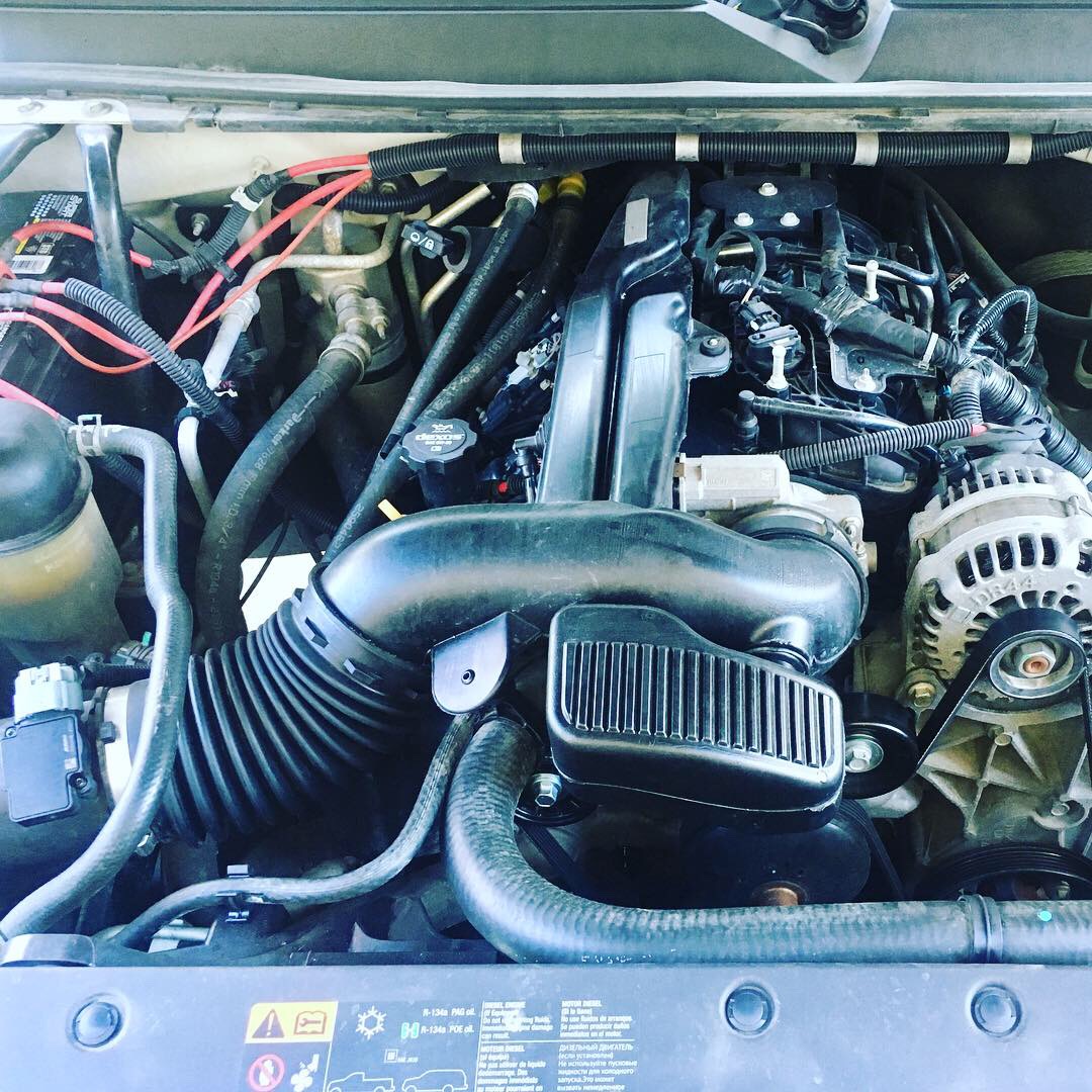

How was the fit on those? Looks like a nice upgrade when replacing the OEM hoses. Thanks.
This set was great. I cut down about two inches off of one of the heater hoses so it would sit in the mount better along side the other one. This kit also gets rid of the plastic Y-adapter. Getting the old clamps off was a pain but it was really an easy install.
I originally looked at Mishimoto and HPS before I found these from Glenn's. Both the other brands only come with the two main hoses for roughly the same price as all five hoses from Glenn's.

I ordered a set of the coolant hoses from Glen's Auto. Really nice set. The heater hose with the 'Y' for the coolant reservoir is one piece silicone, replacing the plastic parts. Also, if you go this route, order their clamps, too. They're 'full circle', in that they have unslotted strip of metal under the section with the slots for the screw, which prevents the surface from getting cut. I'll probably stick with the OEM spring clamps for the radiator end of the hoses, since the radiator is plastic, but will use these screw clamps on the heater hoses.
