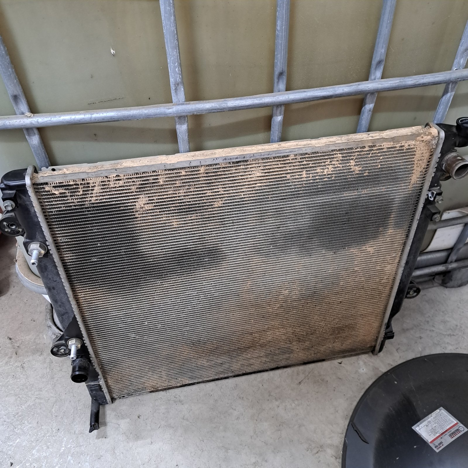

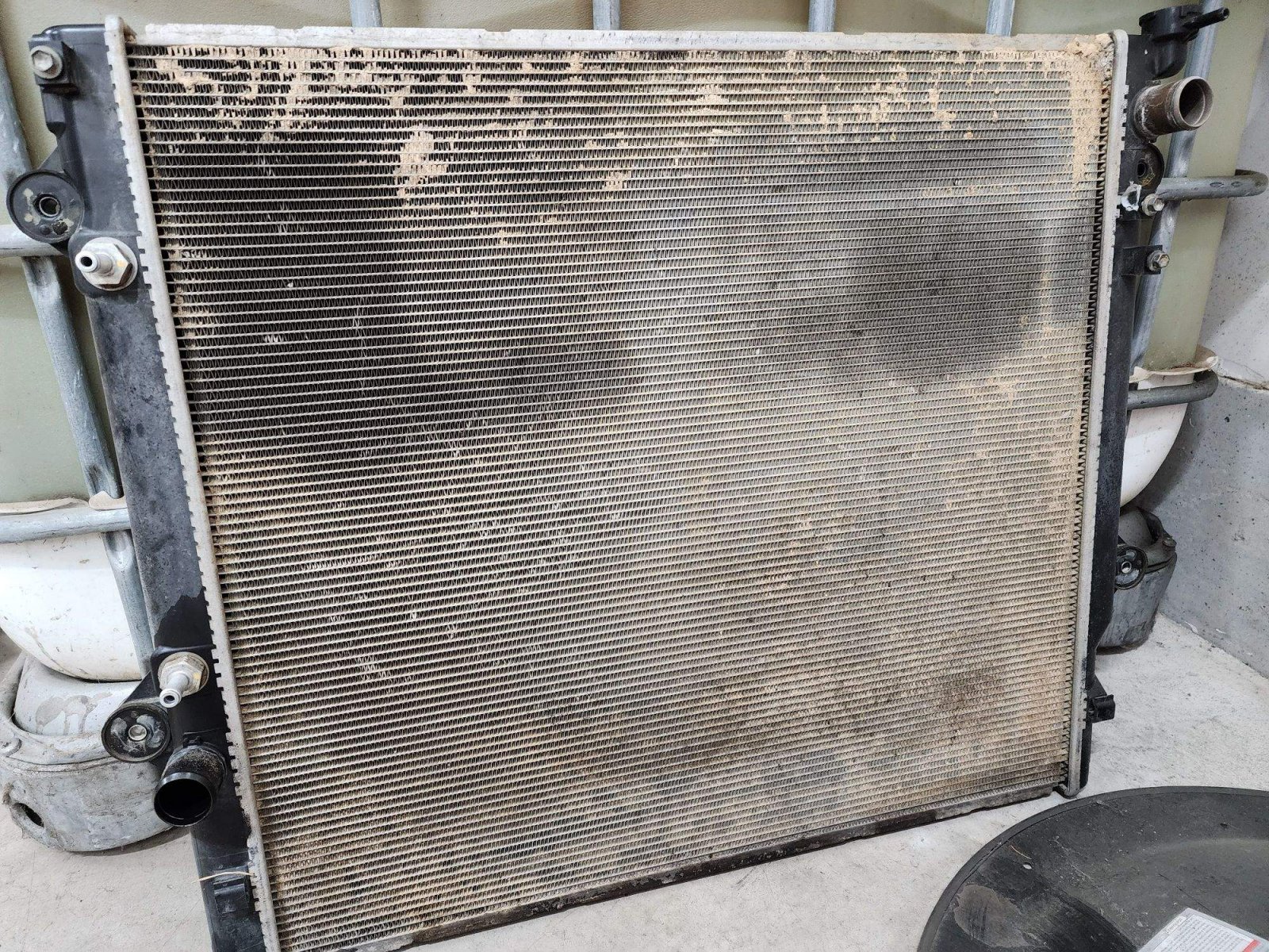

Recently did major work to an American Legion friend on mine, 2010 FJ Cruiser. Was in for a timing cover oil leak. While apart he said to replace the radiator. I personally had pressure tested the cooling system a couple weeks before all this and there was no leaks and did not over heat. That old radiator was the plastic tanks and aluminum core but was 3 times heavier than the new one we put in the FJ.
