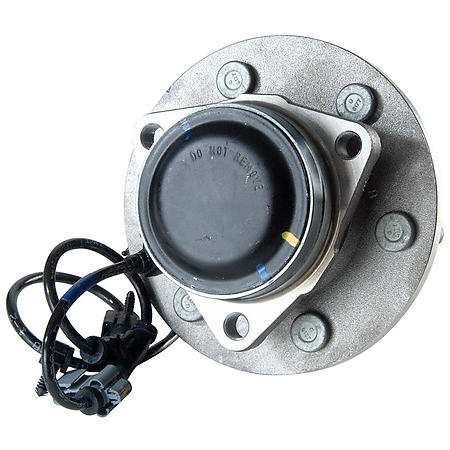

Here's the back of the hub for a 00 Silverado 2wd...

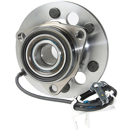

And the one for the 95 4wd...Looks Similar to me....

if you can not afford a 2wd just leave it. your idea of loosing the weight gets expensive and complicated. an modification to wiring , drivetrain and pcm is in order..besides you are only talking about the 200 pounds. the parasitic drag of a t-case is not that bad.if you drop it real low use the 4wd to help climb the driveway dips so you don't scratch the front as hard.:)

If you want a lower truck, sell the 4x4 and purchase a 2WD unit. I never understood the idea of lowering/and or removing the 4x4 components to lower it. Not a bash towards anyone, but just my .02
