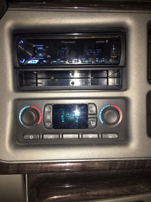

I just replaced my NAV unit for a single DIN Pioneer unit. The NAV unit works fine, but never used the navigation feature. I just wanted a little more technology the new units provide. I'll probably try to sell the old unit on eBay and see if there are any takers.
The only issue I have is the blaring message from OnStar saying "Phone Unavailable". I've tried everything to lower it and ended up temporarily pulling the info fuse, but that also disables my rear entertainment. I contacted the manf. the adapter came from and they suggested disconnecting the OnStar module, but my searches have come up empty on where to find it on my model. If anybody knows where to find it, please let me know.

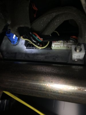

Is this it? If so, should I just disconnect then all? One wire looks like an antenna.
Thanks
Danny3737
Danny3737
Jan 3, 2016
1,382
2,046
Will do. I'm guessing one wire is from the steering wheel. Thanks for the help! I'll let you know what I find out. I need to put the INFO fuse back in first.
Danny3737
Danny3737
Jan 3, 2016
1,382
2,046
That was it. When I unplugged both harnesses the radio stopped working. I plugged one of them back in and the radio came back on, but the annoying OnStar phone unavailable message went away. I really appreciate the help!
