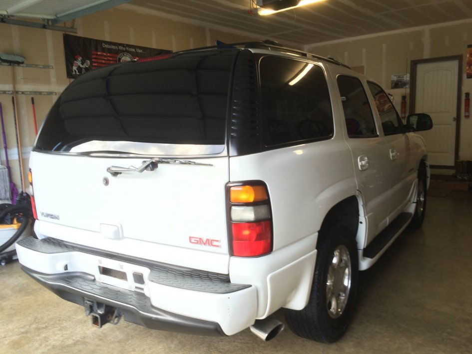

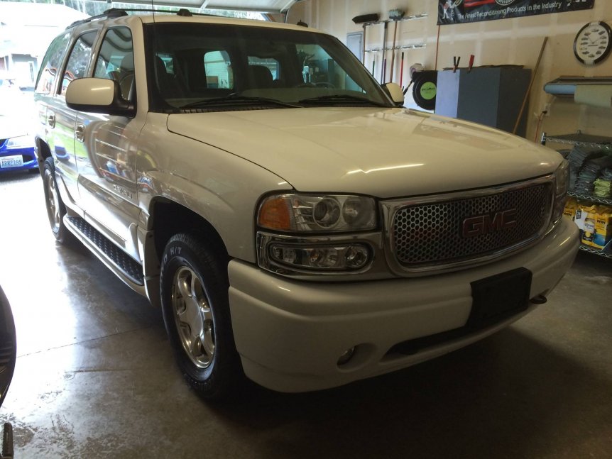

Well guys here is the pics. I will get the before pictures up in a little bit. It was definitely a diamond in the rough I think lol

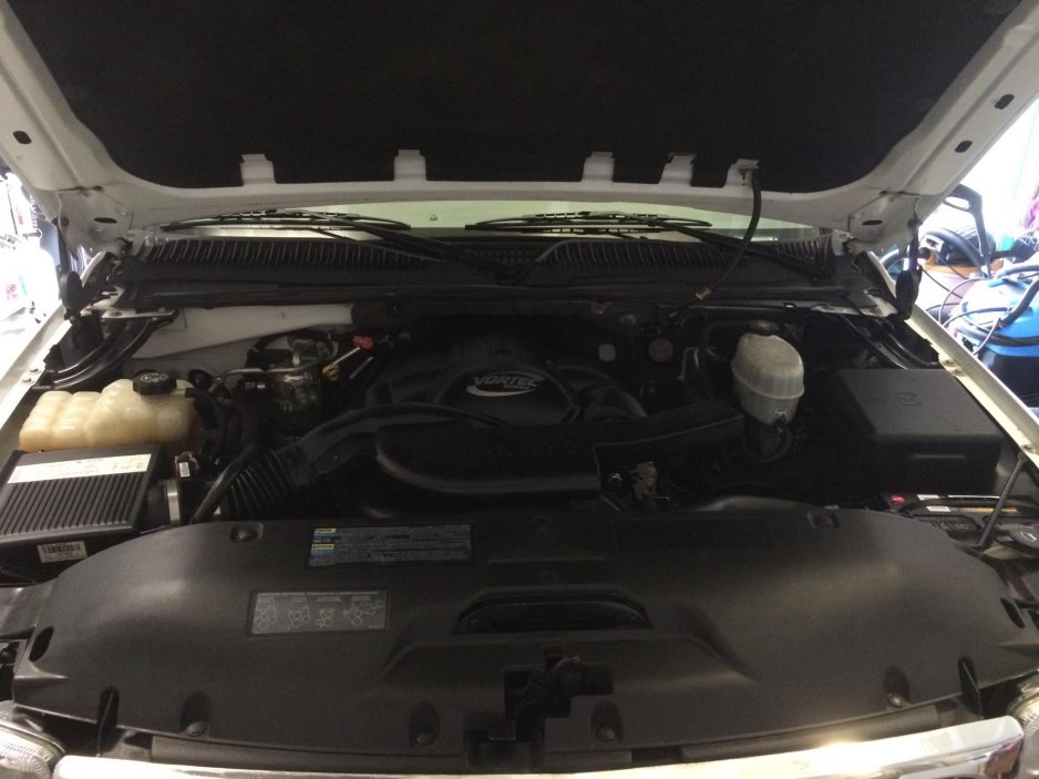

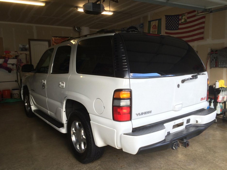

I think it would look good with a nice gm performance intake and corsa exhaust! :rocking:
