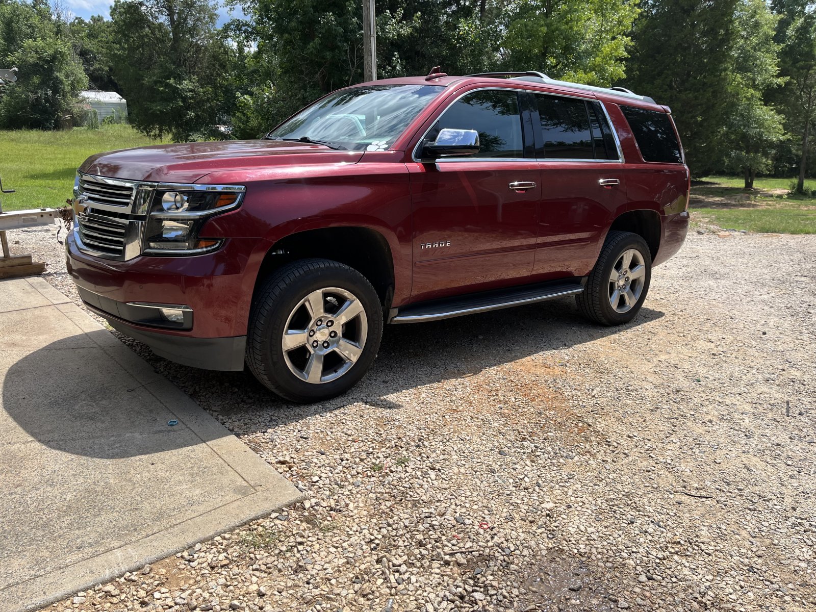

2017 Tahoe intermediate no start no crank. Pops up on display service steering column lock. All gauges and acc. Come on and cycle but no start. New battery, new starter, all fuses have been checked and cleaned. All grounds have been removed cleaned and remounted. Not sure what else to do. Any help will be appreciated.

Pics of the truck, please.
