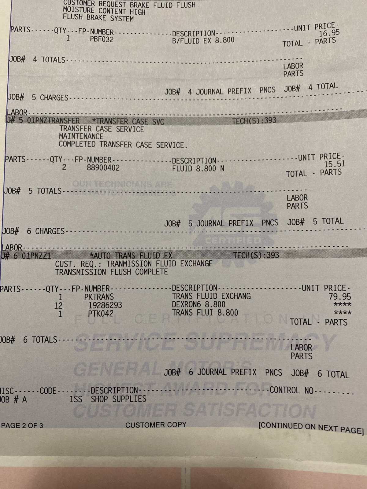

so digging in, dealer did a transfer case service, looks like flush and replace at 119k miles. In 2016.

Wild guess without looking but I think the transfer case service mileage interval is 50k miles. 186k miles now and 119k miles then=67k miles since serviced. If I am right on the mileage interval, is past due for servicing. But again, I am guessing without looking. Check your owner's manual.
I also tend to change fluids at a lesser mileage interval than the manual recommendations.

So it's the 4x4 2-speed transfer case, not the AWD, since they put AutoTrakII fluid in it for the transfer case service.
