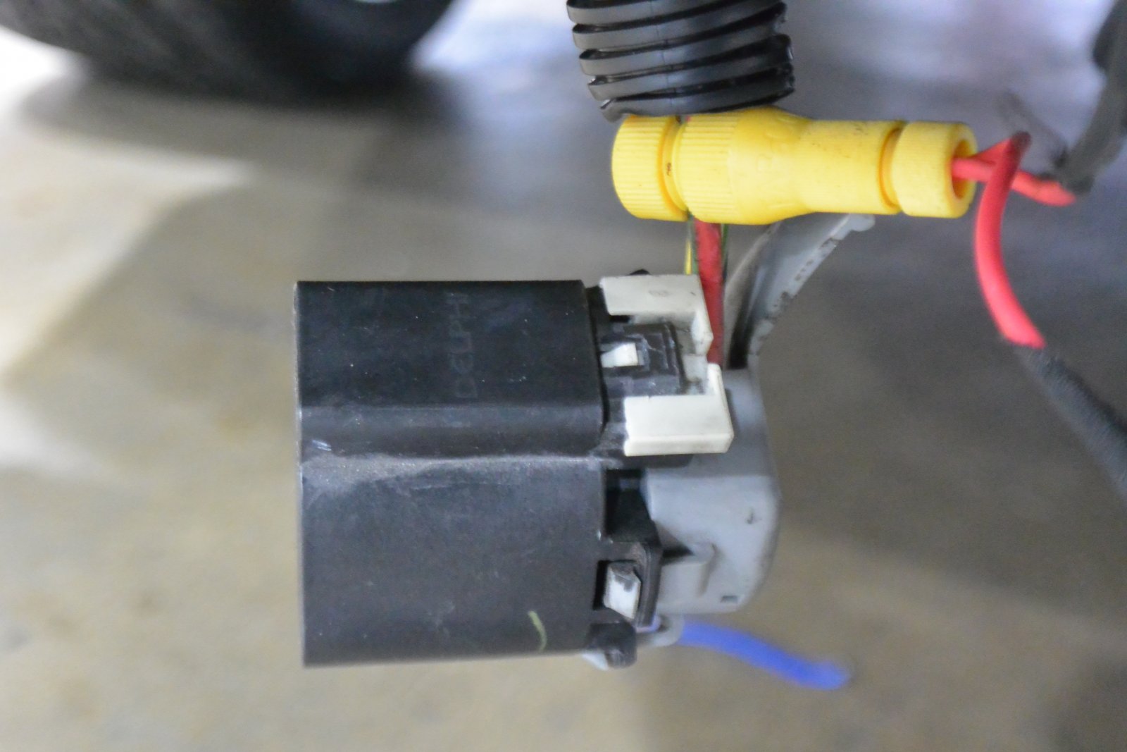

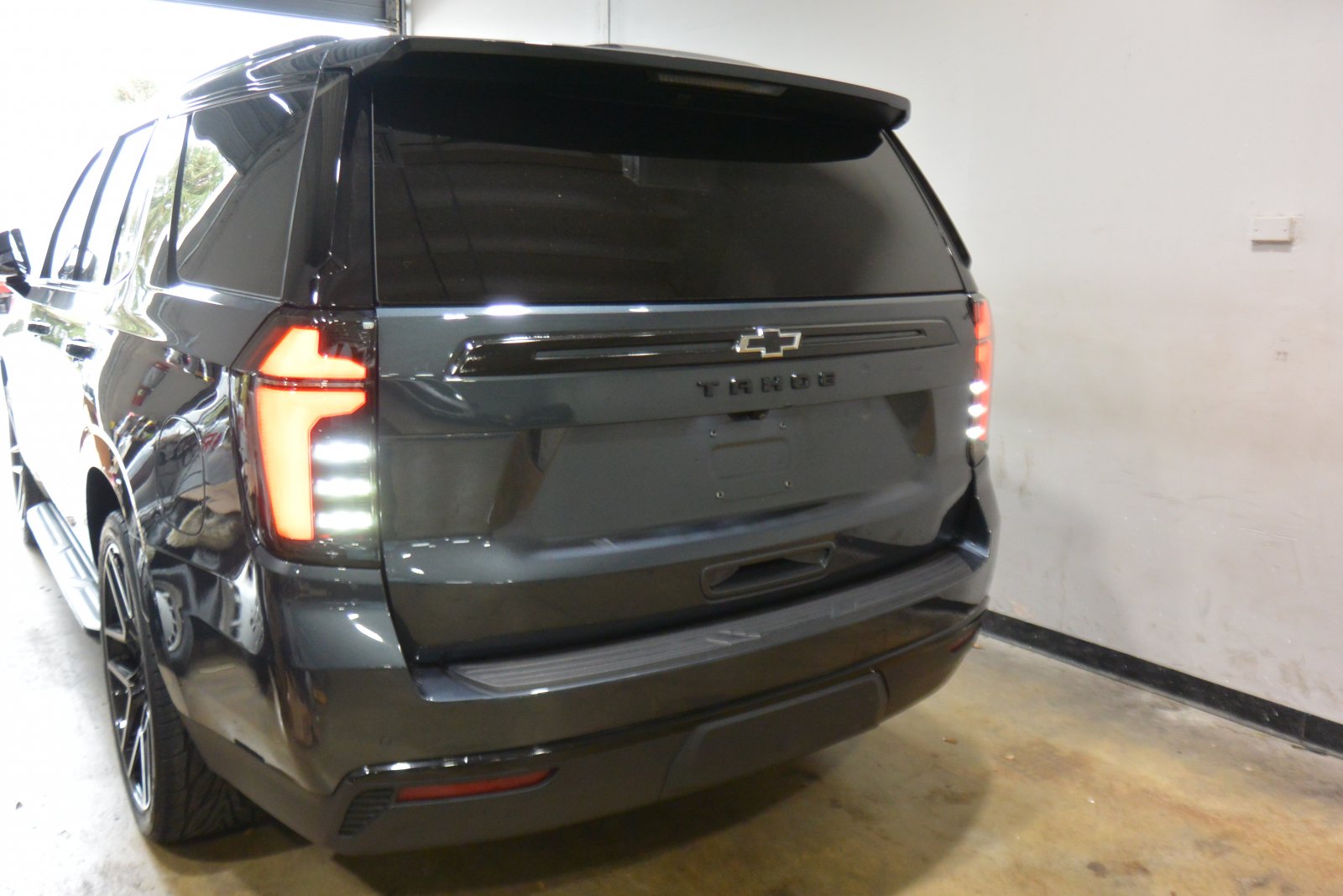

When I removed the 2021 Tail light and compared it, the plugs were surely different. I went under the vehicle hoping that further below the harness would plug, but still no. I will try to post pictures in the upcoming days.

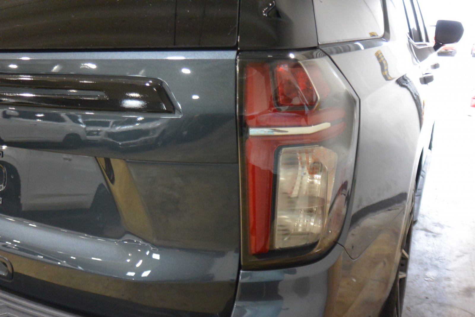

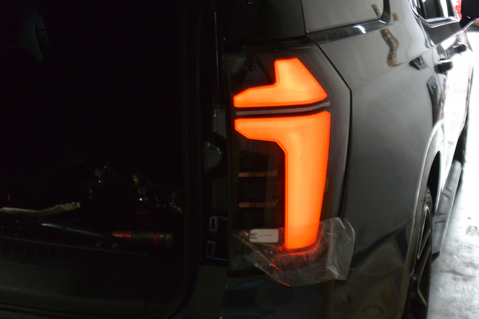

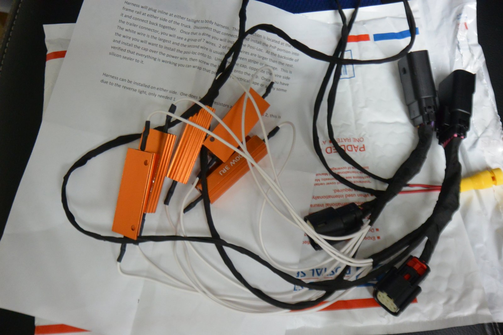

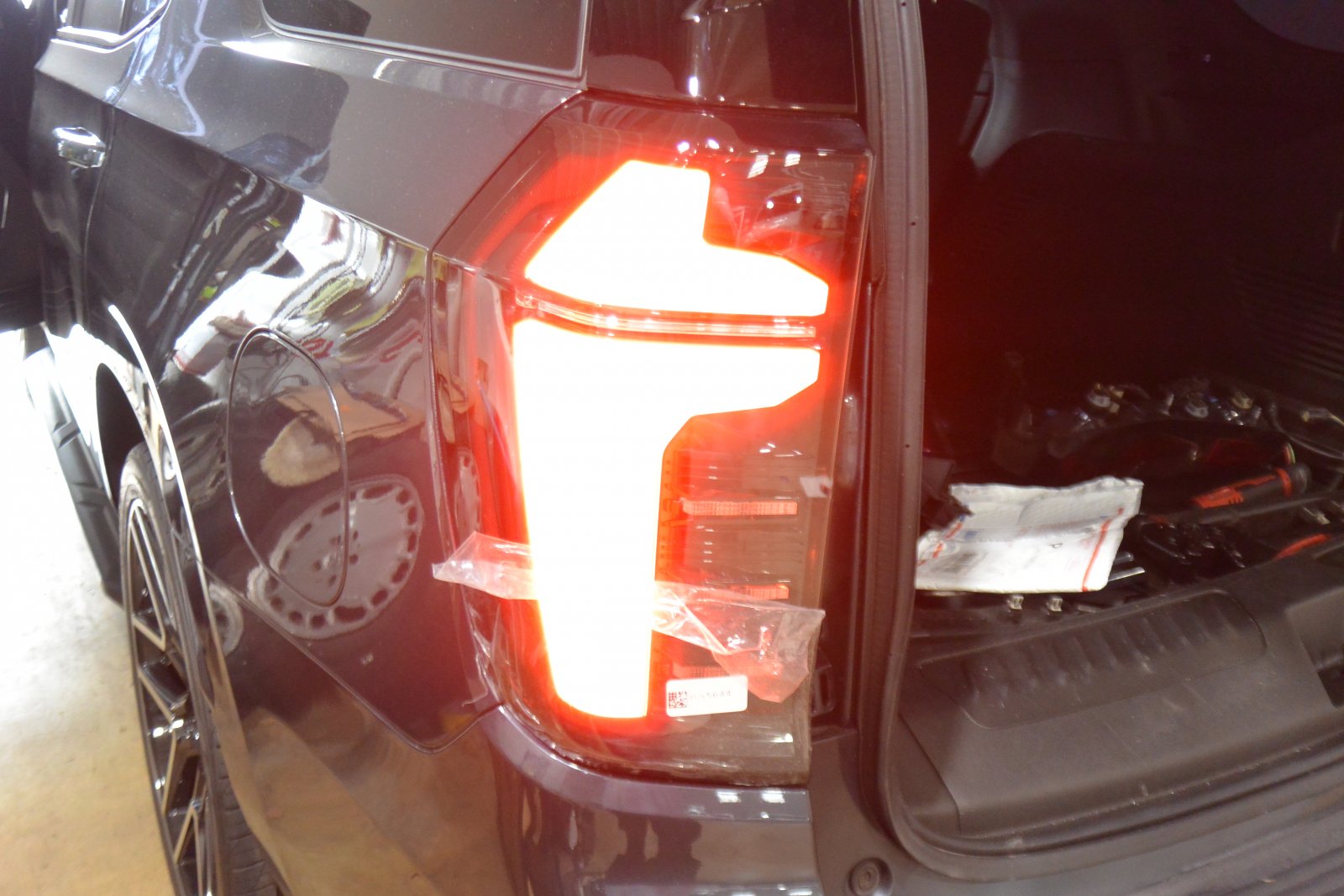

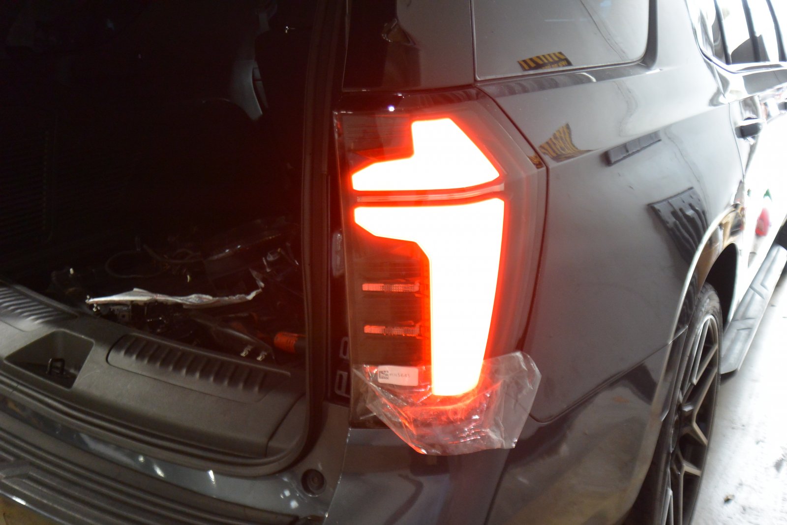

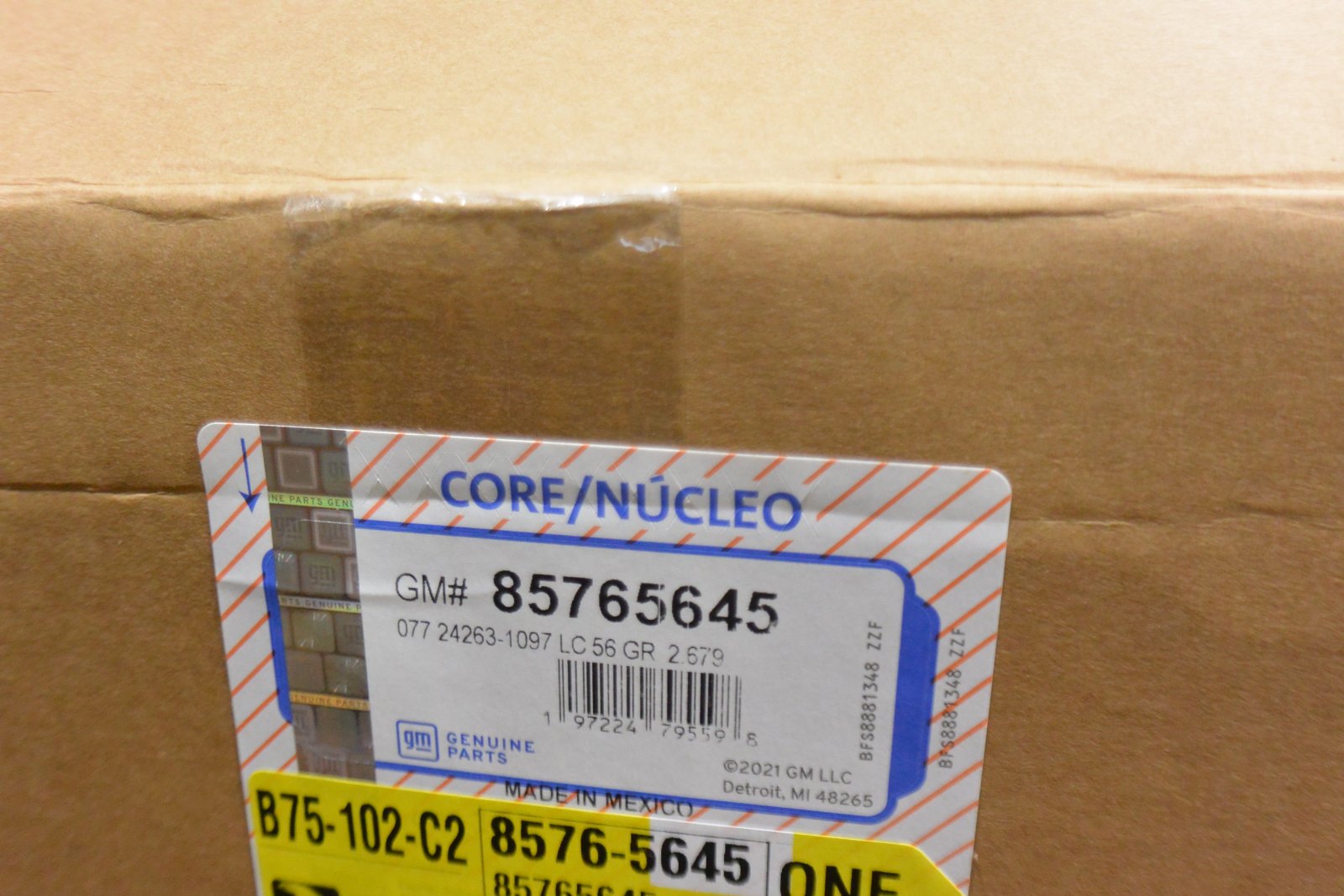

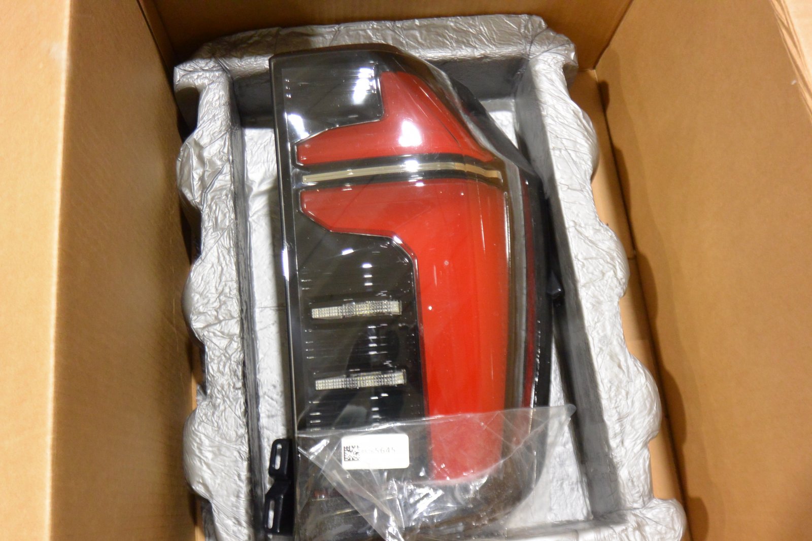

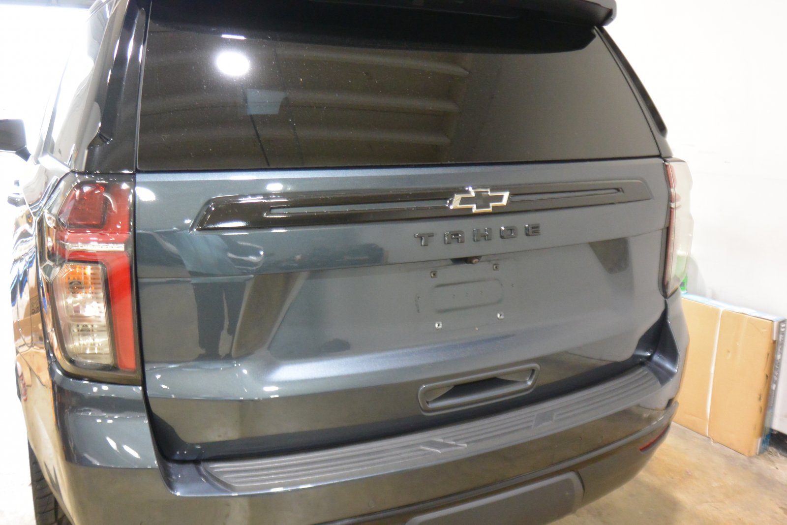

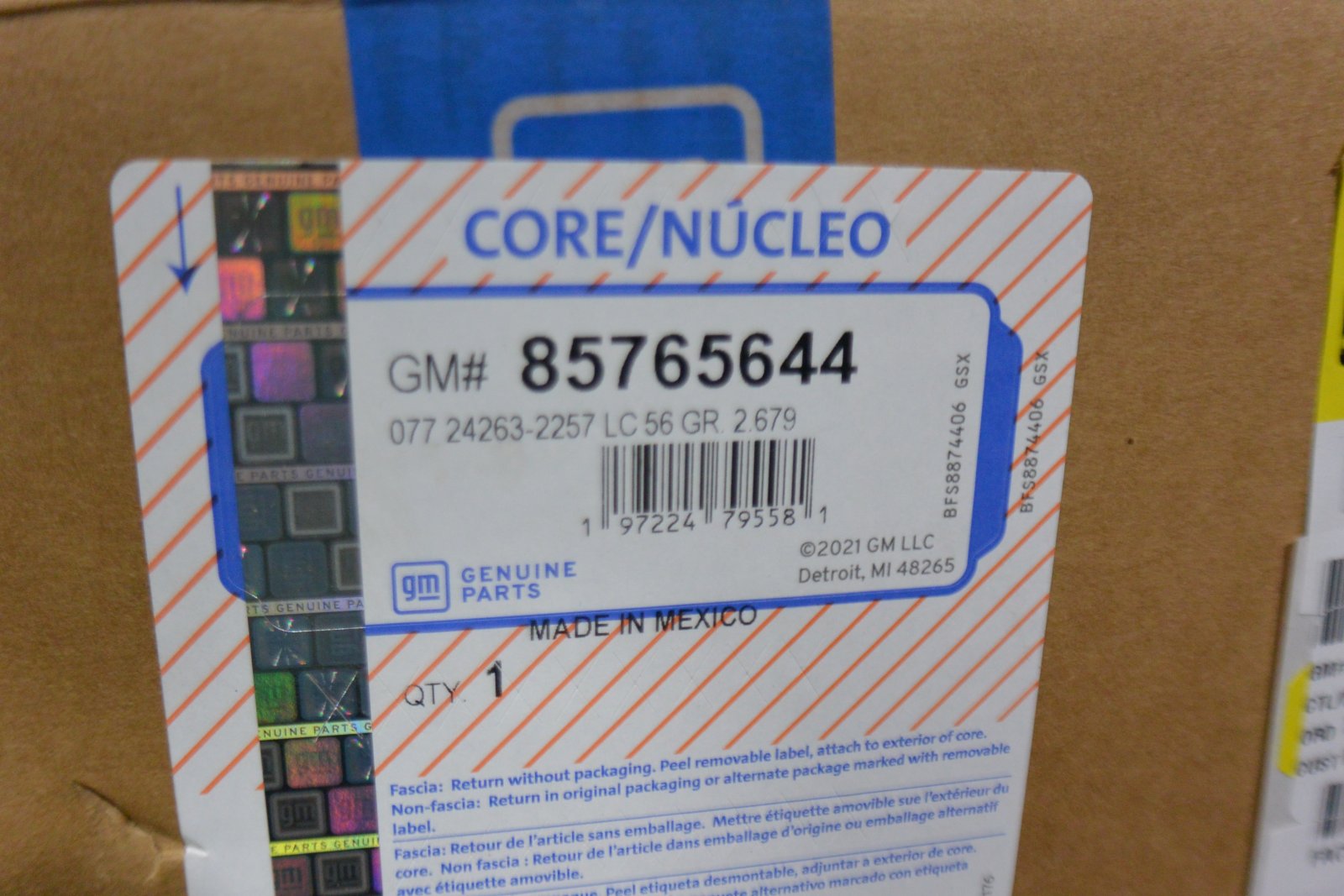

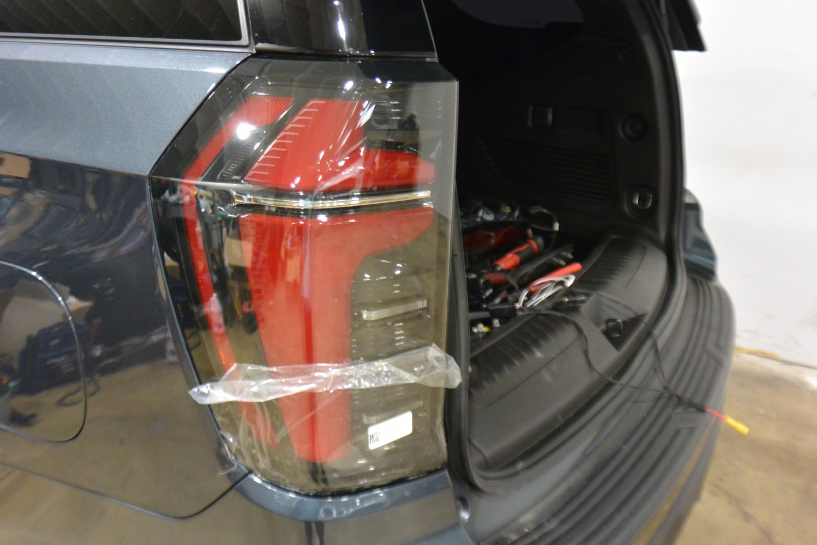

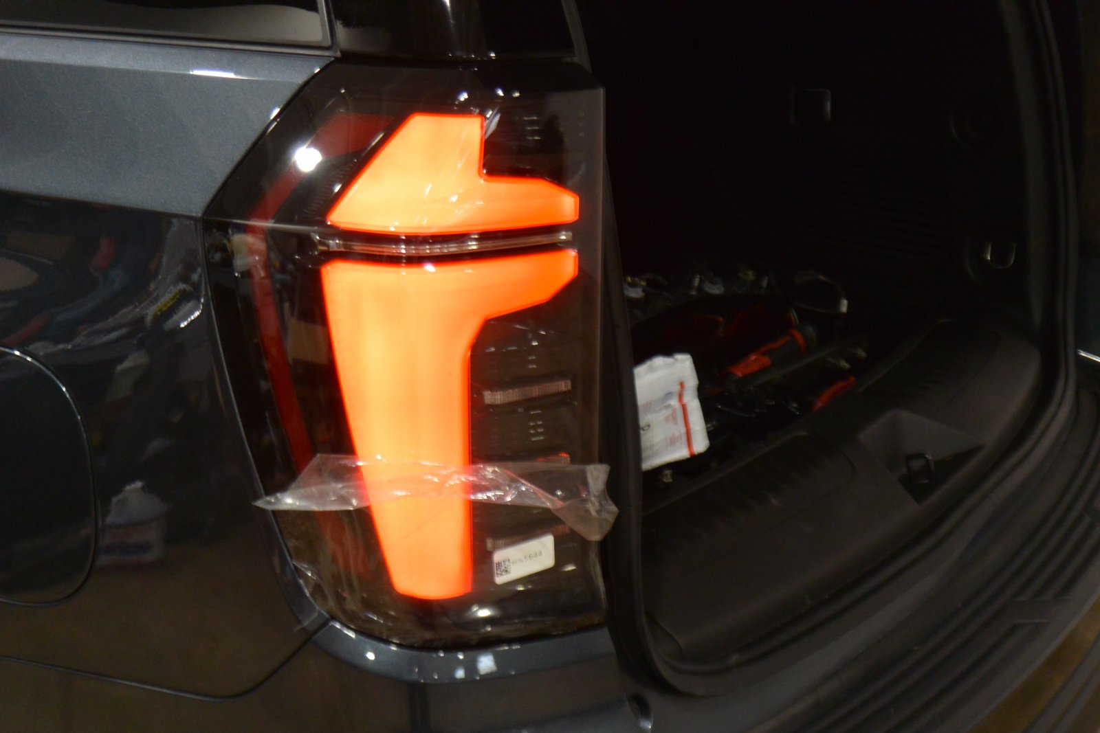

Update:
Not to be discouraged, I contacted Gen5diy in regards to a harness to convert the 2021 wiring to 2025. Luckily, they were able to knock it out fast!
So now, I can confirm that the 2025 Base model Tail lights will work in the 2021. I'm not sure about the Uplevel 2025 tail lights, but these base models
work perfectly. I will add photos now.

Photos:

More

I went on chevrolet's website and got the vin from a 2025 LS. I then called my local dealer and ordered the tail lights using the vin.

Do you happen to have the link for the conversion harness?
There no link for the harness. I contacted them directly and had it custom made. This is most likely the first 21 to 25 tail light conversion.
