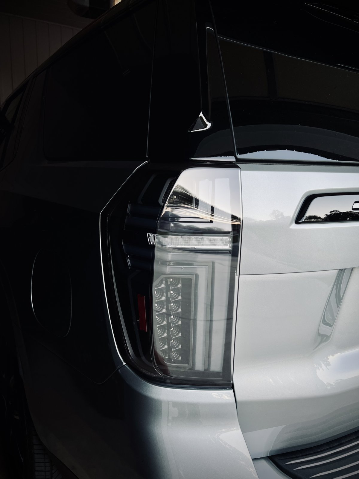

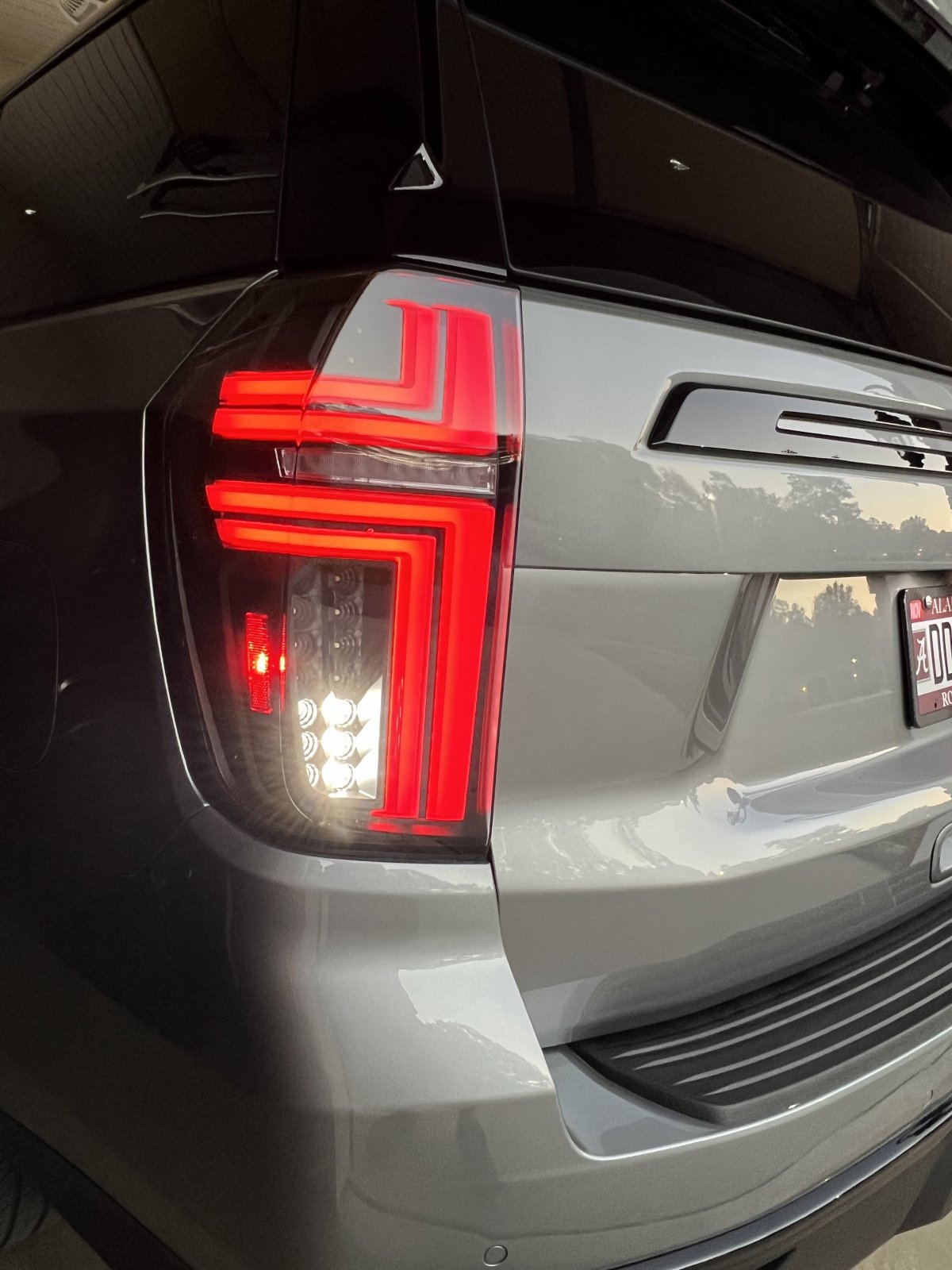

I put these Anzo LED tail lights on my 24 and they kinda resemble the lights

Yes especially since the factory Tahoe lights have none LED backup lights.
