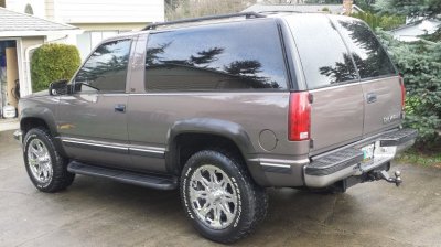

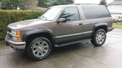

Hello guys and hoping you can help a new guy out. I bought a 98 2 door and neither of the power seats work. The bolster works on driver side but none of the seat adjustments work and neither of the heated seats work either. Any clues?
Also looking to add the Q logic barn door boxes. Does anyone have them or know how they sound? Here is my 2 door. I just put the wheels and tires on
