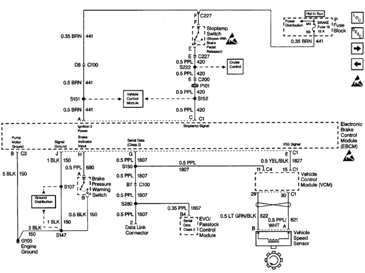

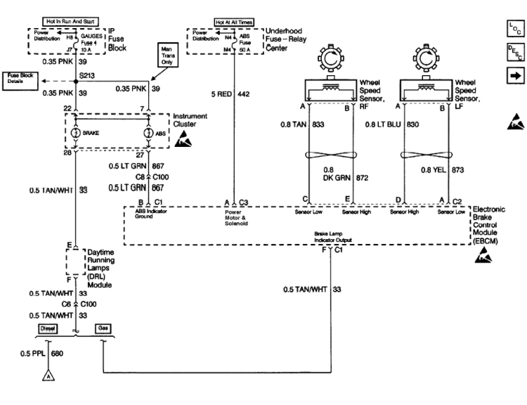

It’ll be referred to as the EBCM (electronic brake control module). Here’s one for a 98. The only thing that may mean something is its connection to the EVO/Passlock module.
The above is from alldatadiy which copied it straight from the GM manual. You can download PDFs of the 98 manual volumes here:
