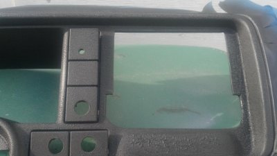

today i went to the junk yrd to get the dash bezel to cut up AND there is a
99 escalade with the floor console of coarse it's not grey
interior it needs to be cleaned and painted anyway there
was 30 min before closing i took the top panel off and
found a $5.00 bill that paid for the bezel. I will go back
in the morning with the right tools to get it $10.00 for it
and $5.00 more if i leave the bose sub in it. i wonder if i
can use it or change the speaker in it?

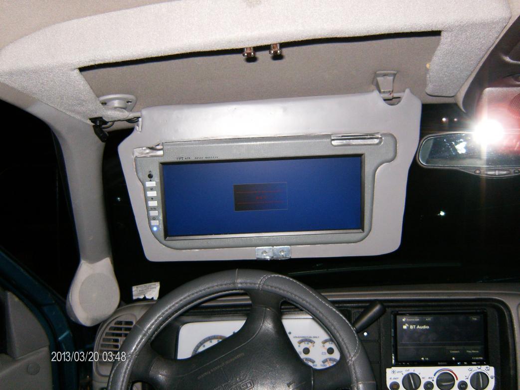

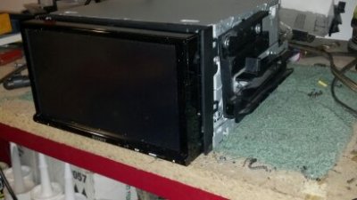

some pics on www.photobucket.com/qlcp And slipping my sony will
be here sat i will play with it on my work bench until i'm ready to cut the dash
and i bought a dummy 2 din face plate that fits over it.

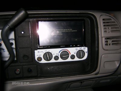

thank fellas i still need to play with the settings and read the manual
while on the thrown the dvd pic is great. with factory tabs mounted
on it if something to it i can slide it out and put the old HU back in.
i made a template after i finished the dash bezel to i will upload
to photobuc and the esky floor console

This is sweet and looks awesome. Im jealous of the esky console, I've been looking for one for almost a year now with no luck. Did you have to reinforce the dash to support the extra weight of the double din?
qukon 95
qukon 95
Apr 7, 2011
556
no not at all i used the factory mounting location and i cut
the slide brackets off my fac cd player and mounted them on the 2 din. more pics
