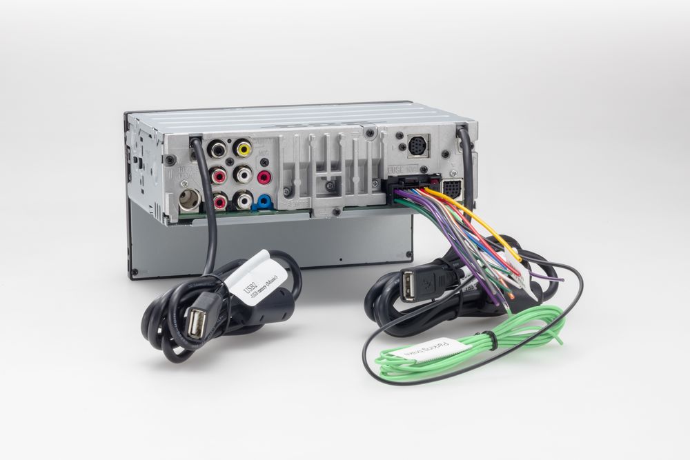

I recently installed a Sony AVX-AX550 in to my '05 with BOSE. I used the PAC RP5-GM11 adapter module, installation went really well and everything works including the steering wheel controls. Yesterday while I was cleaning the carpet I wanted to see if the RSE worked. I grabbed a DVD and powered it up. The monitor and DVD player work great. There is video but now audio. I followed the instructions from PAC and plugged the RCA cables in to the stereo. When plugged in to the 'REAR' ports on the HU I don't get any audio from the RSE through the speakers or the headphone jacks in the back of the center console. Am I missing something? Any help is appreciated!

‘Rear’ rca jacks on a headunit are the rear OUTPUTS. You need an input. It might just be the headphone jack in, can’t tell from your picture. Then select the input.

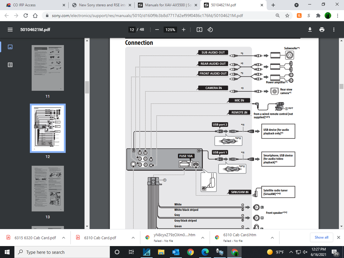

Other than a single MIC in (red port, 3rd row, 2nd up), there is no audio in. Not sure how that is going to work for you.

There may be an adapter to the moles plug. Years ago the CD changer plug could be used with an adapter to rca…
