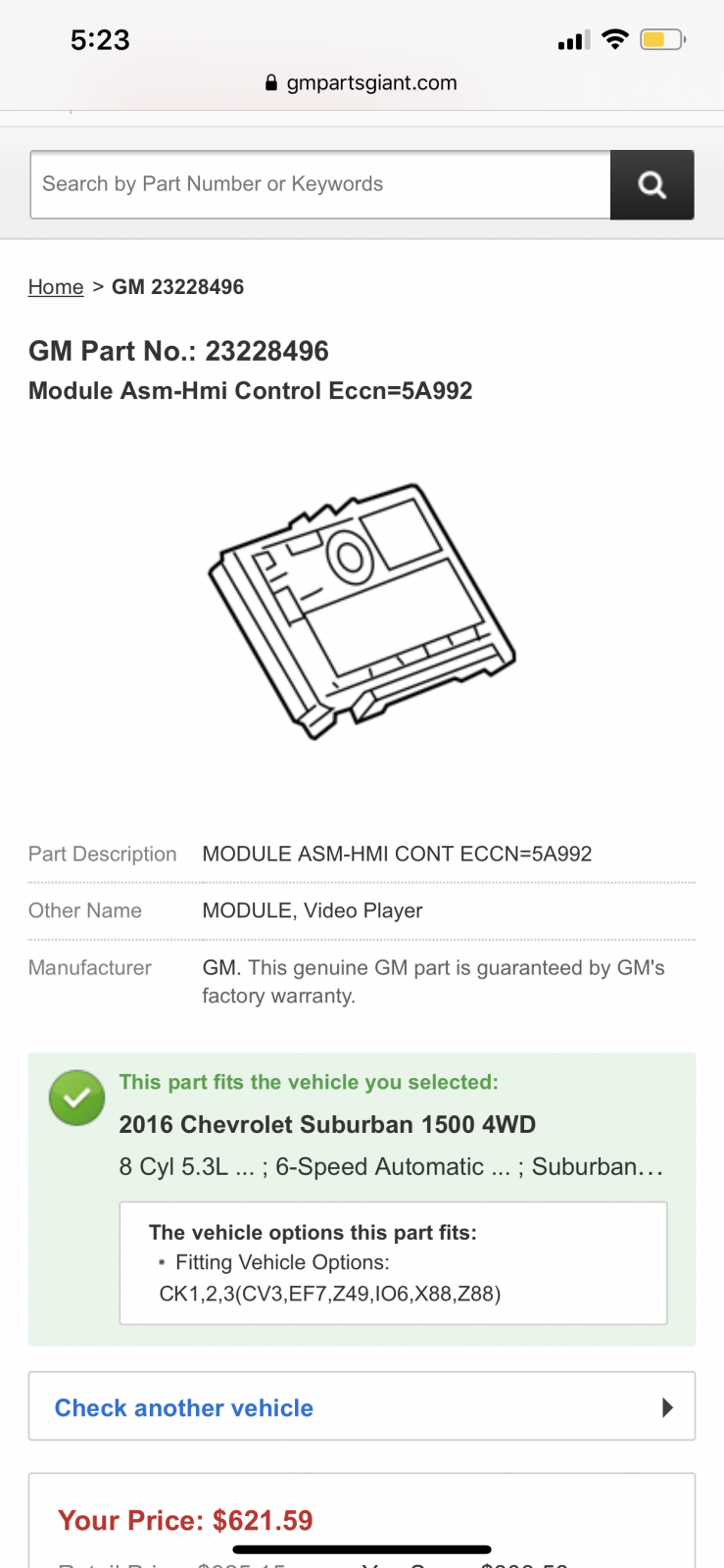

Hello, screen dead and took to Chevy and the HMI module is toast
They want $1200 to fix which is a bit much.
Is the pic attached the correct part?
There seems to be a ton of different “modules” and controllers on the GM parts sight. looking for the one that will go behind glove box.
I was told to try eBay but given there seem to be so many issues with these HMI modules getting a used one doesn’t seem like a good idea.
Would love a new one at a better price but $600+ is better than 1200

Be careful with the ebay one and you still have to go to the dealer to have it programmed. We sell about 10 a year at the dealership I work at.
