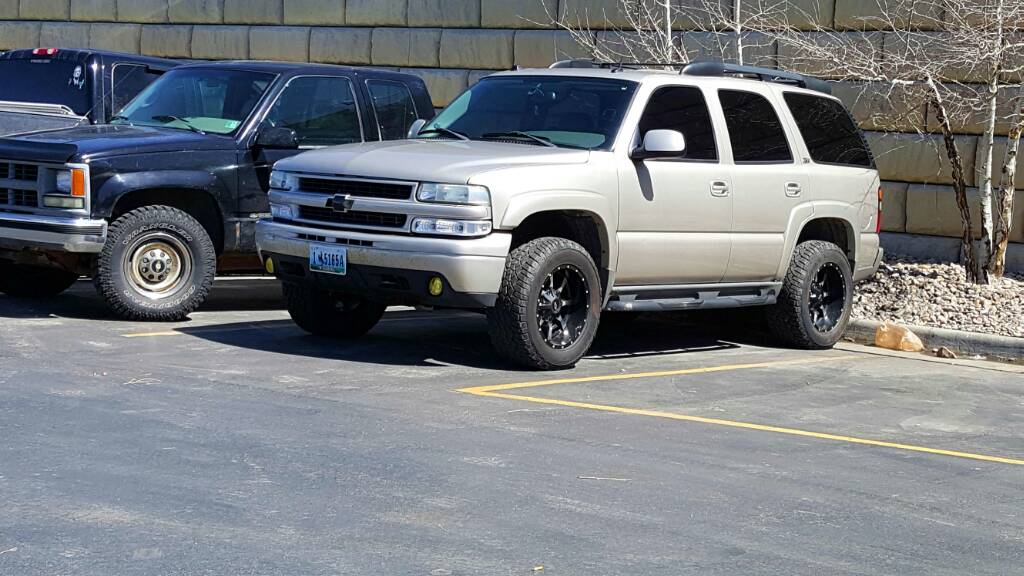

To be honest most lift keys are the same thing. I have some eBay keys in mine, currently still running stock shocks and extenders. Lifted to level with rear on my z71. Left me about a 1/4" between the upper control arm droop stops and the arms. Sits at 37" on all except the left rear which is 1/2" lower on a 31" tall tire.
The keys I ordered.
