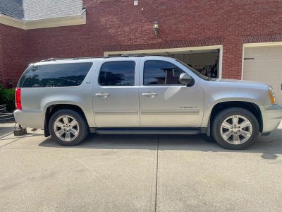

Here's a pictures of my Yukon with out the trailer hooked up
Not sure what was in it originally but it now has 2" drop coils springs with KYB Gas-A-Just monotube shock absorber on the rear and KYB Gas-A-Just monotube struts and shocks on the front.
These are the springs on it now: http://mcgaughys.com/products/rear-leveling-kit-30014

It's a soft ride like this. Only lowered the back so it sits level.
