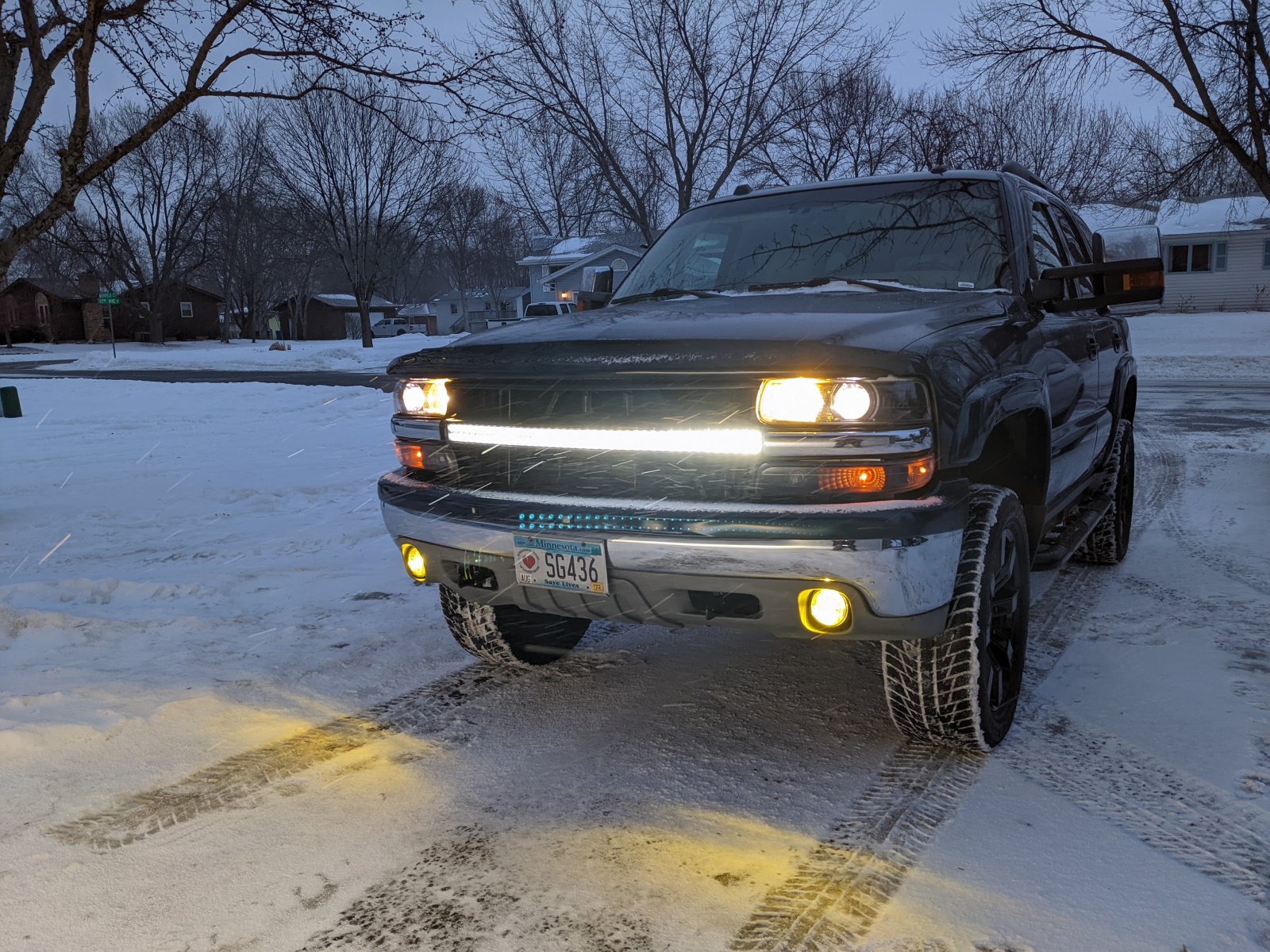

Been through Many combinations trying to find the best functional setup.
So far I'm sticking with 55w HID in Depot projectors and waterproof relay harness.
Having a tough time getting a good slim set of LED's to fit round Z71 fogs and still aim correct. 55w HID in the fogs kill it but make sure your housings and harness' are waterproof.
So your running 55 watt hid bulbs in the depot headlights and they dont melt the housing?

Any photo of that setup? 5000k is easier on the eyes I think than anything higher. Went with 4300k on a few of the trucks and ATVs now but pumping em with 55w. All fogs and hi-beam 3000k. Stuck with non-replacing triple projector LED morimotos in the big Yukon and I think those those are 5500k.. maybe 6k.. light output with exception of the hi beam is better than stock HID though
