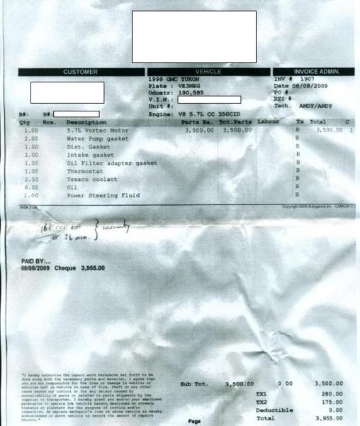

A few months ago, I just bought a new GM crate motor. Cyl's 3&4 valve giudes were done, and I was loosing oil at 1ltr per week, and fouling plugs at the rate of one plug a week per cyl. Blew a distributor ring gear, cyl's 3,4,& 6 only had 90psi, etc. I could have rebuilt the heads, but decided I was going to keep the truck and bought a new crate motor.
Although it's a lot cheaper to buy a rebuilt short block motor, if you plan on keeping the truck for awhile it may be worth it to buy the 0kms GMC crate motor for the peace of mind. It comes with a factory 3yr 160000kms warranty too!
A long block, I think they called it, new timing stuff, cam, everything but intake and distributor stuff. IDK, I kept the old motor, it's in my shed in the new motors crate. I'm thinking V8 snowblower???
I paid $3500CAD+taxes installed. Came out to just shy of $4k.
