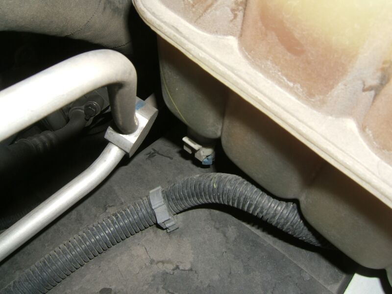

Ok so my check engine light came on today :emotions122:. Disconnected battery and engine light is off now but idles kinda ruff. if i rev the engine the rpm's drop low and will sometimes shut off. any ideas?
Oh and I have a low coolant light that comes on but reservoir is full.
There are 2 plugs unpluged in engine bay one is by the ac canister and one by the reservoir or by intake. Can some one get pics of there engine bay so i can see what im missing. like does the reservoir have a sensor or intake.

HOpefully these pics are what you need. Notice the plug that goes into the a/c "canister", and the plug that goes into the bottom rear (towards the firewall) towards the driver side of the coolant reservoir.
I had similar symptoms over the years. ONce, it was clogged fuel injectors. Another time was a intake manifold leak ($600 piece of plastic). Both gave rough idle and CEL. Didn't have a code reader at that time so was at the mercy of the dealer. Good luck

That's just what i needed, my reservoir is broken and doesn't have the low coolant sensor. thanks
