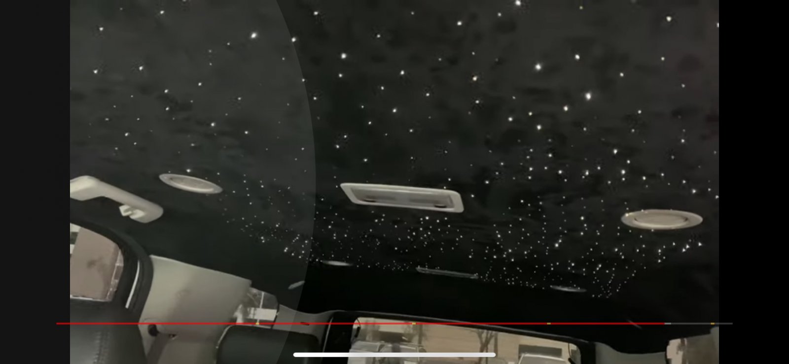

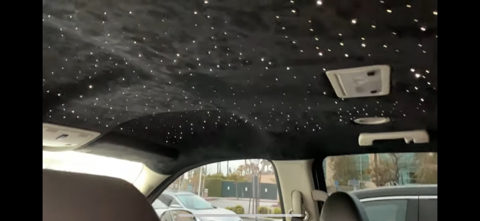

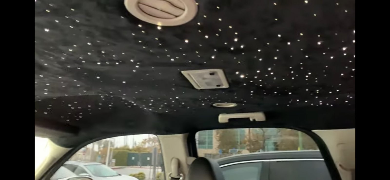

hey yall I'm preparing to do a crazy starlight roof project for my 2007 Yukon xl over 1800 fiber optic lights are going to go into it. But the hardest part is going to be taking out the headliner. So has anyone done this before? I've been looking into this on youtube and I've found zero videos on 2007 Yukon the only before or after models. So if anyone else has taken theres out or have a video please send the link or explain it, it would be so helpful! I will be sure to send pictures of the final product! any tips are welcome!
there are some pics below of what it's going to look like, the headliner in the picture is black,
mine is tan.
